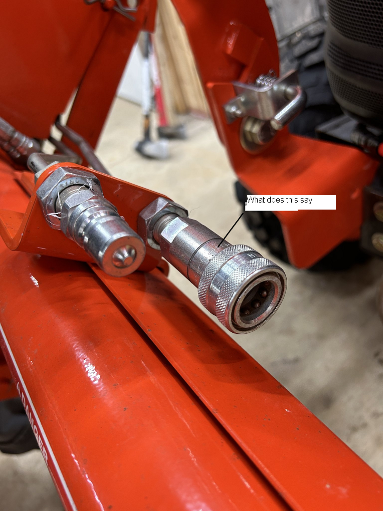

I'm building an implement that will use my Kubota 3rd-function. These are the 3rd-function ends:
I cannot decipher the markings on them to correlate with connectors to buy.
Is this the correct set to match them?
Thanks in advance.
