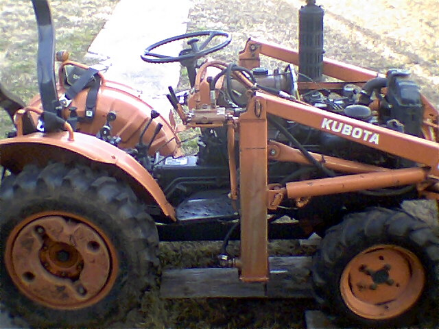

Thanks guys, the "blah's" got scurried away after I simply walked away and let my thought collect to myself. It dawned on me that there were three problems that was on my mind regarding to the FEL which could be solved with one fell swoop! (Or so I think)
Problem #1 - Bucket's in bad shape and is 39" wide
Problem #2 - The original cylinders aren't standard (gah!)
Problem #3 - The bucket as it sits doesn't roll up enough to hold material at ground level.
My thinking on the solution. When I get a new bucket with loose brackets (48" wide if they won't make a 46") combined with new 12" stroke cylinders, I'd set the bucket at the desired curl-up position at ground level and set the brackets on the bucket and modify the base end brackets to accommodate the longer cylinders! Of course, I'd have to verify that the bucket tip will be adequate at 6 ft high. I'm not looking to load them in dump trucks, just to move dirt & snow around.
The cylinders for the arms are 17" strokes and I'm wondering if anyone has shortened it to 16" strokes because what's available are 16's and 18's, no 17's (Only if the cost of overhauling the cylinders exceed new ones)
What do you think fellas?

Regarding the bigger bucket, just want to give you something to think about. Not trying to through a damper on your idea.
Kubota sized the original bucket to match what the tractor is capable of doing. While the bigger bucket is definitely appealing, remember that the tractor has to have enough power and frame strength to dig with it. Also, the steering box needs to be stronger, and the loader parts also need to be stronger. If memory serves, the 219 loader is designed to lift 400 lbs max I think.
If you're only going to be lifting snow, the bigger bucket will be fine. However, I'm not sure how it will do when digging, because it might be too much for the size of the tractor.
