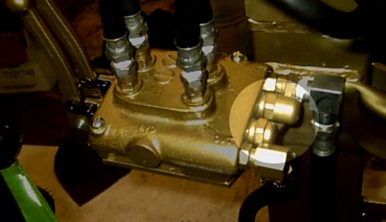

If you look at the controller, the top right cluster of hoses goes to the cylinders in the right places. Other than those, there's three hoses going to the controller. The very bottom is connected to the pump output directly. The other two is what puzzles me,... they run to this "cluster fitting" which I think was done incorrectly... I'll do my best to explain
I drew an illustration of the current setup. Please do note the tractor's hydralics which looks to be at one point was hooked up to the FEL and was later revised to use the external pump, thus the loop closing it back up.
Something tells me that the two outputs from the controller should be joined together and flow back into that "capped" tube on the reservoir and the low pressure hose be connected only between the lower reservoir and the pump?
The "loop" (far right) closing back up the tractor's hydralics...

From your diagram it looks like the hydraulics return lines go directly back to the pump and do not dump into the reservoir. It would work (I think) but seems like it would overwork a small amount of fluid and never get filtered. It would only take up any lost fluid from the reservoir. The two lines that go from the valve to the pump "cluster fitting" should go back to the reservoir and the pump would then pull all its fluid from the reservoir. Not sure how you would get two returns to the reservoir and you would need to plug the two points on the "cluster fitting.

On the hydraulics, I think Russell King's assessment is pretty close. I would suspect that where your hand drawn diagram shows the two lines both connected to the low pressure line, one of those lines may be a "power beyond" port (to power a grapple or other device) usually marked "byd", that should be capped. The other line ( hopefully marked "out") should be the return to the tank, and the suction line should have no other connections. If those two ports on the control valve are not marked, maybe the valve manufacturer can help.
Sounds like someone bought the wrong valve for this application, or maybe used what they had on hand.
The B219 was never intended to run off the internal pump- the front mounted external pump was the intended way, although yours may or may not be the original Cessna pump.

The reservoir, the way you Fel is plumbed looks no more than a buffer for leaks/ heat expansion so unless overfilled , pipes mixed up/not capped, as Lil Foot says, on the valve I can see no reason for any blow out at the breather or the need for another return to the tank unless there is some form of filtration employed in it.
