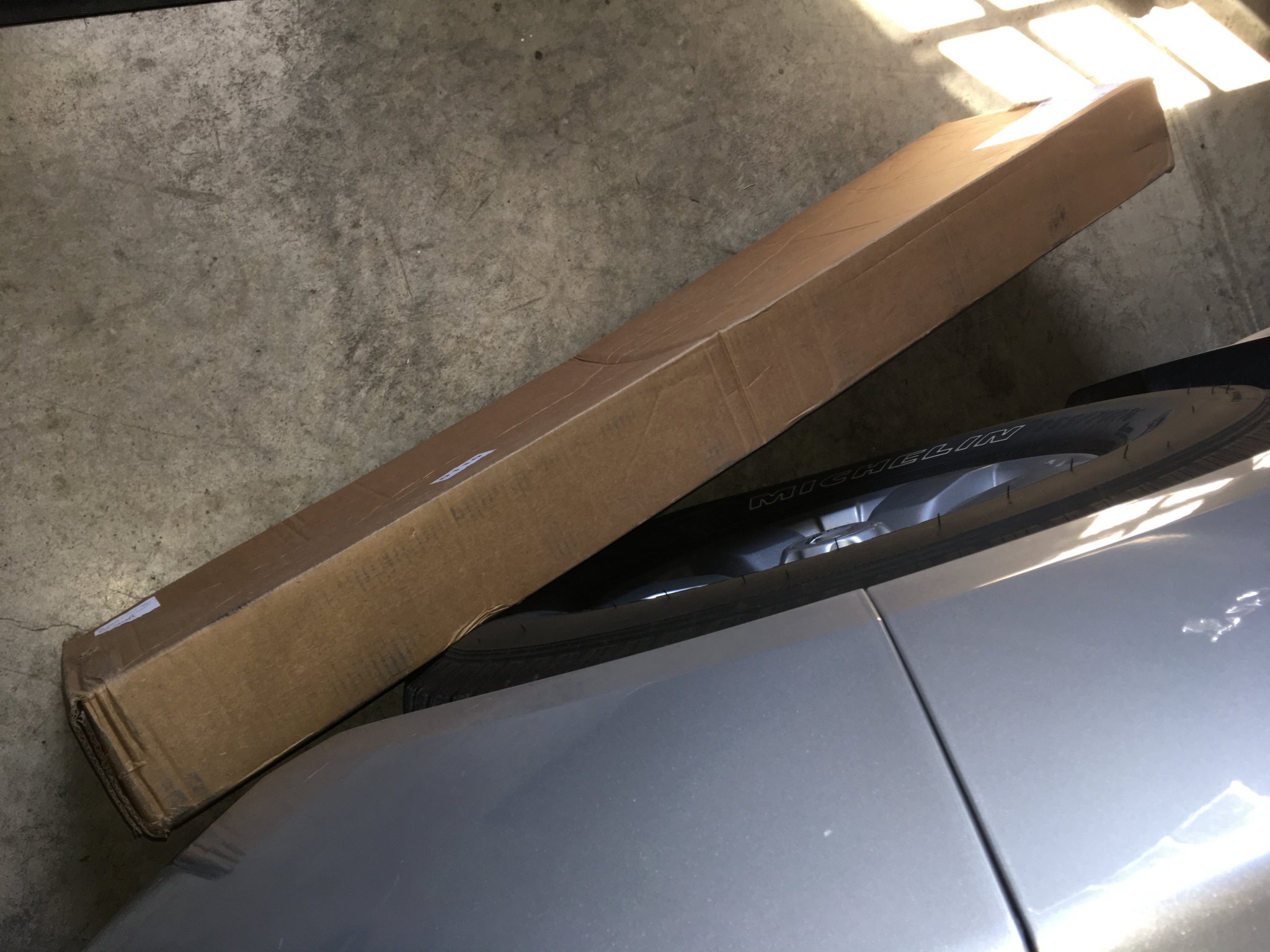

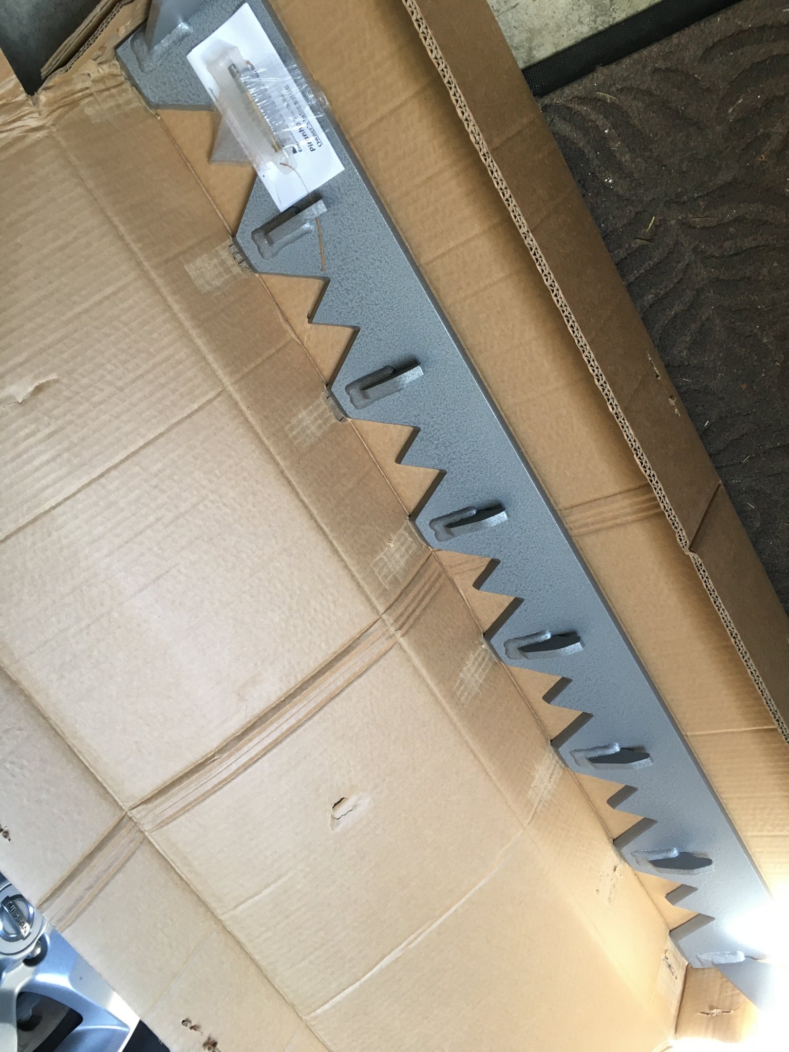

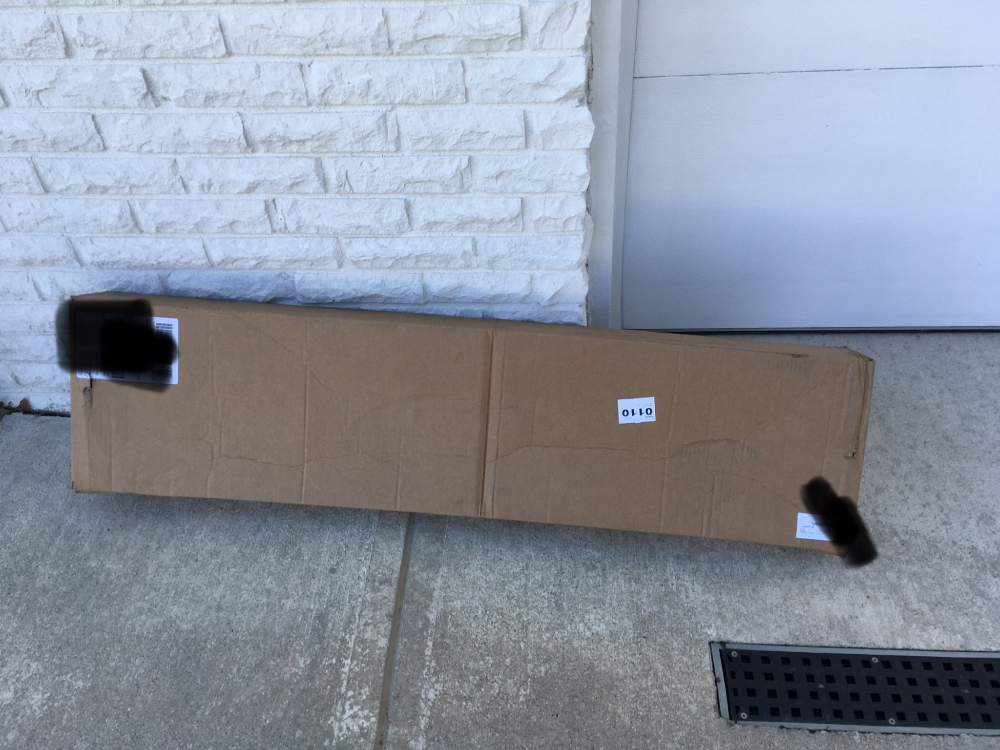

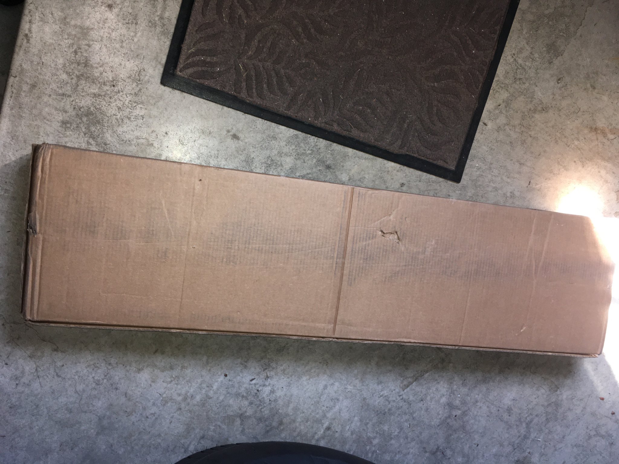

As promised I would get back to you with my shipping results..
Just received my tooth bar a little bit ago.. packaging was same as yours but held up nicely. Fedex delivered it and I must have gotten choice handlers! Box is near perfect!
Wowsa is this thing sharp! Done a paper test on the blade and it cut it cleanly! I know I will be very careful not to leave the bucket up and unattended..

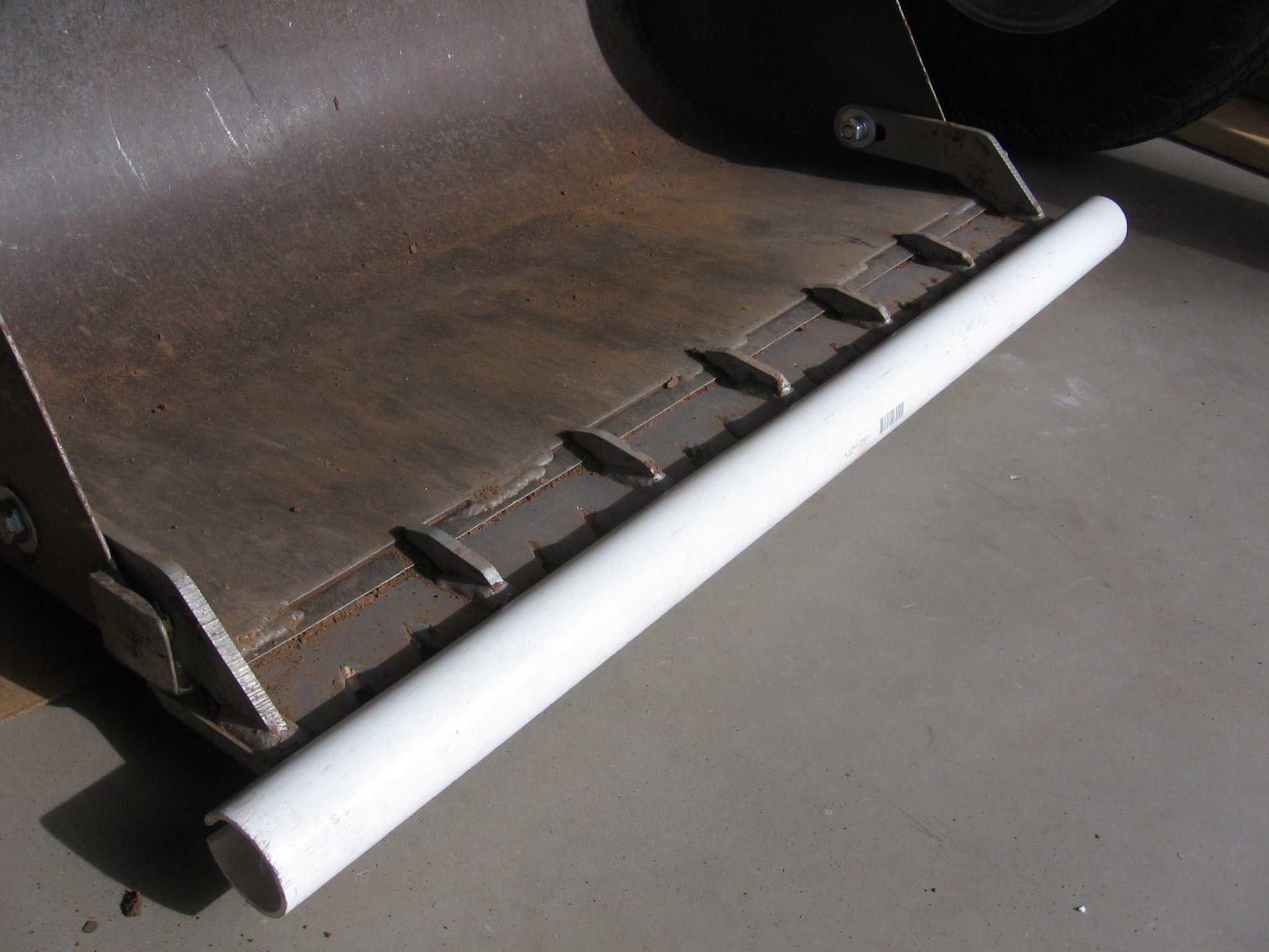

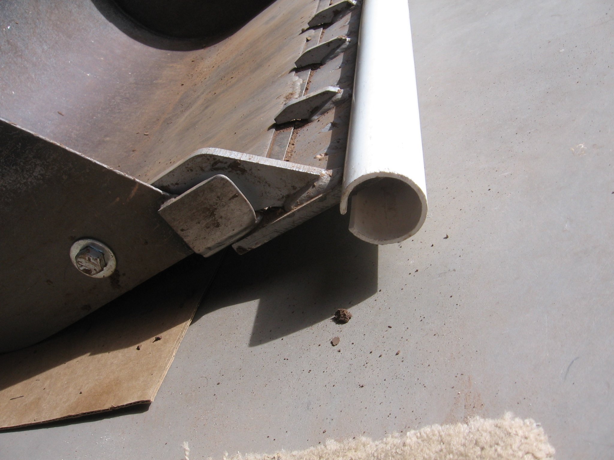

Suggested by those here, I cut a slit down the length of old PVC pipe. I had to cut a sliver out of it for a gap in the PVC, but I can just pop it on the tooth bar when I park the tractor. I could just set the bucket flat so the toothbar is flush to the ground, but I don't like the cylinders extended and exposed by making the bucket lay flat.

Here's my gaurd:

I cut the slot on my mill & took out 3/8". Even with that much material removed, I still have to tap it onto the edge with a rubber mallet. I also cut a second one out of black ABS, which goes on a little easier, but I don't like it as well, it tends to disappear in the dark garage. White works better for me.

Good idea, especially in a garage where one might not be wearing good footwear. I turn my bucket slightly forward and push down just a bit when I park it, but right now, it still lives outside. But go look up my shed build thread. Finally got under way today.
