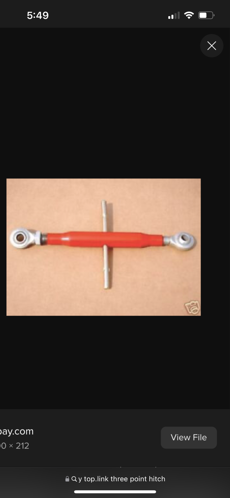

I’m not sure if I’m understanding correctly. Maybe I used the wrong lingo. But the top link is the adjusts arm that is attached to the tractor, top of the three point hitch. Looks like this. 93E0600B-C30F-4F3C-B4BD-E33EF7C6190A.png

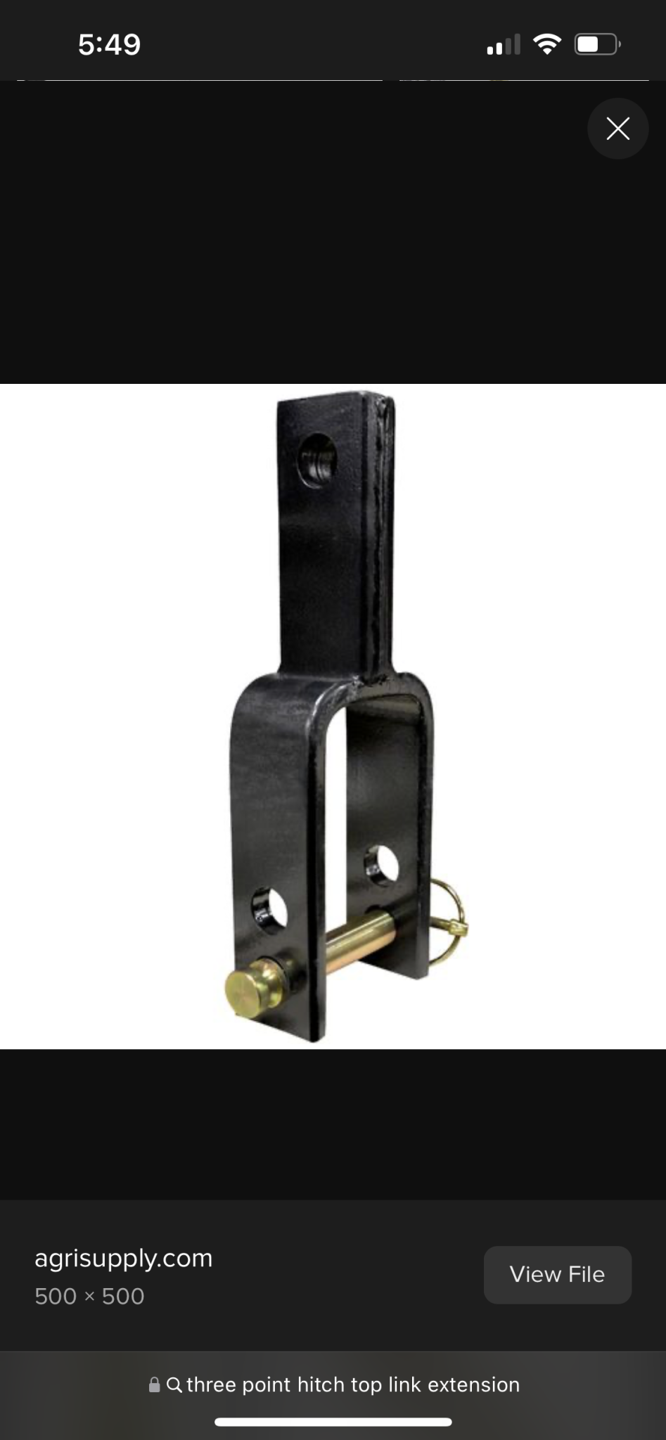

The piece that I picked up to make hook up easier was a Y shaped linkage that replaces the large hook that comes with the quick hitch. Looks like this. 35840821-C853-4F80-A456-5DD261087073.png
hope that makes more sense.
you may still need to use the top adjustable link (1st pic) to adjust the top of the three point hitch (quick hitch)

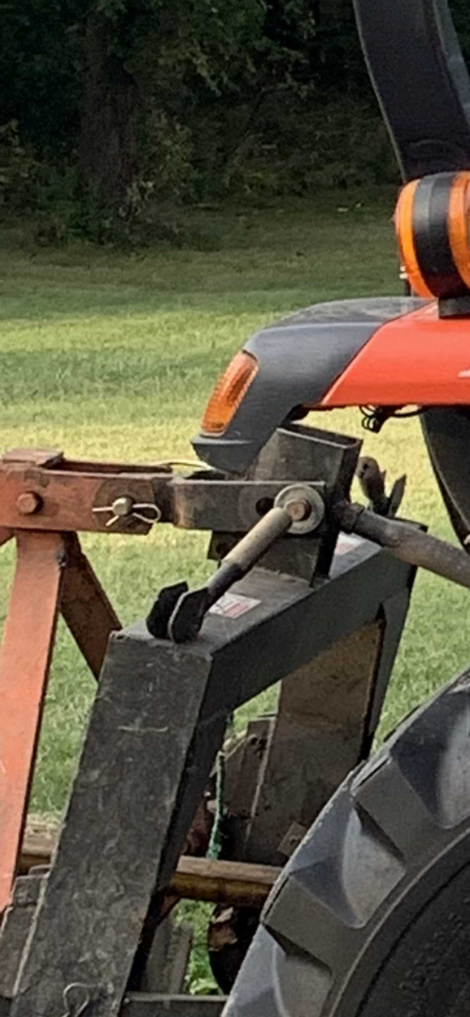

Here’s a pic of my set up, not sure if this is “correct “ but it works well for me. AC421D9C-ED67-45E8-9F0E-D94ADE2BCD89.png

I’m not sure if I’m understanding correctly. Maybe I used the wrong lingo. But the top link is the adjusts arm that is attached to the tractor, top of the three point hitch. Looks like this. View attachment 91085
The piece that I picked up to make hook up easier was a Y shaped linkage that replaces the large hook that comes with the quick hitch. Looks like this. View attachment 91086
Here’s a pic of my set up, not sure if this is “correct “ but it works well for me. View attachment 91087
I just went to their website and they no longer offer the 3-point hitch top link extension. Any suggestions on where to look elsewhere?
