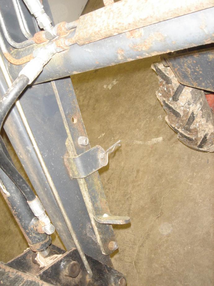

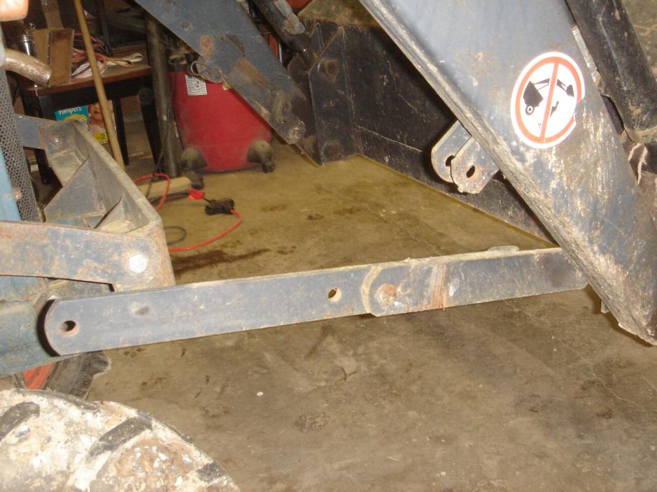

Have got the tractor in the garage today while it rains (it can rain for days on end here) and took the time to take a few photos for ordering parts and posting here on OTT. There's a couple of questions I've been dying to ask about my FEL:
Here there's a a metal bar hinged on the loader, with a second metal bar in an L shape bolted to it. There are several holes in each bar, so apparently you can lengthen/shorten the combined length. It all is held in place by the pin you see in the photo. Anyone know what this could be for?
Next, there is a rod that goes up and down with the adjustment of the loader bucket. I'm assuming this is to tell you when the bucket is level, when the FEL has it at ground-level I suppose.
Any help would be great!

The first two pics look like parking stands for when you remove the loader from the tractor, but I'm not 100% sure so you should wait for others to reply. And you are correct about the last pic, it's to tell you when the bucket is level.

I agree with 76_Bronco.
If you ever remove your FEL those bars will act as stands. Check You Tube for videos of how that is done.
The bucket level indicator should have an indicator on it to show when the bucket is level with the ground. I painted my rod black and then masked off a 1" section to paint white to show when level. The paint needs touched up every once in a while.
