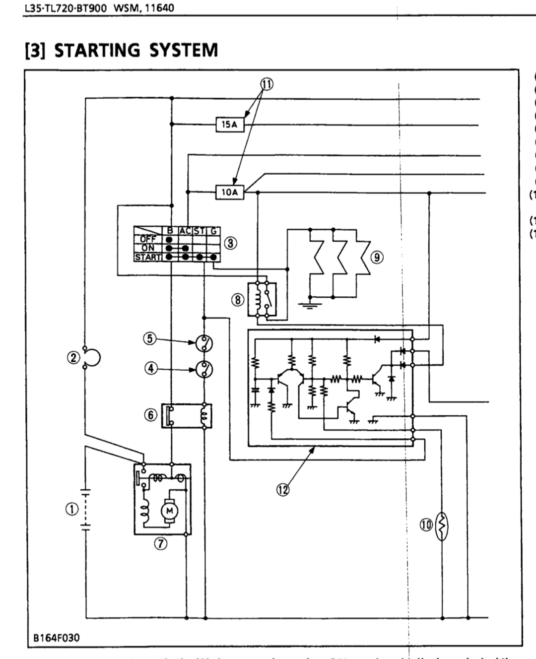

The L35 starter circuit is about as straightforward as it gets. The only two safety interlocks are shuttle neutral and PTO neutral.
6 is the starter relay. It should have 12+ volts on one side of the contact at all times and 12+ volts on the wire from the safety switch when the key is turned to start.
Do you hear a click behind the instrument panel when you turn the key to start? If not, check your shuttle and PTO levers.
