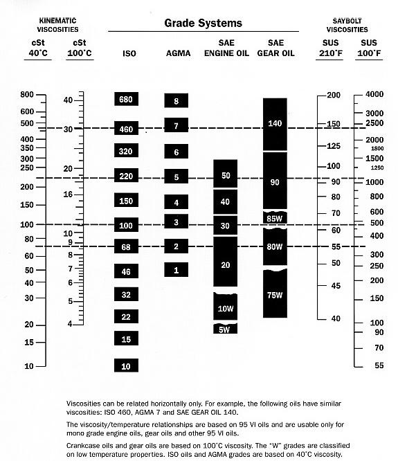

It’ll do just fine…. the 85 is the viscosity for cold wx…and the 140 is in hot wx…. The difference between 80 and 85 is unimportant. Use it.

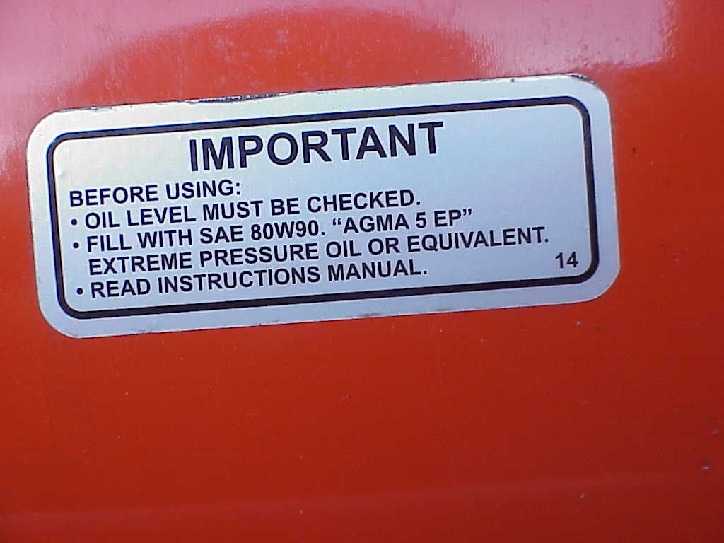

I wouldn't use it. What are you going to save $15 for the correct gear oil? There is more to the label requirement than just the weight of the oil. This is the label that is on the back of the snowblower that I have. Do you see those words "EXTREME PRESSURE OIL"? The label tells you what to use. Use the wrong gear oil, and you run the risk of ruining a very expensive gearbox.
