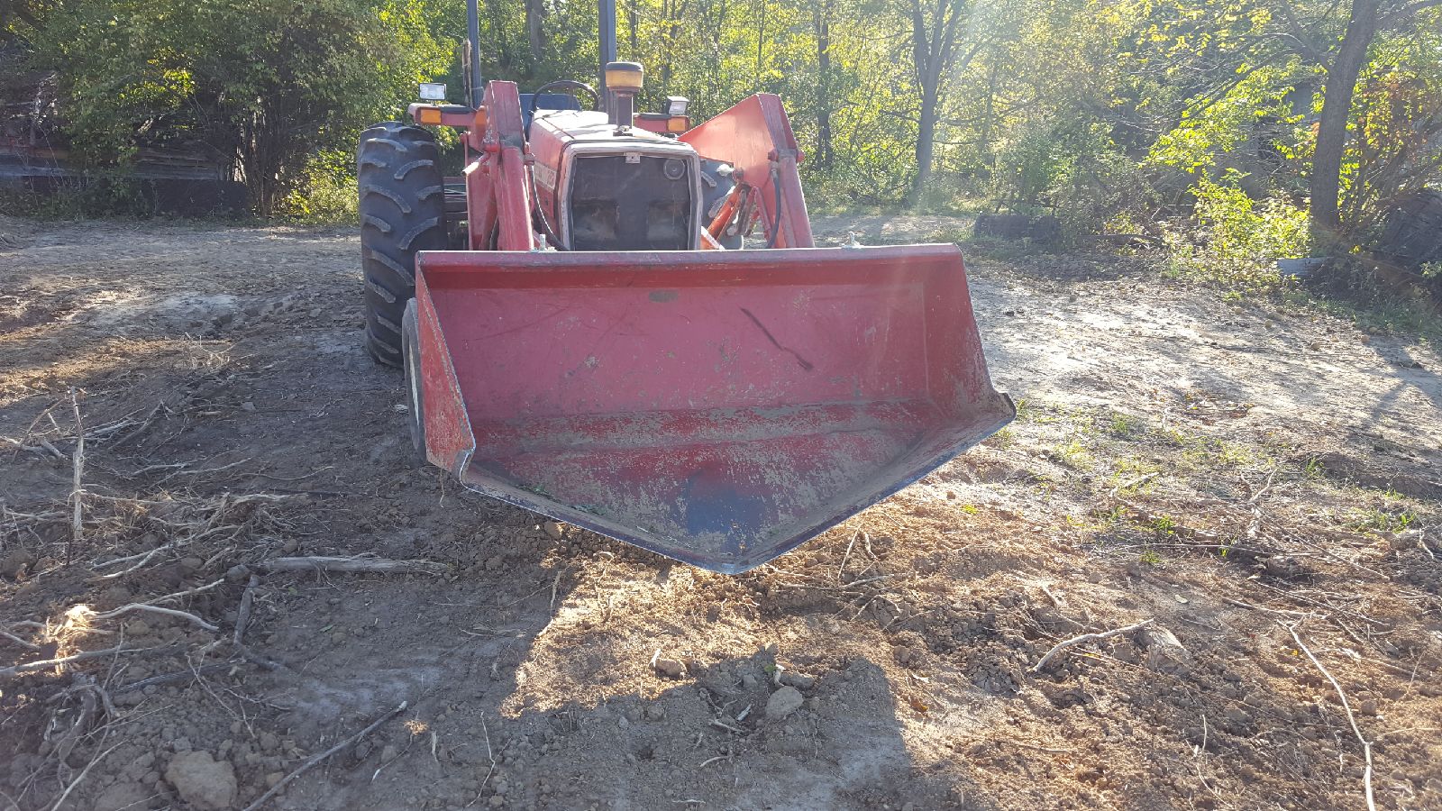

The mulch and gravel isn't an issue. It is the digging that has provide us challenges. I ended putting a toothbar on my 72" bucket and that gives a strong solid edge to cut into the dirt.

Now that is quite a smile....holy cow!
He ended up buying a new bucket, after 30 years of abuse on the old bucket, it just wasn't worth fixing any more.
He did keep the old bucket, works great for making trenches. :D
2,886
3,231
yeah, sure looks like a rather large trenching bucket.

Was going to say it looked like a very optimistic stump bucket.

Getting off topic but have to comment on that bucket. WOW. That would make a perfect bucket for making and pouring cement.
