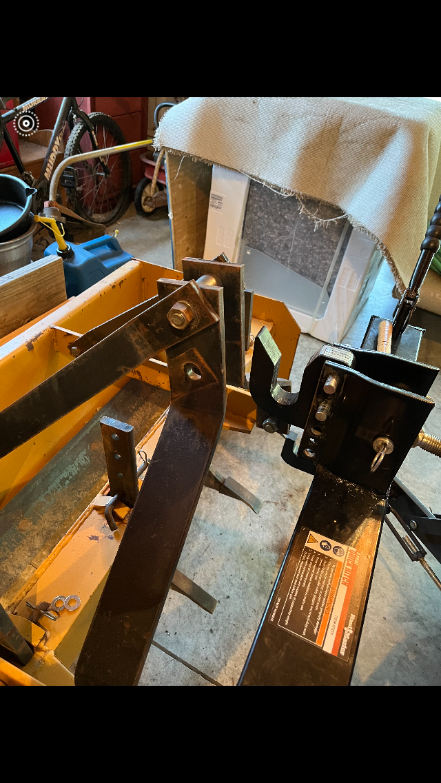

Funny you should mention this because that's exactly what I had to do as you were probably typing this. Lol Is this what you meant? View attachment 66852
It works.. will have to adjust top link most of the way out to level box for dragging and keeping front blade from cutting. I'm not sure it will level out before running out of threads on top link but at least I'm not fighting with that heavy azz thing. Man there was no way I was going to fight with that 3pt every time I needed it.😥
Yep - - perfect.
If you have to, get a little longer Top Link - $25-30 USD at most farm stores. I can get full range from dig/cut to smooth level with my aftermarket TL. But my BB is a 48, so geometry probably little different.

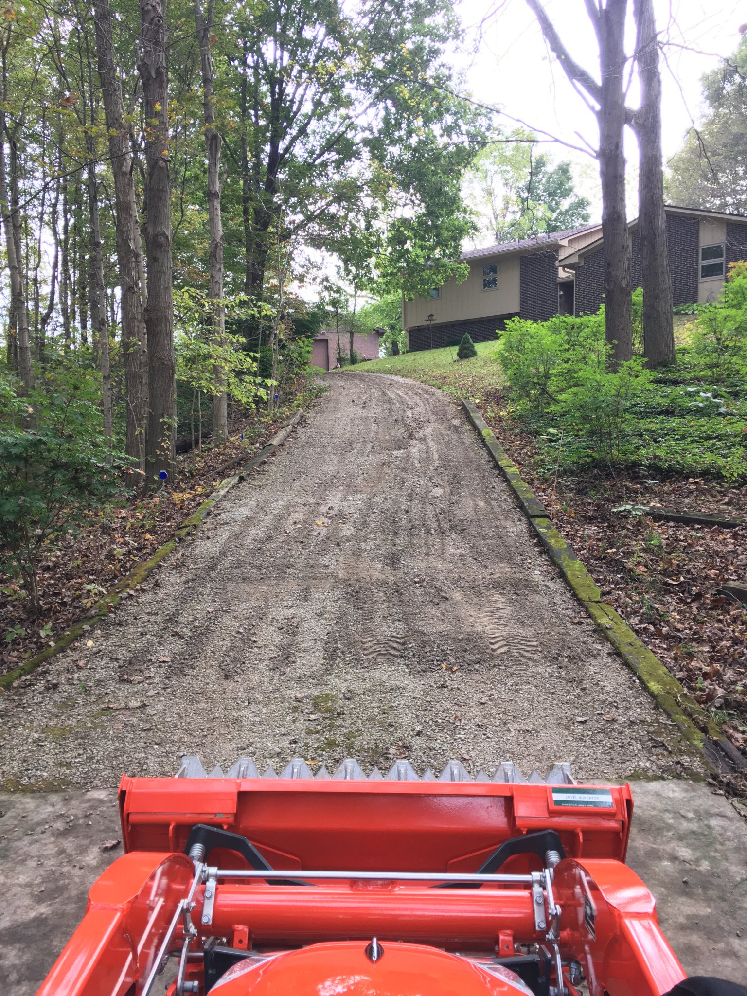

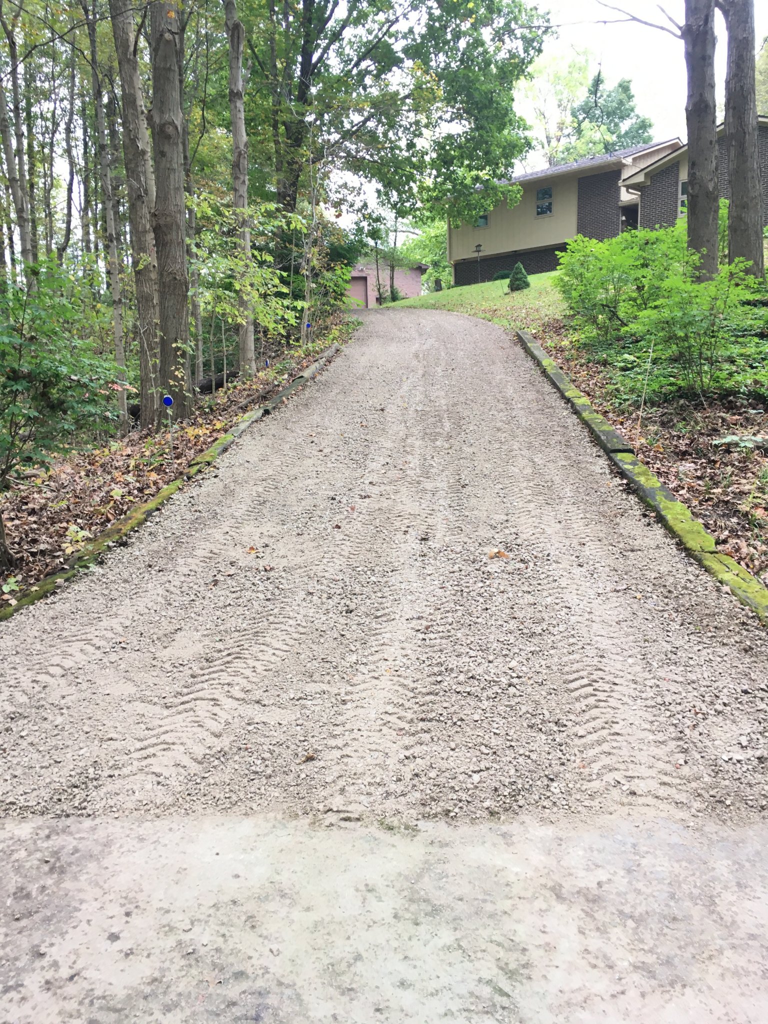

I'm starting to get use to this thing., I really like it! My favorite implement now.. I think I will need to get a longer top link because I can't get it to tilt enough to get the rear blade down to help spread without the front blade cutting. Never the less.. it's an awesome tool! D27A7A7A-0BFF-4E2F-991A-2A9628F26933.jpeg 7E67668B-5D3C-4A26-BE8C-8D8651D7D1B5.jpeg First pic was after I had already started lightly digging in, had some pretty good ruts in the bend. That hill is steeper than it looks, one of those drives you don't stop half way up in a vehicle. The BX was doing great in 4x4 with tines down and pulling gravel up hill.
