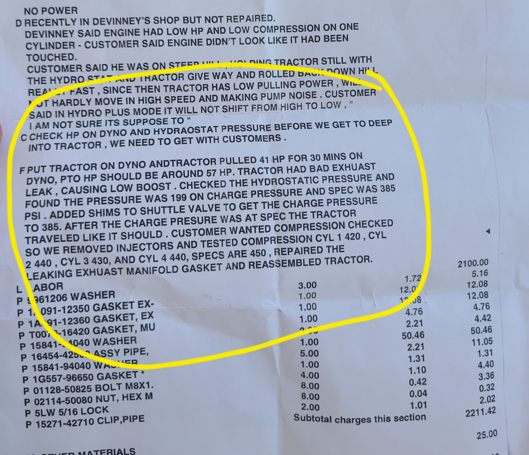

The dealership spent 13 hours @$135 per hour going through the rear end with no answers. Attached is the service sheet. They offered to take care of the labor if I paid for parts. I had no choice , I had to take that offer. I guess I'll go to another dealer and tell them what isn't the problem.

Yes. They hooked up to dyno and said it's only putting out 40 hp but said it could be a number of different things causing low HP. I asked them to do a compression test. They said one cylinder only had 50psi. When I got the tractor home I looked for evidence the compression test was actually performed. I don't see any evidence. All of the injectors/bolts/plugs etc are caked with years gunk. I think they fabricated low psi trying to convince me it wasn't worth fixing the original problem because they don't know what the problem is. Is there a way to perform a compression test without hooking into the glow plug ports?

I'm about 85% convinced that the dealer you took it to doesn't have a clue about how to diagnose or fix tractor issues.
You would have reduced HP output if you have a bad clutch disk, that's a no brainer.
There is no way to perform a compression test without going through the glow plug or injector ports.

I agree, it appears to be a slipping clutch, and leaking exhaust manifold gaskets.
Remove the starter and smell in the clutch housing, you will know quickly. It will be a very distinct odor of burnt clutch dick friction facing.

The tractor has always sounded off to me. I posted this year's ago. Thanks for the help.

If you followed the thread...the first dealer told me I no compression in one of my cylinders.

Yes I followed, The first dealer you took it to, had no clue how to diagnose it and IMHO lied about even testing it.
