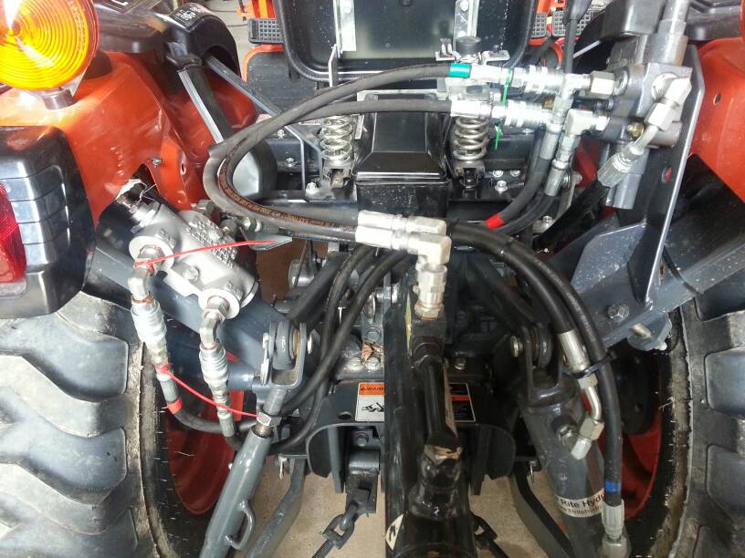

3rd function selector valve on LA364
bandaidmd
B2620 w/LA364 FEL ,BH65, ssqa , 1982 B8200E w/BF300FEL
May 19, 2013
603
Middle of DELMARVA
Keep on you'll be a pro at those steel lines. What r you building next?
I just bought a 4'bush hog/rotary mower at a sale last monday.... a green one.ugh.lol
my button setup worked out pretty good.
Burtonbr
2012 B2620, LA364 FEL,rear remotes,grapple pallet forks, many other toys.
Nov 11, 2012
179
NC
I plan and imagine the steel lines one way, but always in reality they take up more space tan I plan for I have to start planning for more room, but it is OK.
Switching to this diverter will free up 1 set on the rear, and I've got the cylinder for the rear tilt, so that will be next but that shouldn't take more than a couple
hours, I'm just going to cut the ends off the fixed linkage and weld them to my cylinder.
Next big project needs to be a grapple mount on the fork frame, I've been putting that one off, and it would be helpful.

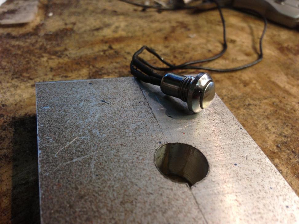

So finally got time to get my button switch worked up, this is a handlebar mount button for customs.
Just free handed a mount to attach it to the joystick. It feels good puts the button right where it's comfortable. I might make it a little smaller but for now this will work
I'll get a pic of it clamped to the stick tomorrow.

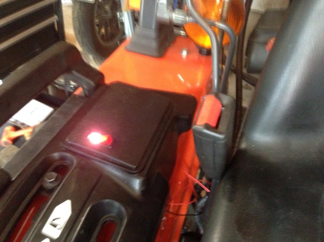

100% complete, finally. The button works great for $20, just thought the others were too expensive. Looks a little funny in the pic but it is comfortable to use.
I like this better than running the grapple from the rear remote, seems cleaner and more responsive should have done this first with the grapple.
I did add a switch to cut the power off when not in use, just thought it would be safer.

I am getting power to the switch from the seat safety switch so it's hot only when the key is on.
