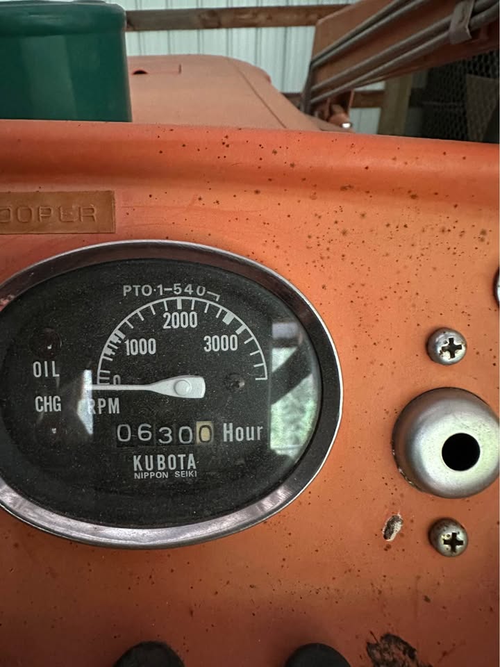

Just picked up a 1979 L245DT with 1200 loader with 630 total hours on it to start working 5 acres of "holy crap look at the size of that rock" ground. Was thinking of just getting a rock bucket, but would like to get a rock bucket with the upper grapple function. Can't to seem to find a kit specifically for this model to install the 3rd function port and control. May have to use a use a universal kit since it's an older unit? Any info would be great. Stay tuned for 1k more questions I'm sure, as I'm a mechanic but a newby to the tractor world.

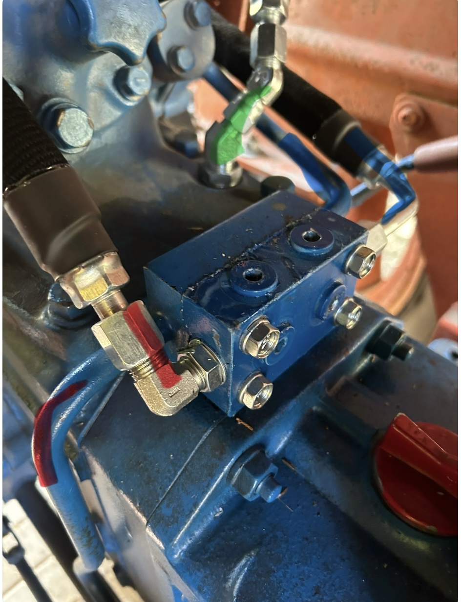

This is how the hydraulic tap on my tractor was done. The red hardline is pressure from the pump. Blue is the Power Beyond (aka high pressure carry over) from the rear remote valve. The green is the tank return from the rear remote valve. (That rear remote is all the extra hydraulics on my tractor). This uses the tractor pump while you may have an external pump on front that is driven by the shaft out of the engine.
The port for tank return into the tractor is BSPP 3/8 (aka G 3/8). The threads that are in that block above are NOT BSPP since that was added many years later and was machined by @TheOldHokie to replace the cover that had been there. The threads where the hoses connect to the block are SAE port which is another type of parallel thread with sealing washers. The BSPP and SAE threads are both based in the inch units so don’t be too surprised at that! There are probably some parallel thread ports based on the metric system but not on a Kubota tractor (as far as I know).
The hose ends shown in that picture are JIC (not to be confused with JIS) swivel fittings that seal against a tapered surface similar to a gas fitting (but not the same dimensions). I highly recommend that type of hose end since it is not likely to leak, easily installed and removed and doesn’t require the hose to rotate as it is installed.

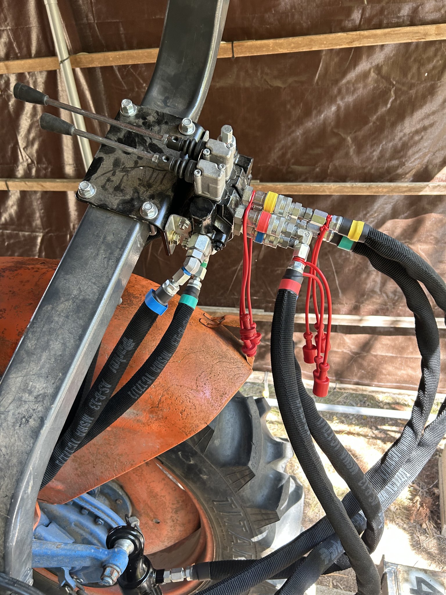

Now for the quick coupler connections (if you have any) and the valve ports. Here is a picture of the rear remote valve that I mentioned above. It is a simple two section valve with independent lever control. It has all SAE ports on it. So most of the fittings are SAE to JIC adapter fittings. The exception is the four quick coupler connections on the rear end (left). The hose side of the quick coupler (male side) have NPT threads, a NPT to JIC adapter then the JIC hose end.
Some valves will have NPT connections and use sealant on the threads. I personally don’t care for NPT connections since they require sealant and are sometimes difficult to get sealed under high pressure. There is a variety of NPT threads that are designated as NPTF that are better suited for fluids and fuel but I am not sure what the fittings are made with.

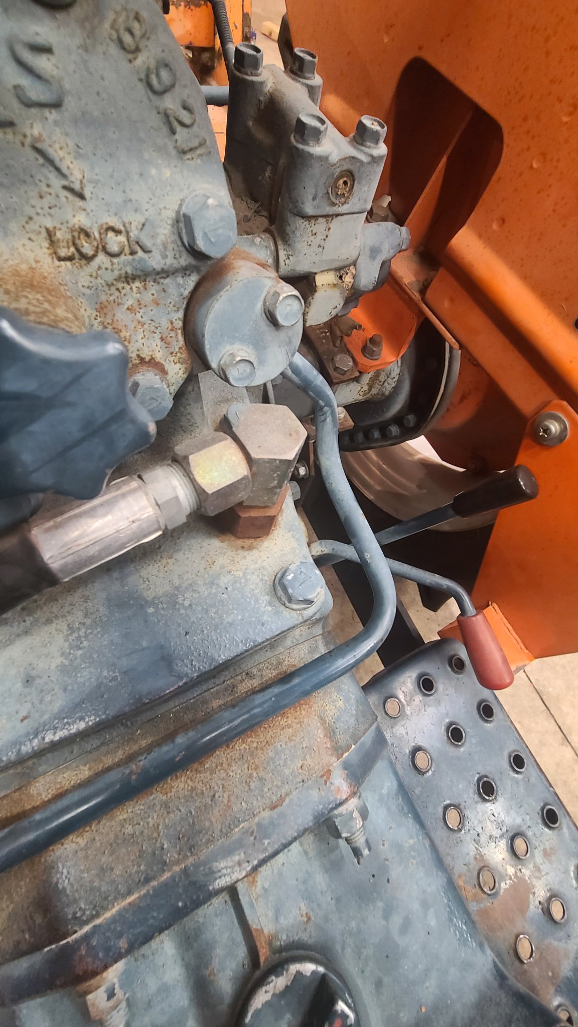

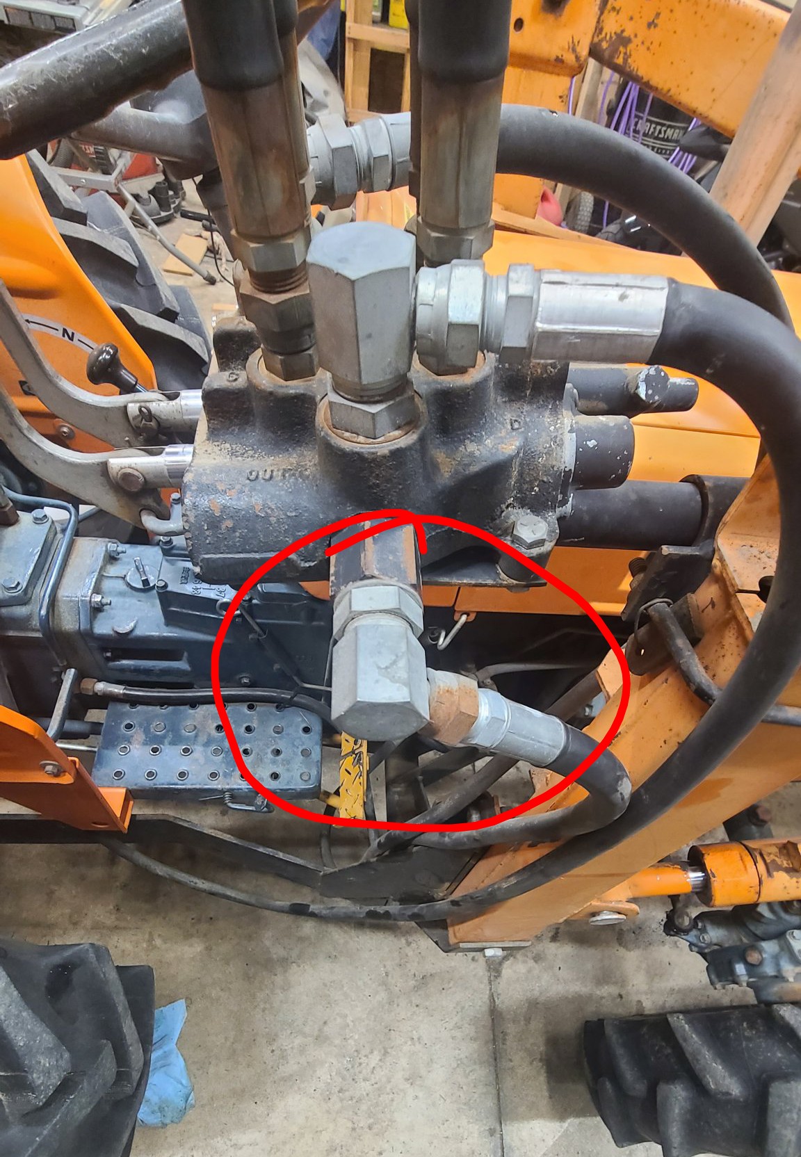

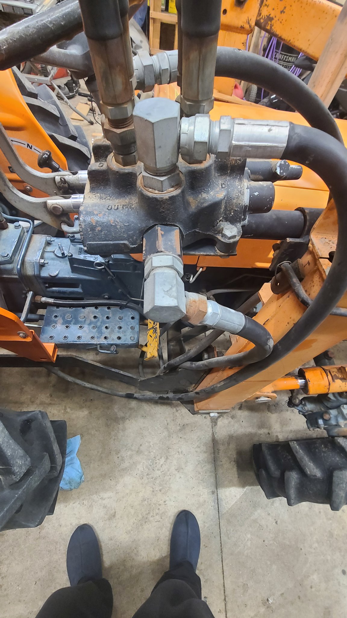

Ewe, I think i threw up in my mouth a little bit there and I was a hydraulic tech on aircraft LOL. Been a while since I delt with all the different types of fittings, making hoses/swedging etc. Got a few pics so you can tell what it currently looks like. I'm thinking the control valves and plumbing on it are all original.

Which is the Beyond Control, the top or the side port? Thinking it's the top port that dumps back in the case with the 90 degree elbow?
10,564
5,696
Which is the Beyond Control, the top or the side port? Thinking it's the top port that dumps back in the case with the 90 degree elbow? View attachment 163826 View attachment 163827
The power beyond port is the one I circled. There are two fittings screwed into the port.
The elbow is an ordinary SAE ORB x female NPSM pipe swivel. You can use it or replace it with something ekse as needed.
The hex fitting that the elbow is screwed into is a power beyond conversion sleeve and it must stay where it is.
The hose and fitting on top of the case is a low pressure tank return.
To add an auxiliary valve:
  1. Disconnect the hose attached to the power beyond port.
  2. Run a new hose from the power beyond port to the IN port if the new valve.
  3. Connect the hose you disconnected in step (1) to the power beyond port of the new valve.
  4. Install a tee in the tank return and using a new hose connect the tee to the tank port on your new valve.
Thats it.
