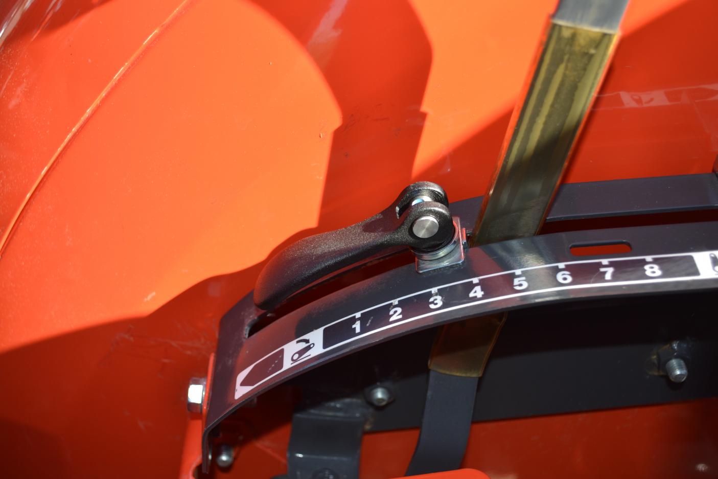

Okay I tried the star washer and had limited success so I had a wild hair and looked for a cam lever. found one put it on and it works great! easy to use, lift up and move, press down and lock. found it at Granger and you can get it with external or internal threads. Threads are M6 on the existing bolt so i used every thing that was there and just swapped the knob for the cam lever.
Granger Item # 30HJ39 or Item # 20WY78

Thanks you very much for your find - It seems perfect. I was going thru the same frustrations.
Found it on Grangers site but they want $10.48 to ship to NH.

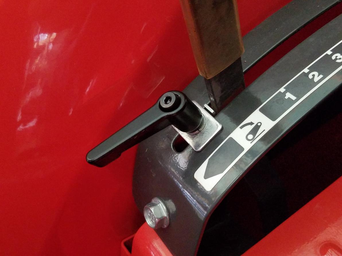

This is how I dealt with mine last year when the OEM plastic knob
broke...adjustable lever bolt. They are about $5 at various places like MSC
direct and McMaster Carr. I have used them for years on tractors and mowers for things that regularly need removed or adjusted. No tools needed.
That cam lever sure looks nice...I had never seen them before. Will have to try them out. Thanks for sharing.
