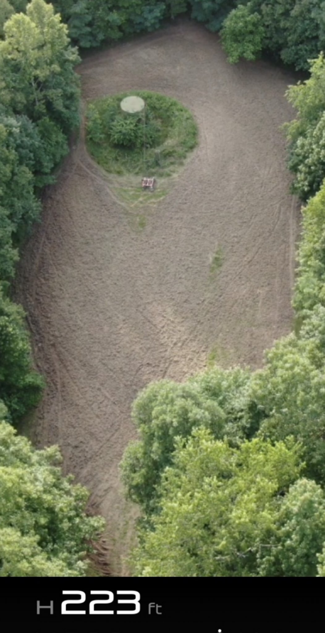

Ran into this scenario just yesterday.
Was easier for my particular situation just to square it off as needed and then go back and forth to do the leftover quarter-moon slices.
Beats tearing up a lift arm, right? 😁
This small (<1 acre) plot took about 3hrs using the 6.5’ 3-point disc harrow shown in the pic.
You have exactly the type disk I am looking for. I have not decided on the width yet, but 6.5 might be a good compromise between maneuverability & size.
Currently, I just turn a corner & the disk follows. I may need to learn to lift the disk when approaching a corner, turn, back into the corner, drop the disk, take off again. I will not be able to trail my broadcaster behind the disk any more.
