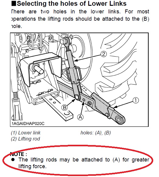

On some larger Kubota's the lower 3 pt arms have two possible holes for the lift rods to connect to. One position for maximum height and another for maximum weight.
Compare yours to the page from a different model's owners manual.

I pondered this some more. I would definitely check the lower link mounting points Dave Eng suggested. Great idea!
