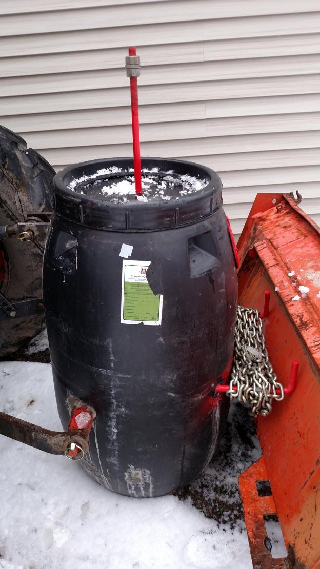

This is the one I just made from a 55 gallon drum for my L4200 (hope the image attached). It ended up weighing about 1200 lbs but I am using it to run a grapple bucket picking up logs. I made an attachment point for the top link because I didn't like the idea of this thing rocking back and forth. Also added hooks out the back to hang chains/tow strap on, and more weight plates can be stacked on the rod coming out the top if more weight is needed (unlikely). You could probably do something similar with a half barrel or a smaller barrel.
