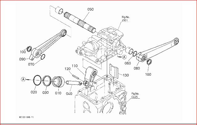

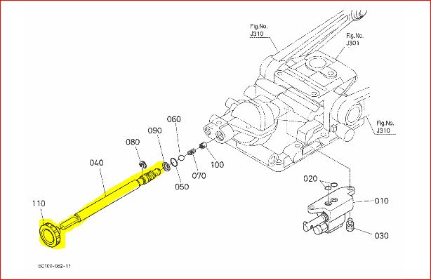

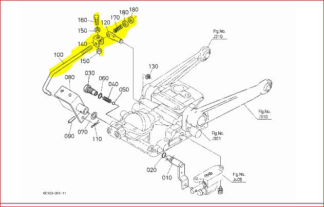

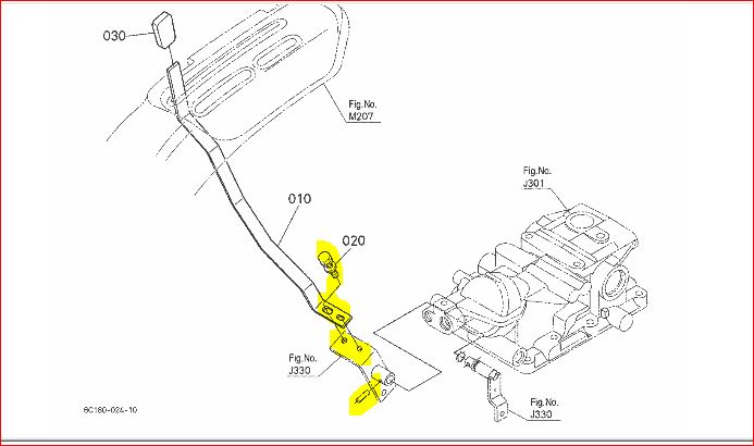

#1 There is nothing in the housing to come loose, Zero adjustments, pulling it apart would be a waste of time!
As for the lever, there is no adjustment either, just make sure the bolts and one pin are intact.
Now here is probably where your problem is at, it's called the feed back lever and it's probably come loose and is effecting the 3 point operation.
it will 100% change the position of the lever! ;)
Yes also get the WSM for future use!:cool:

I was able to fix the problem. It was positioned slightly forward, so I had to put some pressure on the handle to get it in the middle. I followed North Idaho Wolfman's advice and it worked! Thanks for the diagrams. I went ahead and ordered the shop manual.
