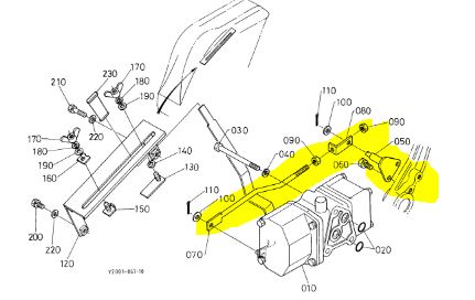

Have you checked that the feed back rod is connected?

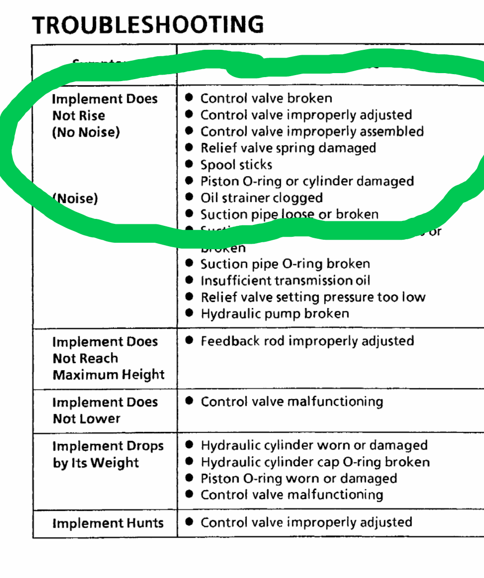

So, I'm probably wasting my fingers and time here. One of the items in the WSM troubleshooting table for hitch doesn't lift is Relief Valve spring broken. In the diagram below, taken from the WSM, you'll see 2 relief valves. The green one is in the priority/diverter valve body you've been obsessing over.

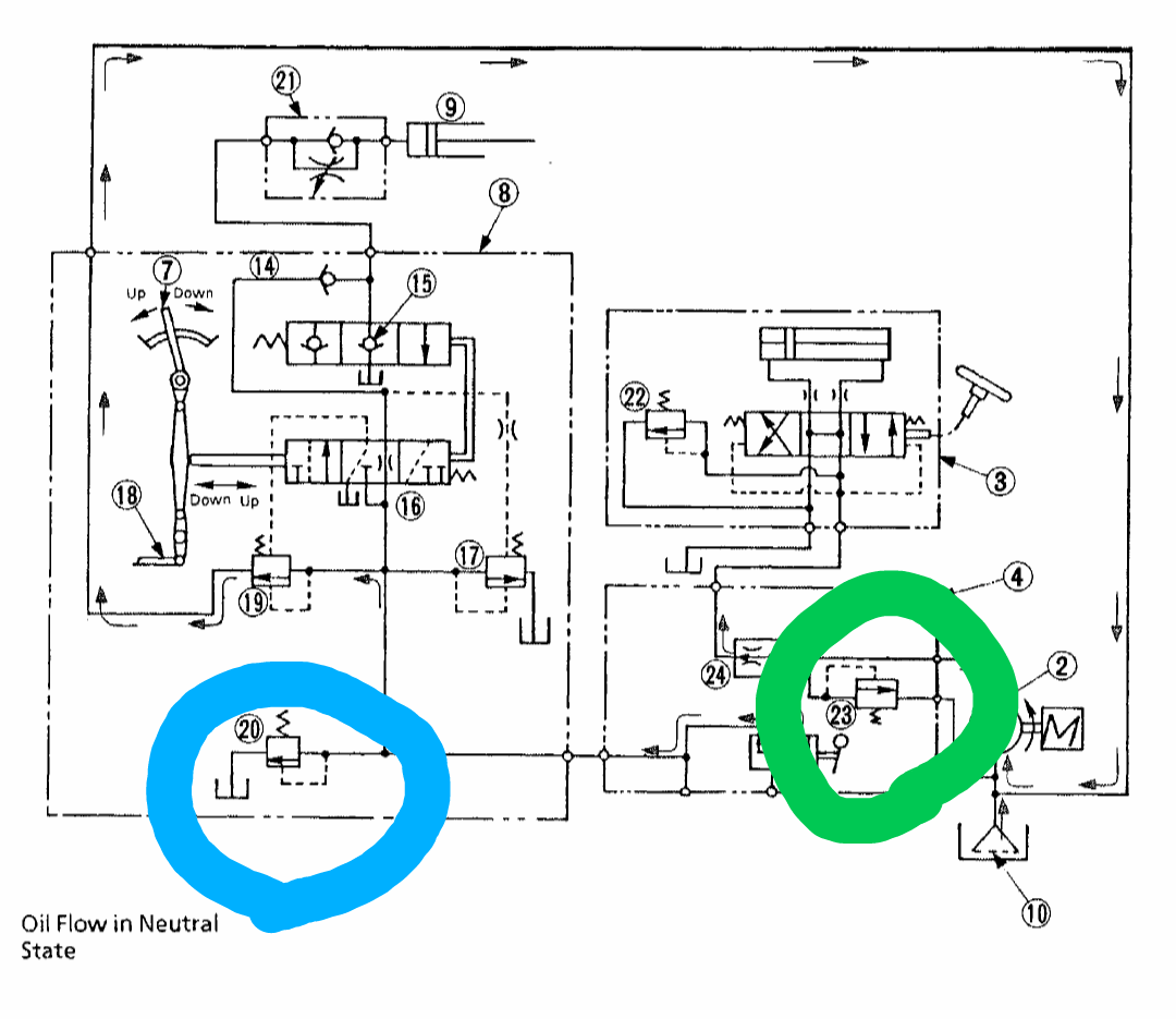

The blue one is in the 3PH valve body somewhere. Schematically, you can see it would limit the pressure to the 3PH and nothing else. Then looking at the lift cylinder, #9 in the diagram, you'll see that the control valve etc. would prevent back flow from the cylinder, letting it fall, and the relief valve is not involved in that part of the circuit.

Have you checked that the feed back rod is connected? View attachment 78144
yes i have. the linkage under the cap is all in tact as well. the valve seems to work correctly. if i get the arms up, and drop the lever half way down, the arms drop about half way and hold. it will hold weight at the desired height was well. it just wont lift it back up. the circled port in this pic is where the fluid feeds the piston. with the cap off, when i run the lever it does push fluid to this port, but i can very easily plug that port with my thumb and hold it back ( full throttle, lever maxed "up"). seems i can do that same on the line that actually feeds the valve assy you posted.

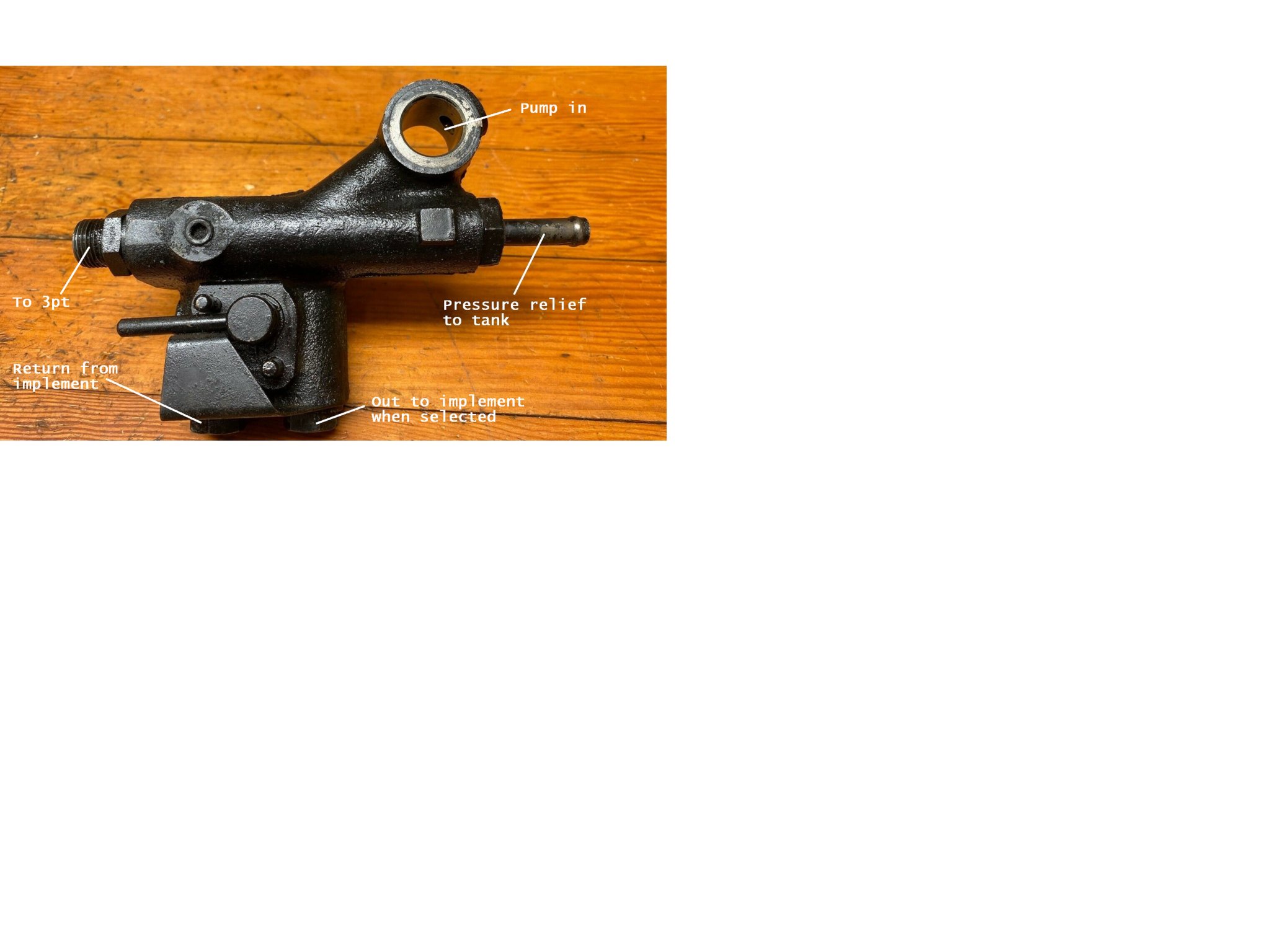

yes that is the valve im reffering to, on the bottom side there is a divider valve for the PS versions. i did change that selector, which closes off the ports to the loader. it appears thats all it does. it may have made a slight improvment not having fluid flow to the loader but barely noticeable. #5 in the schematic you posted is the divider im reffering to. the parts schematic shows that port being capped off with no valve on MS versions. im thinking this valve works to give priority to steering if the steering is called for while the 3 point is also calling for fluid? im thinking there is where my problem is. maybe it's not allowing any priority to the 3 point at all but im not sure how to comfirm this?
If this is the valve on your tractor it has a pump pressure relief built into it. Under normal operating conditions there should be no flow coming out the relief nipple. Connect a pressure gauge to the 3pt outlet and you should read pump pressure.

Ron, here's the troubleshooting table. I was going to suggest checking the piston and cylinder, but if that was the problem it wouldn't stay up when you lift it manually.
thanks Dan, yes that is exactly the valve. i will do a pressure test there as soon as i can. am i mistaken that the pressure relief in this valve would also provide pressure relieve for the loader functions and power steering?

Yes, but.. not exactly. The power steering kind of needs to have its own pressure regulated lower than the main system pressure for a flow divider to do its job. Otherwise you could have a situation where bumping the steering to its limit of travel or turning against a rock etc would cause the main pressure relief valve to open, which while it wouldn't necessarily STOP the loader it would certainly drastically drop its speed if it happened to be moving. Could potentially cause a dangerous situation if it was heavily loaded and then 'jerked' due to a change in hydraulic flow from the main relief opening. That's my understanding, anyway.
A flow divider can only divide from a higher pressure to a lower pressure area, as far as im aware. You can see the relative pressure limits on this diagram of the valve on my b8200 which suggests the flow divider needs a minimum ~85psi pressure differential/delta to function. If the 'downstream' systems were to obstruct/dead-head for some strange reason (like disconnecting a hydraulic quick disconnect without changing the directional valve etc) the main relief WOULD open but it's not exactly setting the operating pressures for those circuits. Those are dictated down to a certain point to 'protect' or ensure the function of the flow divider.

Yes, but.. not exactly. The power steering kind of needs to have its own pressure regulated lower than the main system pressure for a flow divider to do its job. Otherwise you could have a situation where bumping the steering to its limit of travel or turning against a rock etc would cause the main pressure relief valve to open, which while it wouldn't necessarily STOP the loader (you'd still have whatever flow the pump could make at the pressure relief setting) it would certainly drastically drop its speed if it happened to be moving. Could potentially cause a dangerous situation if it was heavily loaded and then 'jerked' due to a change in hydraulic flow from the main relief opening.
That's my understanding, anyway. A flow divider can only divide from a higher pressure to a lower pressure area, as far as im aware. You can see the relative pressure limits on this diagram of the valve on my b8200. If the 'downstream' systems were to obstruct/dead-head for some strange reason (like disconnecting a hydraulic quick disconnect without changing the directional valve etc) the main relief WOULD open but it's not exactly setting the operating pressures for those circuits.

Moving the selector valve to the position shown in the picture will take the loader completely out of the circuit.
