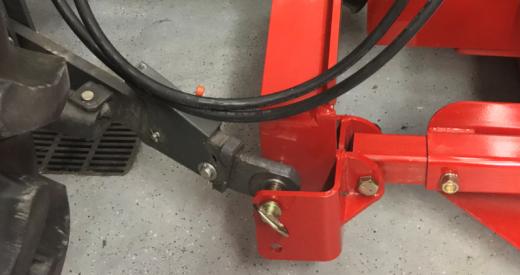

Good afternoon,
I am hoping some one call tell me if there is such a part I seek/need.
I have a bunch of 3 point hitch items. pole hole digger, wood chipper, back blade, brush hog, flail mower, 2 snow blowers, tiller...and use them on 2 tractors.
Attaching the back blade is easy as its light and easy to move. The wood chipper is terrible as its about 1000 pounds and does not like to move.
I tried to convert to quick hitch but not a good fit for me.
3 of the items mention above have a GREAT setup. Instead of having to spread the arms out and over the pins on the left and right side they have a boxed off area that you just back your arms into and then slide the pin in. so the pin is not attached. I hope that makes sense. so the arm is sandwiched in between to pieces of metal on the attachment and the pin is the part that comes out. I attached a picture too of my 7' farm king snow blower!
My John Deere MX8 is around 1400 ponds and it has this setup and is easier to hook up than my 5 foot tiller which is about 600 pounds.
Does any one know what this type of setup is called?

Don't know if there really is a name for it.
You would have to make yourself or have someone make them up for you. ;)

Thank you everyone! clevis-type hitch!
