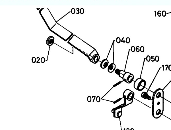

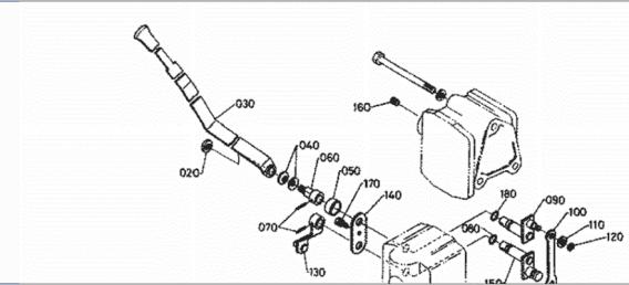

The parts diagram shows that that the lever (30) is attached to the shaft (60) with a machined flat. The nut (20) just holds the lever onto the flat and the lever / nut / shaft all move as one piece. The shaft (60) is in turn attached to the internal valve with a roll pin (70).

If the lever #30 is not separately rotating on #60 shaft then you have an internal issue, like a broken spring.
I would get the WSM before you dive into that kind of repair.

What are the 040 parts? They look like washers and could be Belleville (conical spring) washers. If they are crushed or assembled incorrectly they will not hold the lever in position.
Perhaps remove the lever and see if the shaft will stay in position with nothing attached. It looks like you can adjust the shaft with pliers.

Part 40 is listed as spring washers. But since I think they are located between two parts that seem intended to rotate together, I think they are to keep the fastener tight, rather than to add any friction to the lever movement.
I believe these are to provide friction for the lever and should be investigated further.
EDIT: Heads up to Russel King, he's on the money, video of the valve and collar appear to show that the collar floats over the shaft between the handle and housing creating the friction required to hold the lever in place. I was looking at the pressure on the handle from the nut and washer to the shaft.

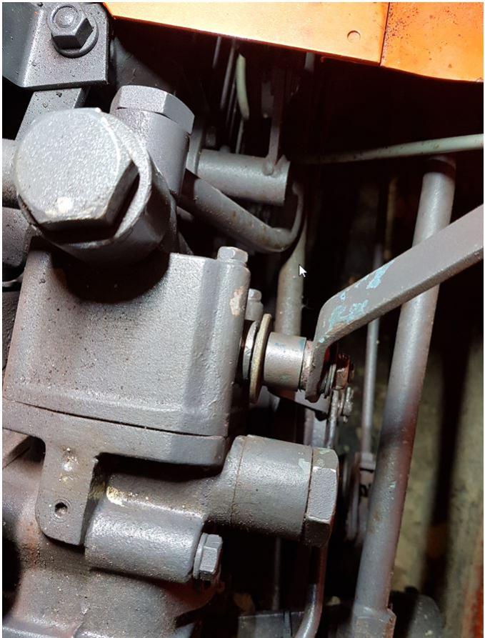

I made a short video to help demonstrate how it is currently working. I show how the hitch responds when moving the lever, and then I took apart the lever and showed how the various pieces attach.
I am thinking that the tube collar over the roll pin is supposed to apply some friction against the control valve housing, but everything has worn to the point that the nut tightens against the end of the machined flats before it tightens against the control valve.
https://youtu.be/0cHbdwLNnLE
I think I am going to try to find a washer to add between the control valve and the tube spacer to see if that helps. Let me know if you guys think I am on the wrong track. Thanks!

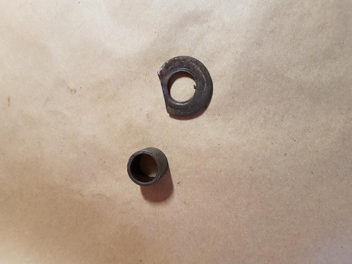

Well I found a flat washer that fit over the roll pin section of the shaft. I had to cut one side down so that it had clearance for the nut and feedback shaft located below the control shaft. On re-assembly everything tightened up nicely, and I can now add a very controllable amount of friction to the lever when tightening the nut. It seems to work perfect now with the additional washer / shim.

I am having the same symptom with my b9200hst. Your post is great,but I am confused which part

I am having the same symptom with my b9200hst. Your post is great,but I am confused which washer was added, even with the picture. If you could add some words of wisdom, I would greatly appreciate it!
