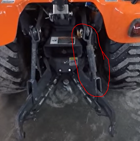

3-Point Hitch Adjustment Turnbuckle

mine is mostly used for leveling the implement.

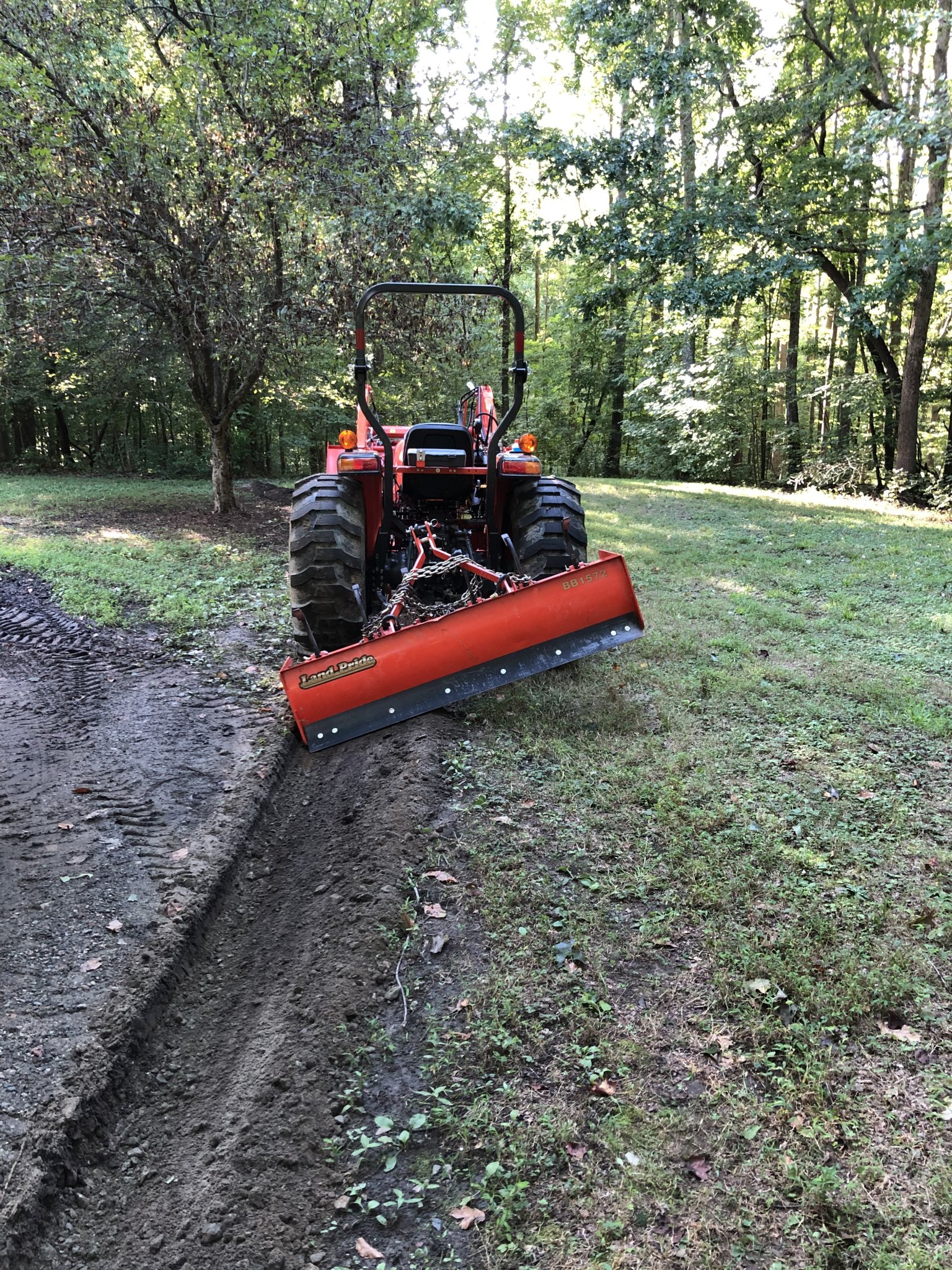

Sometimes you may wish to use an implement such as a box blade for cutting a shallow ditch instead of leveling stuff. The turnbuckle gives you that option.
