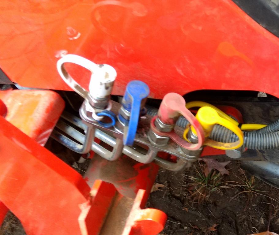

Kubota has two different colors schemes for the FEL vs the blower connections.
The connector caps are colors to connect the loader hoses.
There is a colored ring on the connector to match for the blower hoses.
Notice the blue ring on the white connector cap. The yellow cap has a red ring for the other hose.
Yep - I've got the same arrangement as Howling.
I just put the colored rings in different spots when I assembled it.
