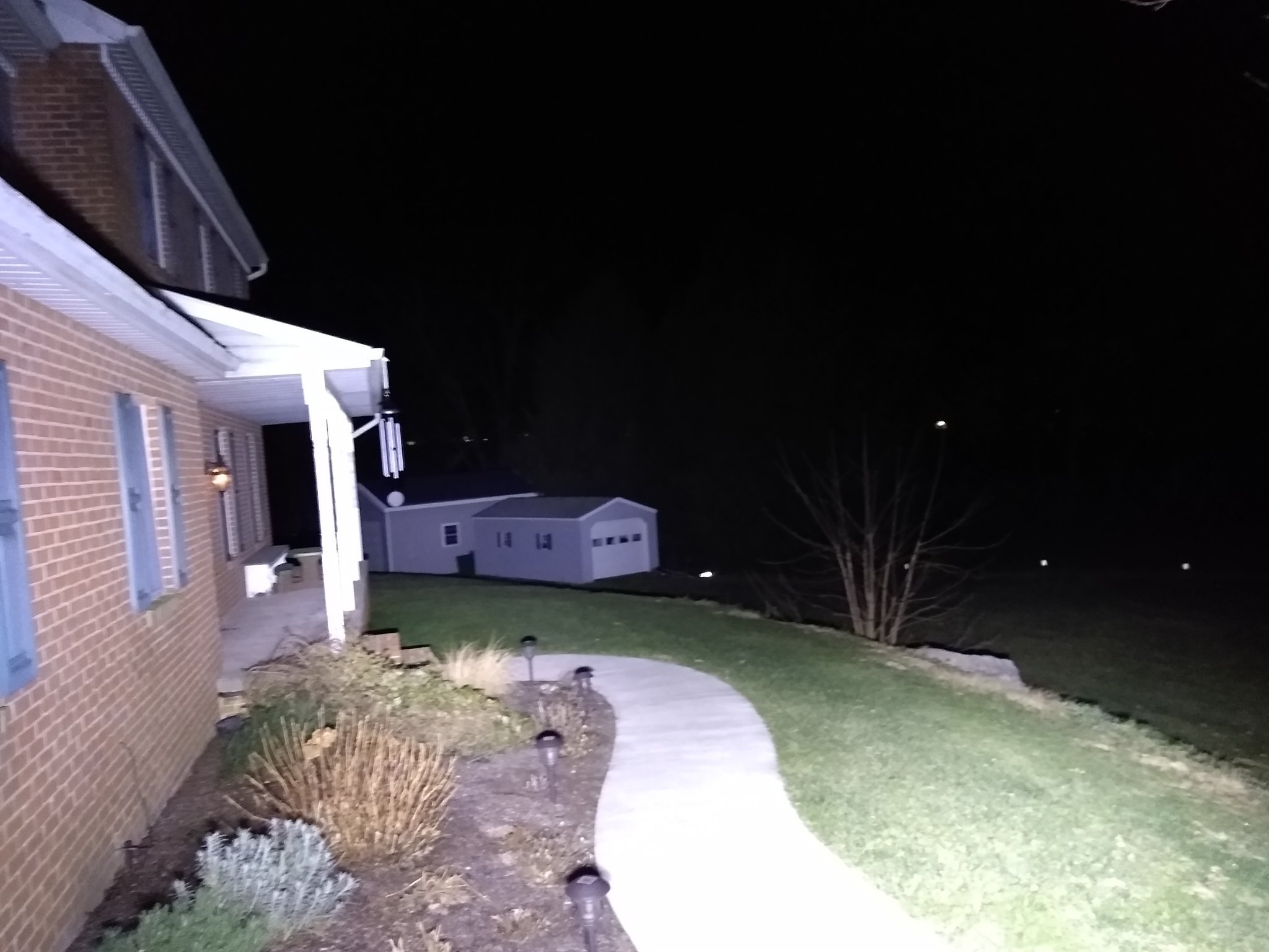

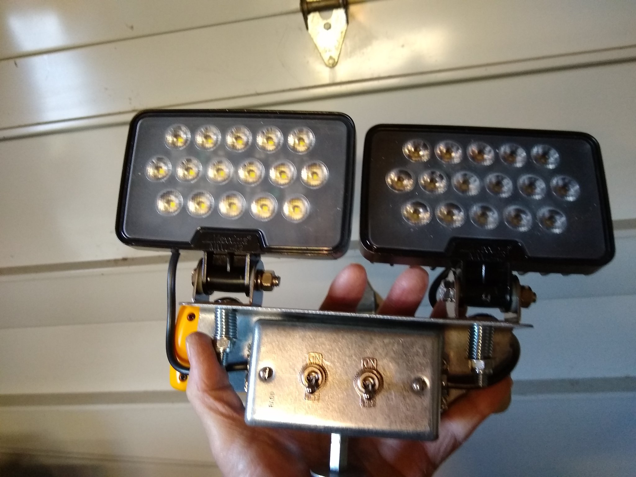

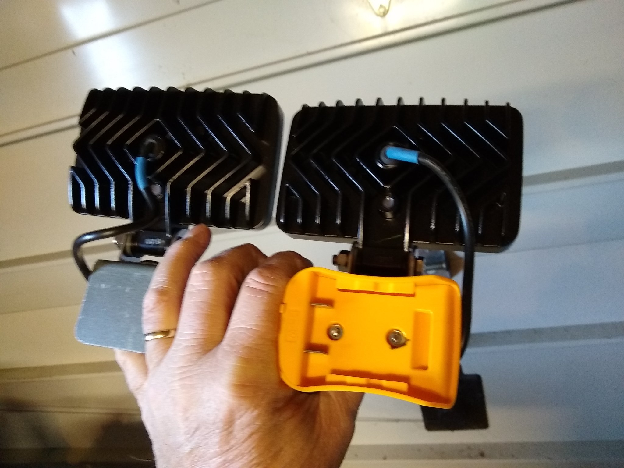

I've often thought about buying or making some kind of light stand to add to the lineup of battery powered work lights. Something that could go on a stand and be aimed easily. Something that would do a large area. When a buddy gave me an adaptor that clips onto a DeWalt 20V MAX battery several weeks ago, it got me to thinking.
There were a couple new Maxxima MWL42's here that were bought last year for the old Ford. But the Ford doesn't get used very much after dark. There are also several serviceable halogen lights laying around, like the ones the Ford has been wearing since 1991. Then there's the Slik tripod gathering dust. Most of the material was just waiting to be put together. Still need to do a runtime test, but it appears a 20V 5AH battery should keep one light on for almost 3 hours and both on for about 1-1/2 hours.
I had thought of adding a "flat two" plug like I have on some other stuff, but (A) didn't want to be capable of feeding 12V and 20V together and (B) was too lazy to add a switch to prevent that:) Plenty of 20V batteries anyway.
Here's the result. The night pic is of the sheds about 100' away.

presumably those are 12V lights... are you driving them directly with the 18V off the battery? Or did you include a voltage splitter of some sort in the switch box?
I did something similiar for my DeWalt batteries. I 3D printed my adapter.
Important NOTE: The batteries do not have undervoltage protection! If you forget and leave the lights on too long they can/will drain the batteries below the safe recharge voltage and ruin them.
I came close to doing this. So as an electronics engineer I designed and built a little undervoltage lockout circuit for mine.
