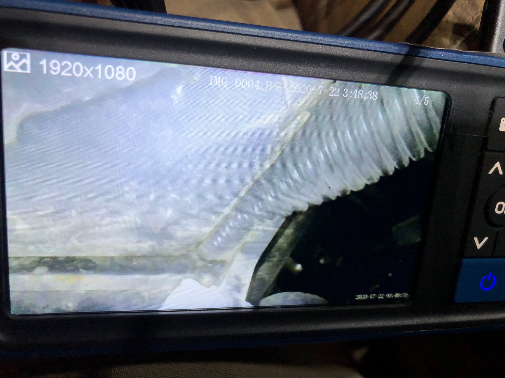

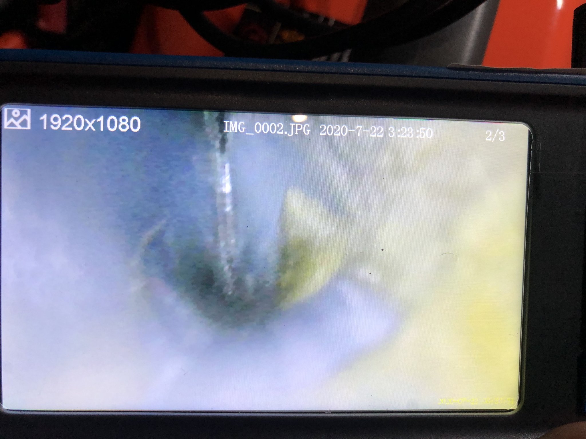

Figured it out!
The factory ran the breather side hose through some ridiculously small space and it has it pinched closed. I ran a borescope in from the breather side and found it quick. It’s a welded together bracket and it won’t even wiggle its wedged so tight. I don’t know how they even got it through the slot..
The only option I see is to cut it out and run a new hose. I sent pics to the service mgr to get his opinion first.
