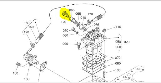

Yea you're going to need to get the air out.
On the side of the injection pump is a jet start valve.
Open it up and crank the engine in short runs till you get fuel with no air out of the valve then close it.
If that doesn't work you're going to need to crack the injector lines at the injectors to get the air out.

Well…… found out the fuel bleeder valve was open. But i have collected some good information here thank you
