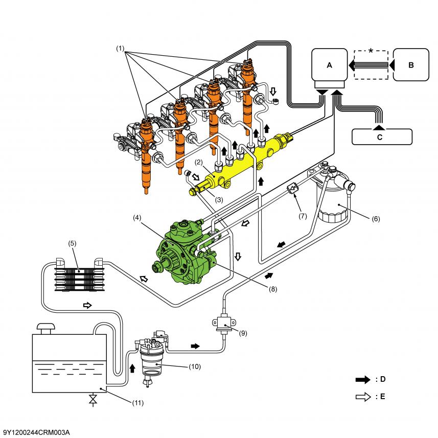

Have a good look at your fuel system, is it similar/different than this?
(1) Injector (2) Rail (3) Pressure Limiter (4) Supply Pump (5) Fuel Cooler (6) Fuel Filter (7) Check Valve
(8) SCV (Suction Control Valve) (9) Fuel Feed Pump (10) Water Separator (11) Fuel Tank A: ECU for Engine B: ECU for Tractor C: Sensor D: Injected Fuel Flow E: Returned Fuel Flow

100td thanks for that pdf. Scary indeed. My favorite page was the one that described stages of learning in a part :eek::eek:
That pdf is awesome

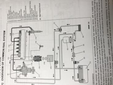

100 td, I have a similar diagram in my wsm which covers all the L60 tractors, and there are several differences in the fuel routing. Basic premise the same. One of the pumps, the feed pump, is supposed to lie between the fuel cooler and the fuel filter, and is supposed to have priming pump on it. I thought that was interesting. Picture looks kind of like the one I have seen pressed on my 2003 truck by a mechanic trying to get it started, but I've never had occasion to look for it on my tractor.
I'll see if I can add a photo.
