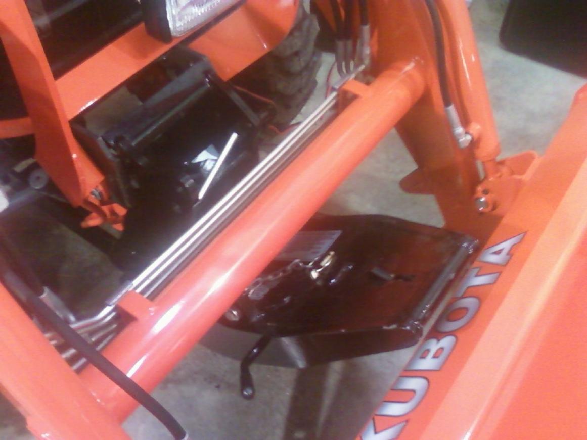

I will take some pics. I just drop off the blower from quick attach and then remove hyd. clyinder and bracket. then i made up a turn buckle and and adjust it so quick attach does not touch loader brackets and steel hyd. lines. quick fix to a big problem
