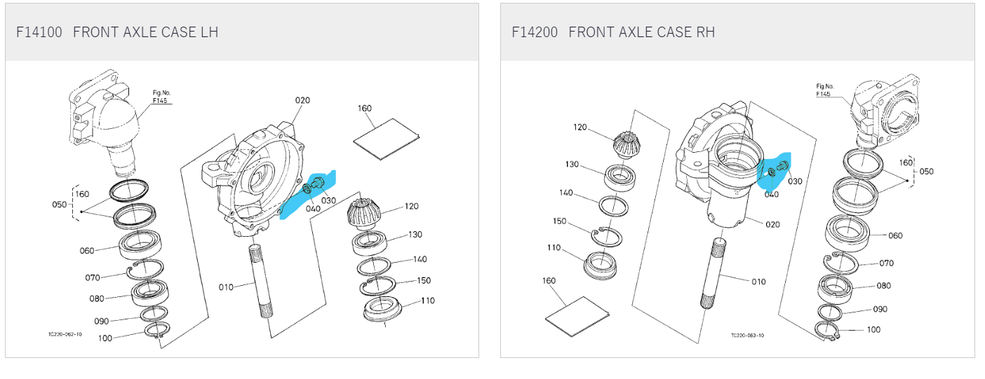

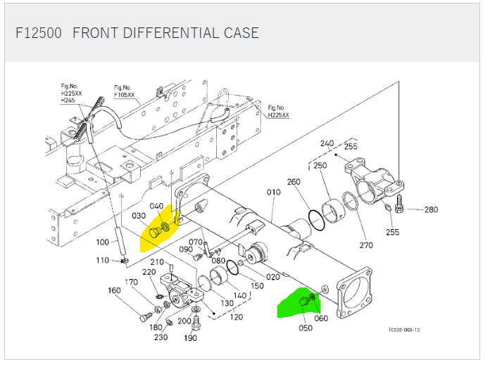

North Idaho Wolfman Moderator Staff member Lifetime Member Equipment L3450DT-GST, Woods FEL, B7100 HSD, FEL, 60" SB, 743 Bobcat with V2203, and more Jun 9, 2013 34,109 9,298 113 Sandpoint, ID Jul 14, 2024 #22 Front axle UDT. Front fill yellow Full port green Drain Axle in 2 locations. Reactions: 1 users
R racer86y Member Equipment 2010 Kubota L2800 Sep 7, 2022 47 5 8 Kingston,Ok. Jul 14, 2024 #23 North Idaho Wolfman said: Front axle UDT. Front fill yellow Full port green View attachment 132710 Drain Axle in 2 locations. View attachment 132711 Click to expand... Thanks a million for all the info. Reactions: 1 user
