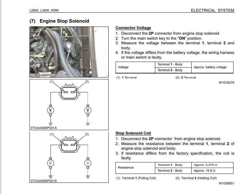

Sounds like you have an issue with the stop/ run solenoid.
Do you have the WSM (aka service manual)?

Thanks! I will take the readings, let you know. Seems straightforward, but then again, I have said that about other things . . .
The last L2800 owner with problems like yours found the OPC timer was not providing power to the solenoid and the first test in the two I provided showed this.

Sent you a copy of the WSM.
Got it. Thank you! Got side-tracked yesterday. Going to run the checks today. A couple of questions before I start. 1. On the first test of the wiring to the stop solenoid, will I need to activate the seat sensor by holding it down with something? 2. If the voltage is not coming to the stop solenoid, is there a way to jump past the OPC timer, seat switch, etc. to isolate the issue? Thanks!

Yes all the tractors are the same.
Yes if you want to test the whole system you'll need to jump or activate the seat switch.
Yes you can jump the stop solenoid relay to test just from it to the solenoid.
Note: On most of these models the Fuse for the stop relay / solenoid is under or around the radiator on the right hand side.
Start there!

If the fuse is blown, 90% of the time it point to a shorted out stop solenoid.
FYI: I double checked, the "stop solenoid" is actually a "run solenoid" on this model, thus it does need to work in order for it to run.
