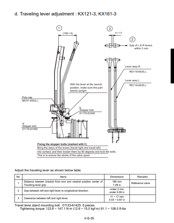

With the kx121 there is a fine speed adjustment for the levers. I would think yours would be the same.
woodman55
L6060HSTC, RTV 1100
May 15, 2022
730
522
canada
Checking the kx121. Kubota allows up to 600mm of drift off center in 10 meters of travel. Seems like a lot to me, but that's what they allow.
