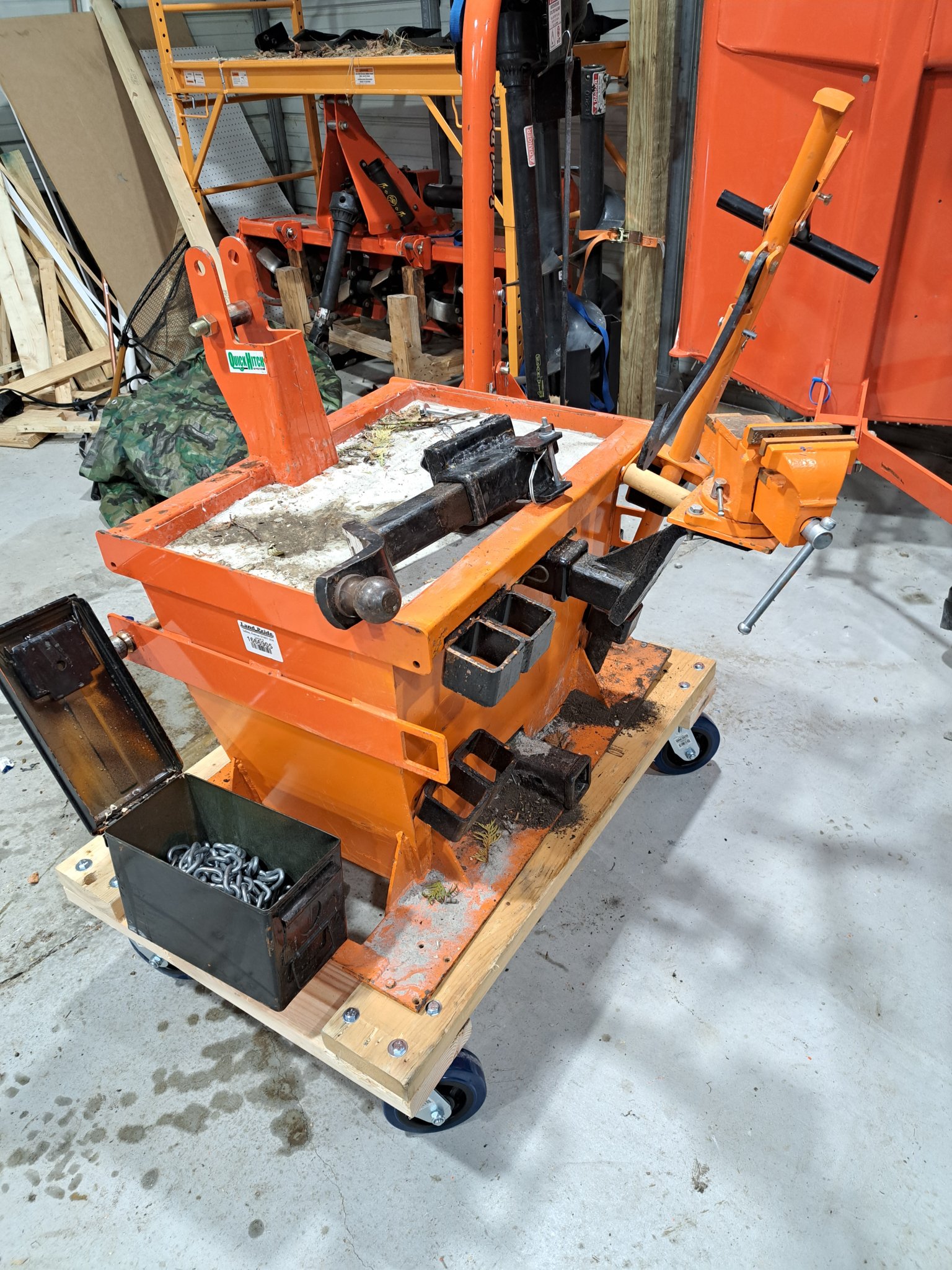

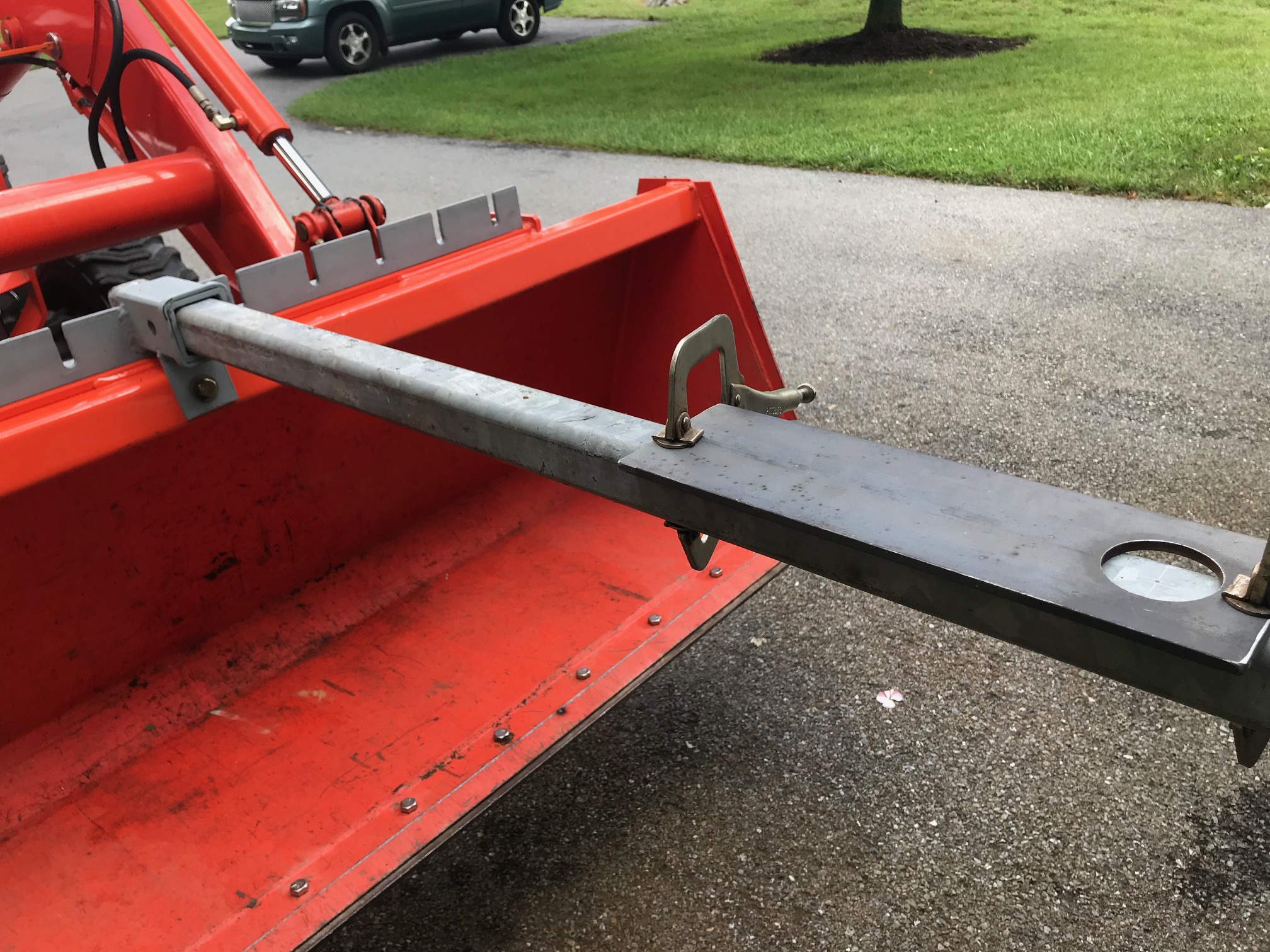

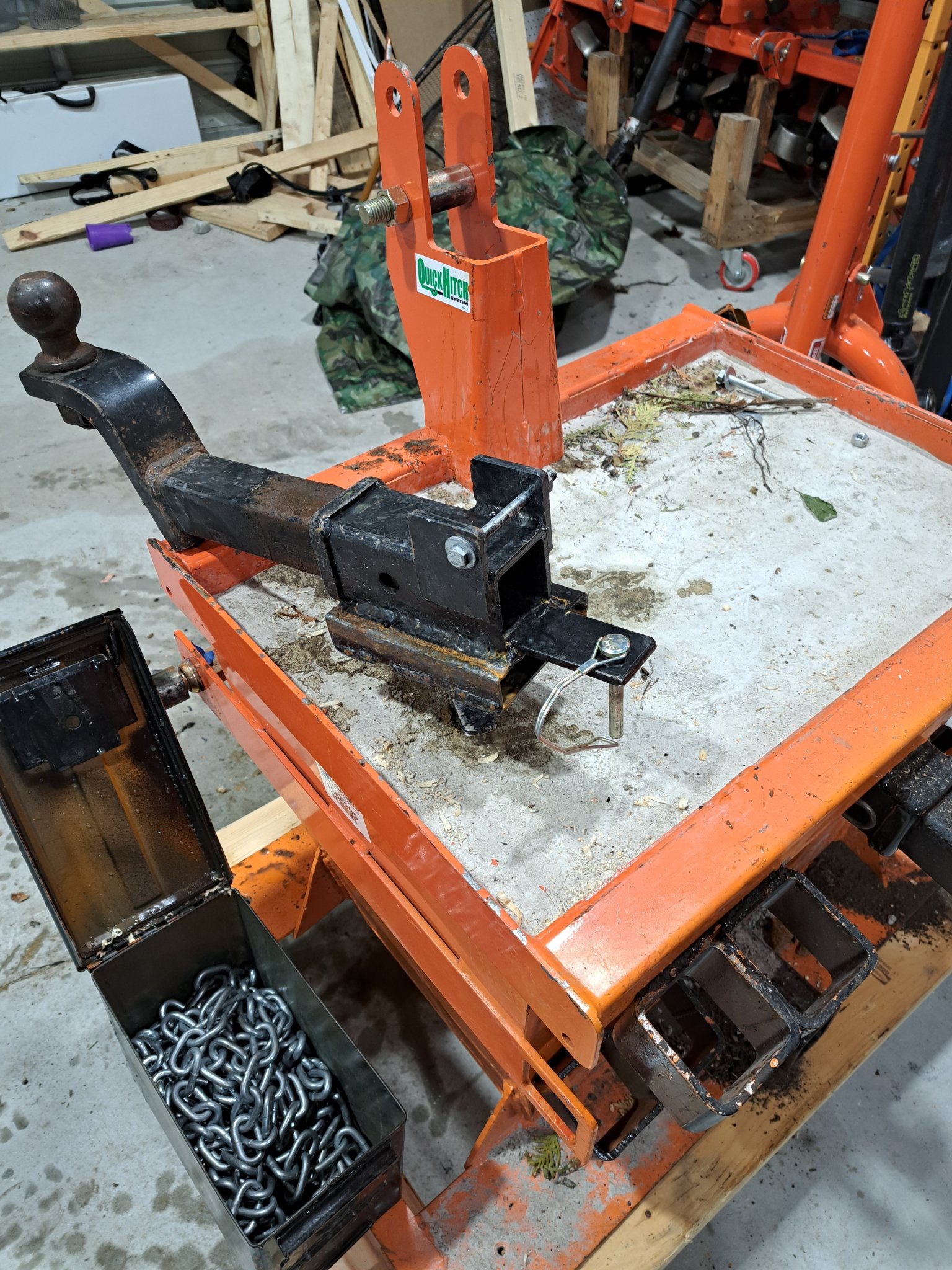

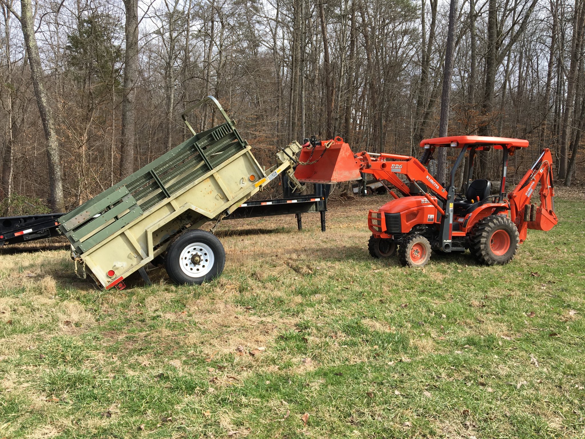

I weld a receiver to just about everything I have. (mostly because it give me an excuse to weld more...LOL)
Got 2 on my ballast box
one on my bucket that I welded on "upside-down" so that I can roll the bucket and get under the trailer tongue.
And I made this adaptor for it, to slide on my fork tip.
Got one on my grapple too. No pics of that though.

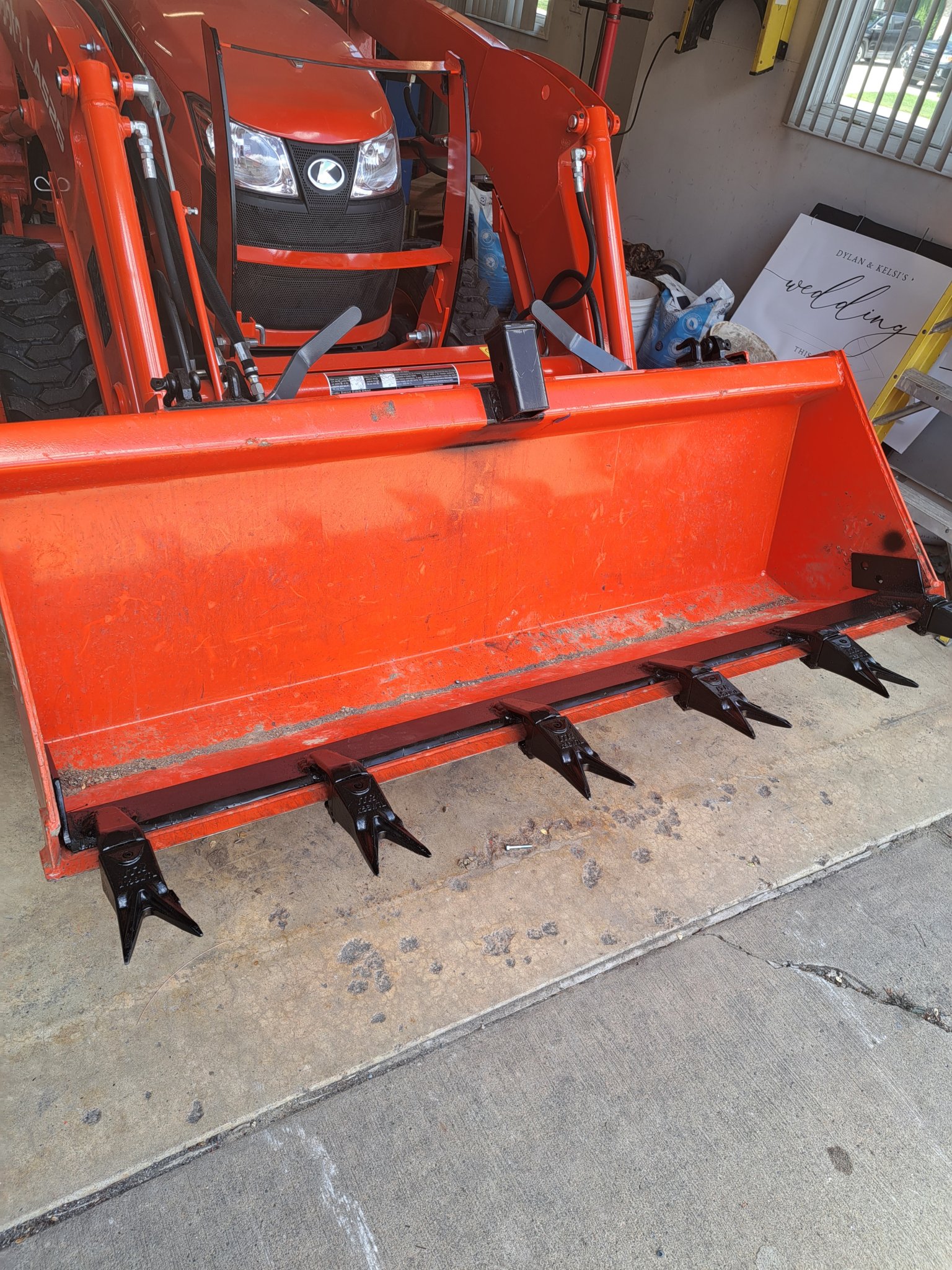

This is what I had for years on my B7200 assuming it was on the bottom cutting blade on the bucket. My new bucket on my LX2610 already had holes in the bottom edge so it was just a matter of bolting it on. I have used it to move a heavy loaded tandem trailer without any issues. Just a simple piece of 3" bar stock with two holes in it. One for the bolt and one for the ball.

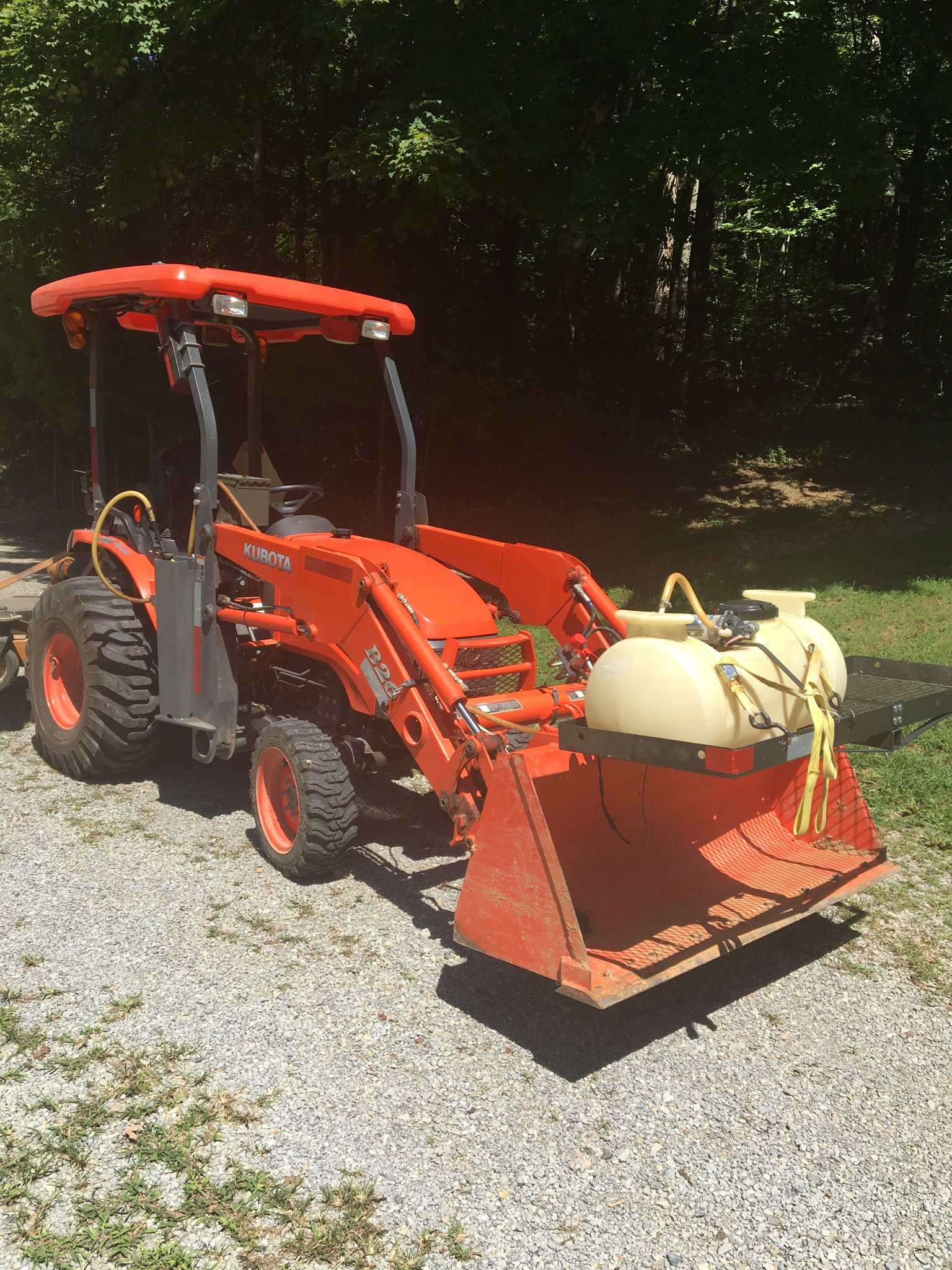

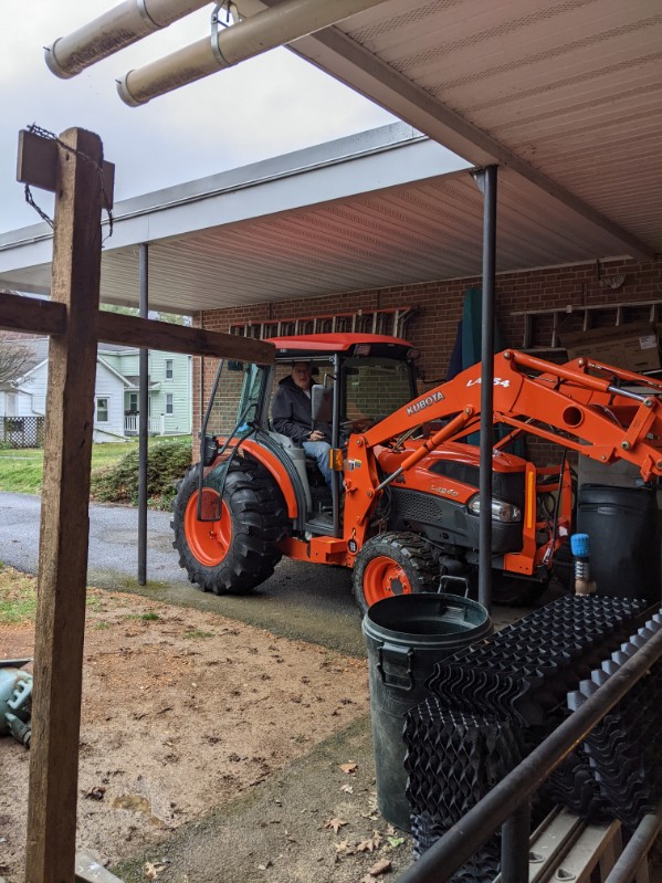

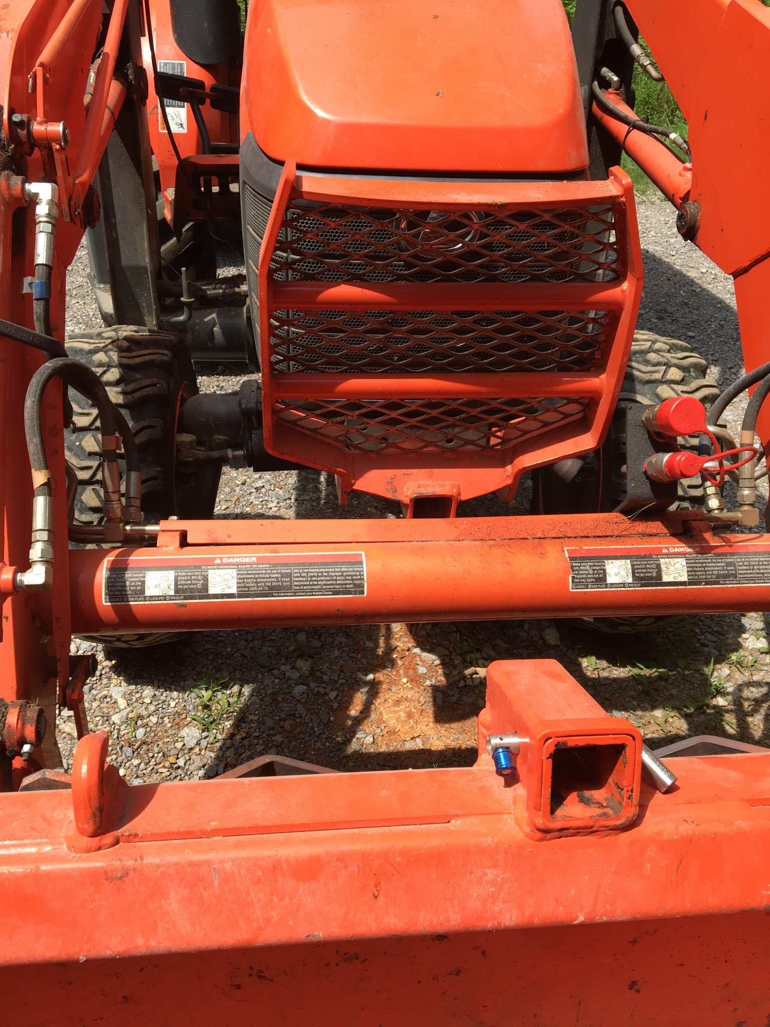

Most of the year the mower is on the back. There's a 2" ball on it that makes it easy to back it under the trailer or generator and pick them up to move them. Neither is very heavy.
The bucket mounted receiver doesn't get used very much as a trailer hitch. There's an adjustable aluminum hitch for when it does. The bucket can also be dumped a bit to get under hitches if they are borderline too low.

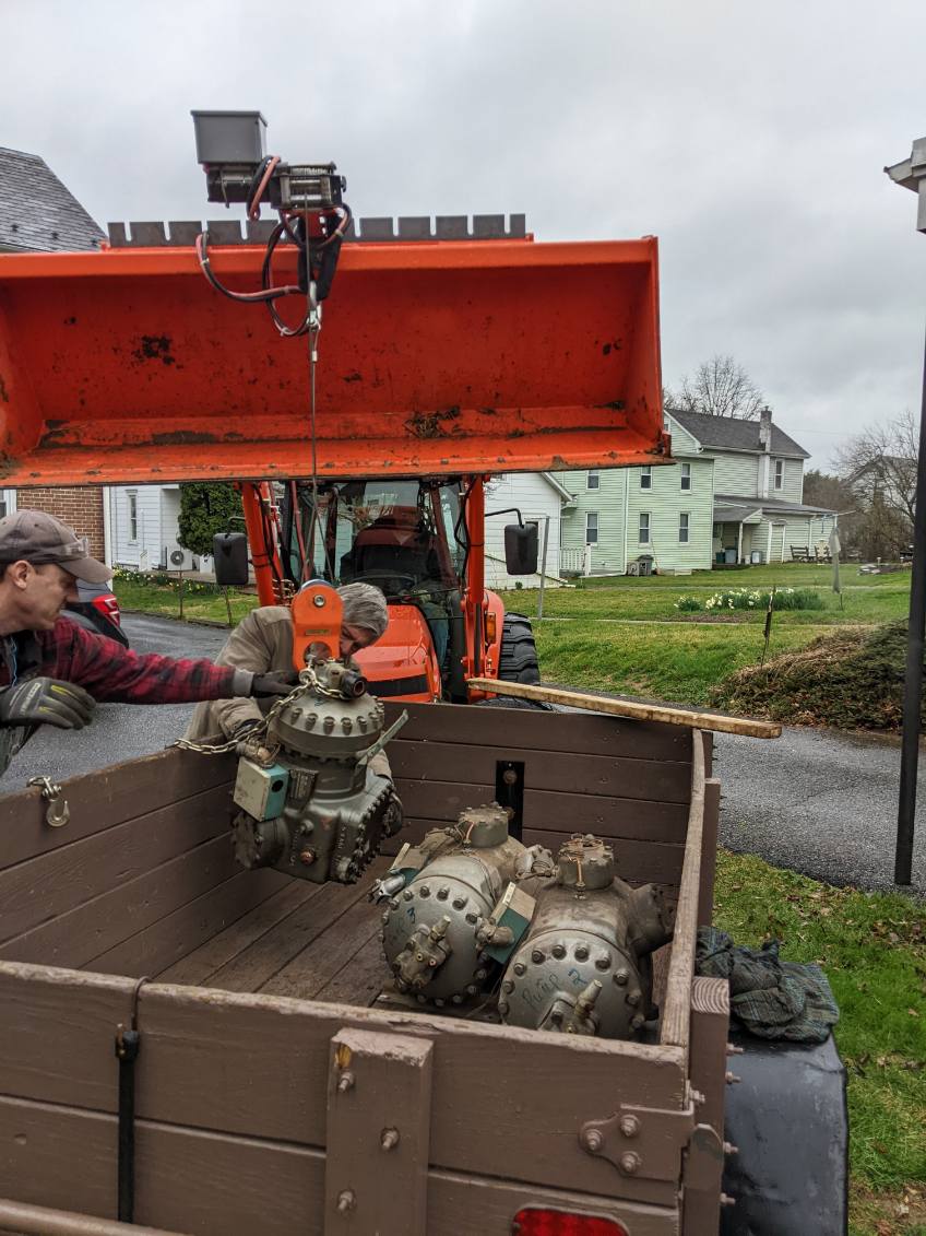

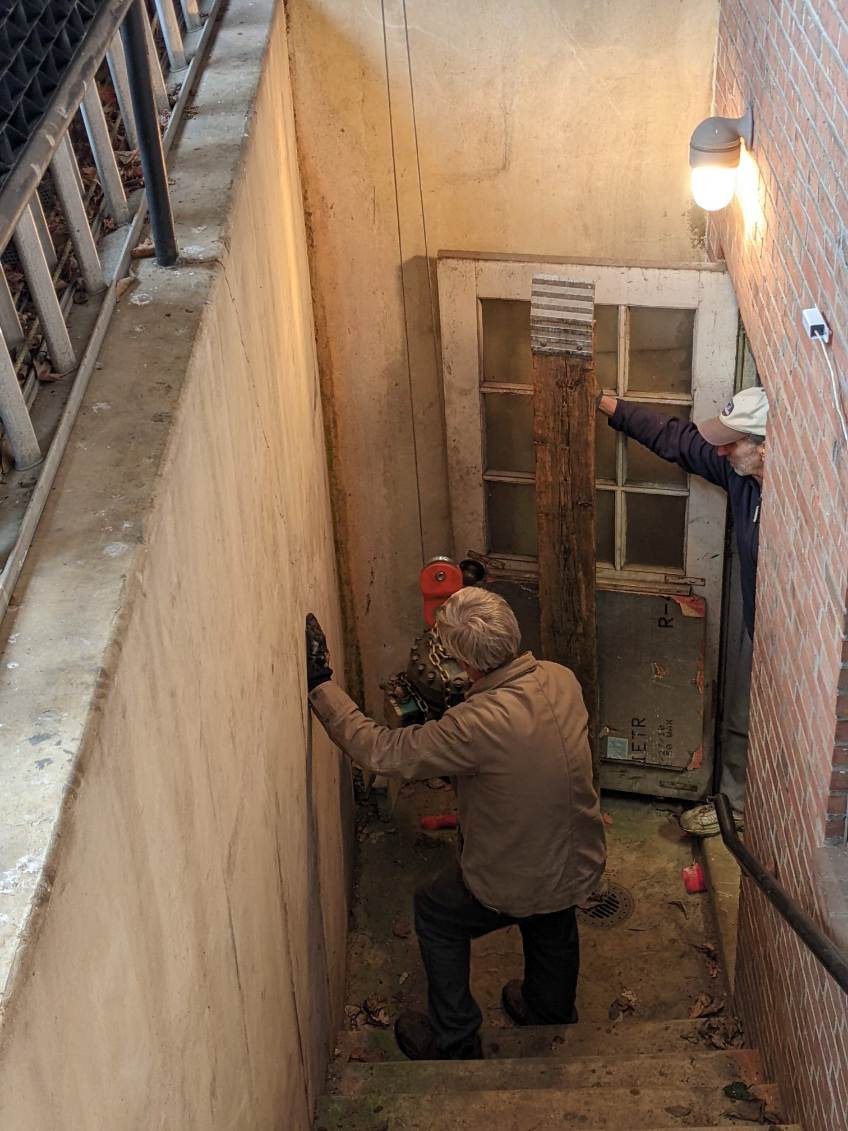

The bucket receiver is more often used for holding stuff to work on when I'm too lazy to roll the welding table out. The smaller winch mounted on a short piece of 2x2 that is handy for lighter work., such as removing a few 700# A/C compressors from the church basement in the lower pics. We needed almost 20' of lift to get them from the bottom of the stairs to clear a handrail at the top. There wasn't a lot of extra clearance between the roof and the bottom of the compressor when lifted to clear the handrail. Yes, the whitehaired guy habitually ventured into the danger zone (and this was before the tractor got its horn).

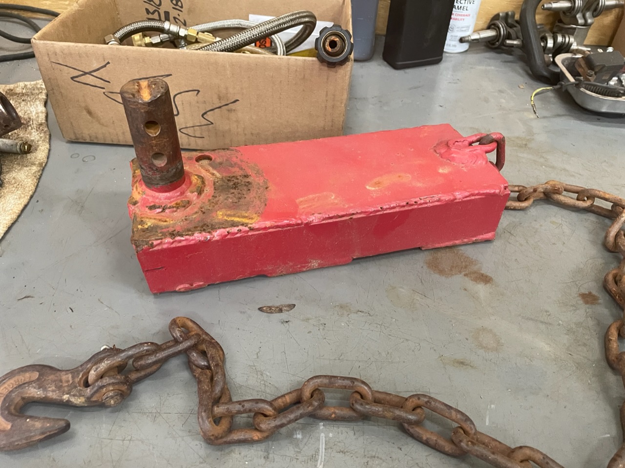

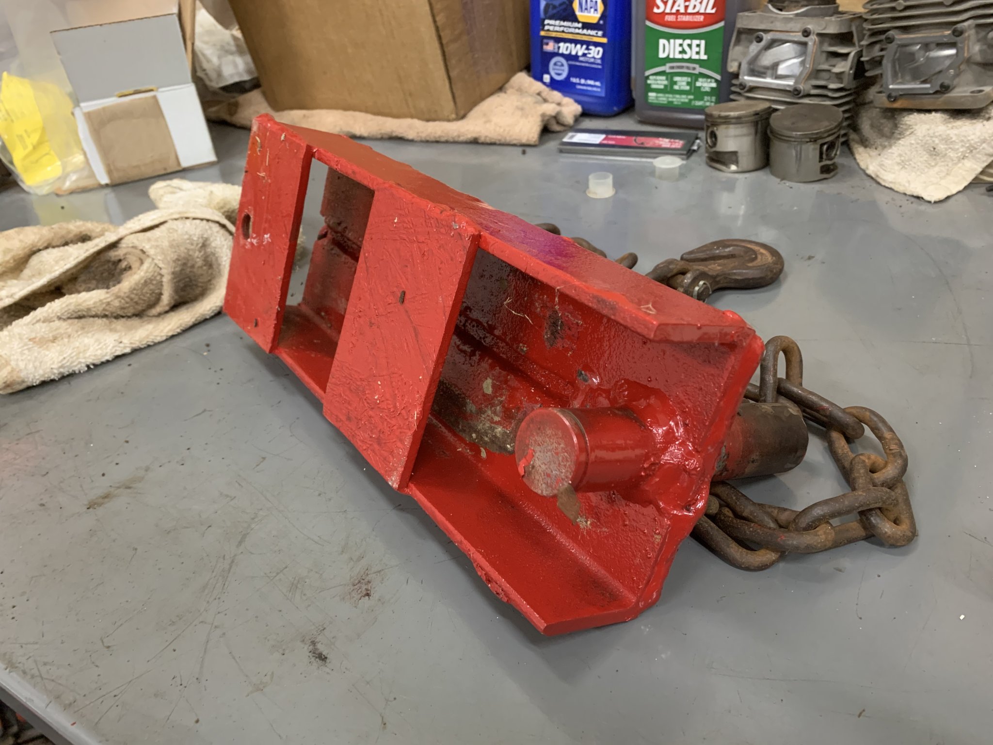

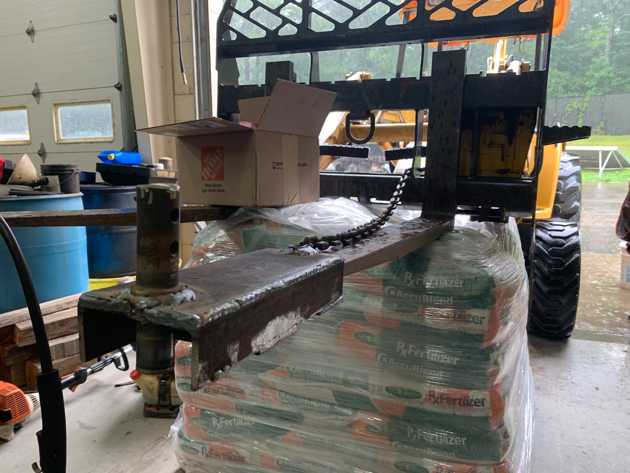

Made this up from scraps quick like at work for moving trailers around the yard. Works very well. A ball could easily be substituted for the pin. Though I have moved ball mounts with this setup.
