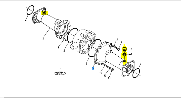

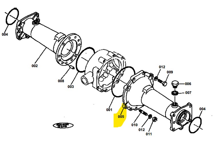

My parts manual lists 005 as front axel support. Cant find a lash. Also how do you get to the plug on top? Looks kind of buried. Another thought, might the squeaking be from the water pump bearing? (but it only squeaks when driving)
28,685
5,113

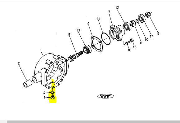

Here is what your dealing with.
Pull #11 plug, and install a grease zerk and grease the joint and see if that helps.
Any more than that will take some serious work.
I don't know of any plugs on top of the case just the fill plugs out by the tires.
Drain plug.
