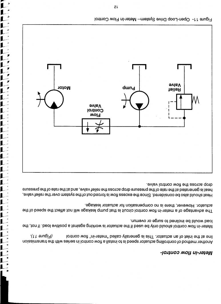

Milo I'm in agreement with Ed assuming a 20 GPM pump is mounted to your crankshaft. This is getting so interesting but expensive too. I had to knock the dust off my Hedland Fluid Power Data book and look at the formulas ( refreshing!) I want you to think outside the box ( open minded ). Open the attachment and look at what you are in effect doing to the hydraulic fluid in your closed loop open center hydraulic system. Even an open loop system would create heat going over relief with a flow control valve, i.e.: ( your 'Tee' back into the transmission ).
Last thought tonight on this Post .... at least 25% of your available crankshaft HP is being lost to Heat generation converting Ed formula to BTU/ minute = .00039 HP. ;) May be with an hydraulic oil cooler ( more cost ) and constantly working your cylinders ( hard to do this to keep heating rate in check ) it will live until your suction side collapses. :( Milo look at your overall goal with gpm needed with the work you'd like to do and size the system based on its restrictions. ;)

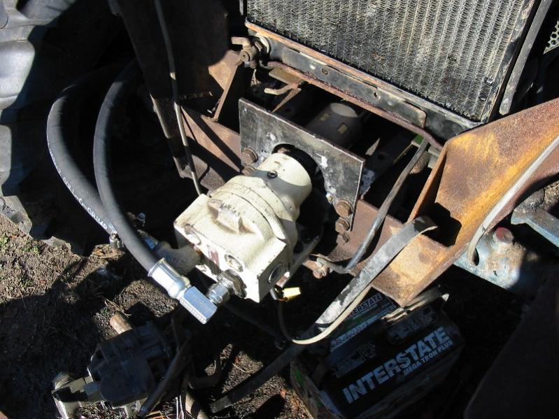

Milo Holroyd
1979 L245DT w/1700 FEL, 2003 L3130 HST,w/ LA723 loader,,and L2174A snowblower
Well, here is pump number 2. Engine runs it just fine.
However, playing with my loader valve, I noticed that the oil does not seem to go straight through the valve, when the spools are all neutral.
Shifting either of the spool positions very slightly, completely unloads the pump.
Otherwise, the pump is always working. (I wonder if that's what wore out my original pump?). :confused:
Milo

Sounds like you might have a closed center valve on there. If so it will not work! Some valves have a plug you can change to convert from closed center to open center. can you post a picture of the valve?
Ed

Further thinking about your tractor I'm wondering if you could have the power beyond plugged. Do you have three hoses to your tractor from the valve?
Ed
eserv
BX24, A1000 Kubota Generator
May 27, 2009
2,189
169
Hardisty, Alberta
Looks OK "B" is Pump "c" is Tank and "a" is power beyond. Wouldn't be something as simple as the three point hitch going to high causing it to go over relief? You should be able to move the rockshaft up 1/4 to 1/2 inch with the three point hitch lever right at the back. ( you'd be amazed how many of these are out of adjustment!)
