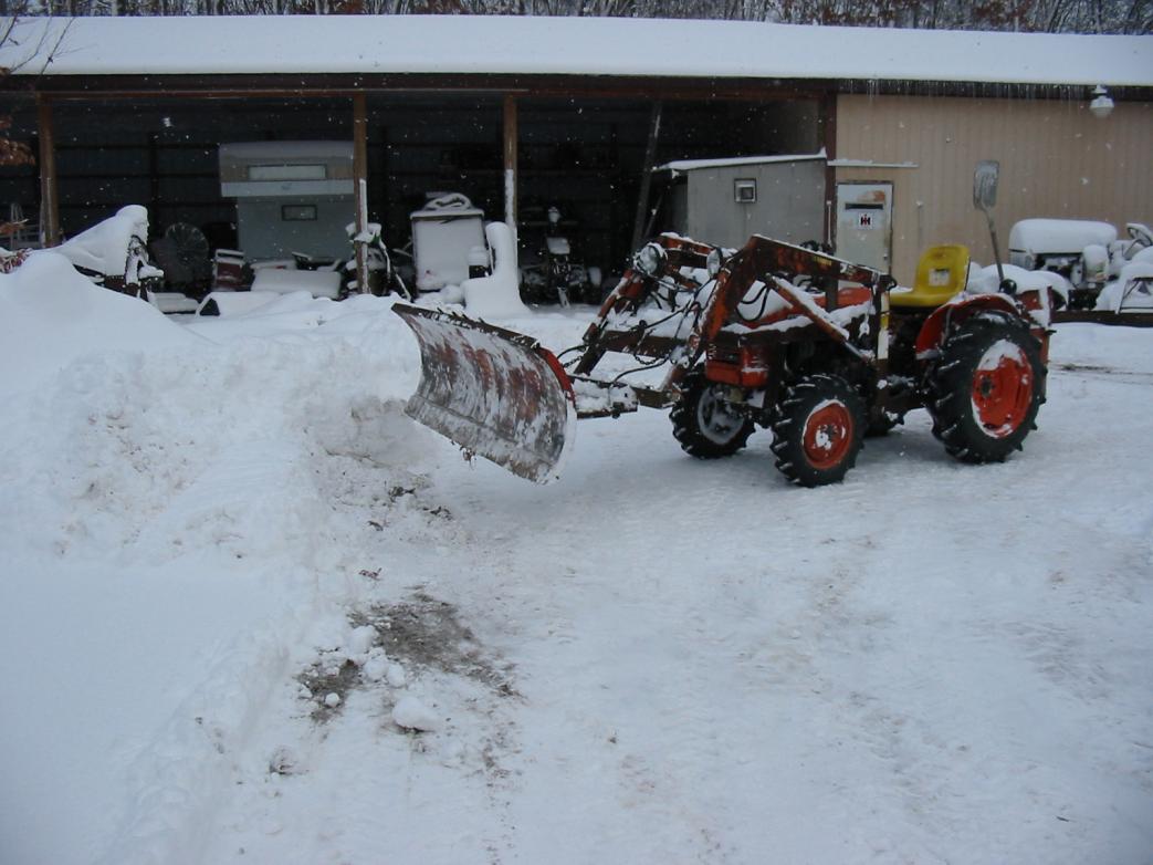

UPDATE4
I gave the new pump a good workout today.
Plowed snow for 5 hrs. Set the throttle at 2000 RPM.
The pump never got more than "warm to the touch".
Of course, the fact that it was 9F, may have helped that a little.:eek:
Milo
