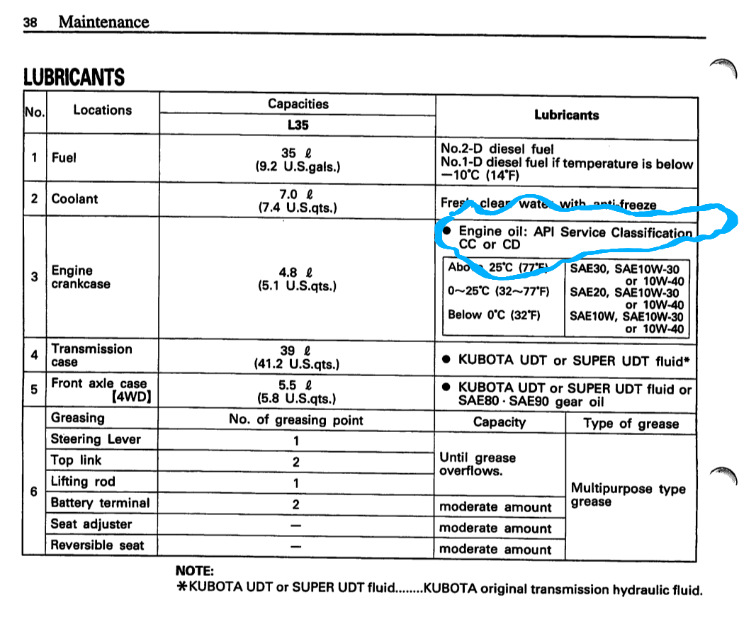

Doesn't your Lubricants chart have something like this?
You won't be able to get CD anymore, I think its up to CF now. But the C* classification oil is for diesel (Compression ignition). I've been running 5W-40 lately so I'm bending the rules.

That chart is older than Methuselah.
Modern formulations have essentially made grade 10W40 obsolete and replaced it with 5W40. It outperforms the old 10W40 in just about every way possible. You are not bending the rules much if at all.
