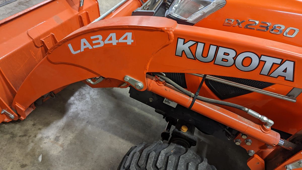

I've looked online, but not seeing any actual reviews of how well these things work. One video shows the extra 12" of height and another shows some dude with their "beta" version, but nothing showing how they work in the real world. Seems like a massive upgrade for us BX folks:

You can buy larger bore cylinders for half that. To get the added height you need a little longer stroke which increased the retracted length. My B7200 had no problem with the longer cylinders I put on it but I cant comment on a BX.
Bottom line is with increased bore and stroke you can put more weight higher in the air which is a good recipe for instability. I have an L3901 with LA525 loader and it already lifts more than I trust even with the much bigger tractor.
If I wanted to do something like that (which I dont) I would roll my own for much less.

According to the WSM the stroke on the stock lift cylinders is 12.8". You can get a pair of off the shelf cylinders with 1.75" bore and your choice of 14" or "16" stroke for less than $400. They will increase lift height and lifting capacity.
With the buckrt lowered and sitting flat on the ground measure the center to center distance of the bucket pins to see what effect those cylinders would have on the lowered operation of the loader. I have no way of knowing but you might be surprised.
Curious if you could post some links, and provide a bit more details? I am very curious to see your method in action, as well as the product these guys are selling. I understand the safety risks, but I would like both more lift height and more capacity, but understand combining the two at the same time (while in use) could be the area of safety concern. I'm looking for more height to lift only 250-300 lbs about a foot higher, and would like the additional lift capacity for dirt work, where the bucket is a couple feet off the ground.

There are multiple cylinders to choose from go get me the meadurementvI asked for and I will point you to a specific one.
The actual geometry of cylinders varies by design and different loaders may be more sensitive to differences than others. Several years ago I replaced the cylinders on a B1630 loader and the stroke on the replacement cylinders was slightly longer than OEM. The result is the boom goes a little higher (too high in my opinion) but it still works fine when lowered.

After watching the video the one issue I do not see being addressed with the longer cylinders is how it affects the digging depth. My LA525 on a L2501 is listed at 6.9 inches. As I have dug more than one pond and 100 yards of trench I would hate to lose it over a higher lift height.
