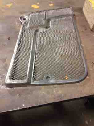

I sandblased my screens, but then i have a large blast cabinet. Makes all kinds of ugly go away.
Been using paint stripper, letting it set, then putting in a bucket of water and brushing it. I wished I had access to a cabinet. Would have made it quick and easy. Gotta straighten out the mesh in a couple of spots. And tweak the frame straight.
Same with the grill, and the grill that houses the headlights. Someone must have hit a tree with it. It was a little cross eyed :p:D
Gotta get me some new headlights before painting the hood. This way, if the mounts need to be modified, i can do it before painting :D

Got the hood and side guards steam cleaned. Now to hit them with 80 grit give them a rinse. Then they will be ready for some acetone and the rust preventer :D
Took a few minutes and knocked the expanded metal back into shape and straighten the side shields also

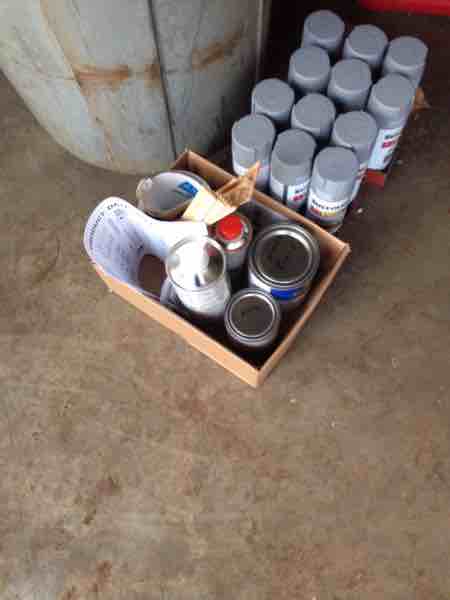

I actually looked at the magic stuff at tsc, and was not impressed. For one, the local store only sells the reducer. Doesn't sell the hardner. When i pulled the info from majics website on my phone and showed it to the folks at tsc, they got the deer in the headlights look. Immediately decided to pass on it ;)
There's a place I'm gonna check locally that sells automotive paint and the works that goes with it. I just forgot to grab a couple paint chips so they could mix me a close match :D
Coworker has a high volume, low pressure sprayer I can borrow for the job.
Got quite a bit of blocking and priming to do between the hood and fenders :rolleyes:

I went looking for automotive paint after work and was really surprised. For giggles I stopped into the local Sherwin Williams store and inquired about there products. They didn't deal with auto paints at that store. But had an automotive paint supply store across town.
So I stopped in, told them what I was doing. And needed to see there paint swatches. Now here's the surprise :D They had kubota Orange 1 and 2 :D:D and the colors for all the other tractors and construction equipment as well. Guess it never hurts to ask ;) They did not have the kubota grey or blue. So I flipped through till I found a close match to the blue on the motor and frame.
So, for $150, I got a quart of single stage acrylic enamel kubota Orange number 2, a pint of Komatsu blue :eek: the reducer, hardener, and all the fixings to mix it accurately, stirring sticks, and strainers :D
