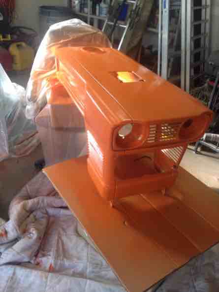

Start painting tomorrow :D
Gotta finish masking off some areas. Hit some spots on the frame with primer. Primer sets up in a half hour. After that, I can cover the frame and shoot the orange. Then Sunday I'll mask off the dash and shoot the blue :D

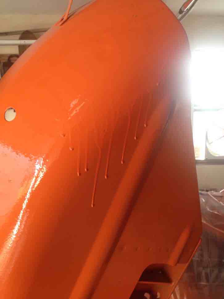

I wouldn't recommend the Sherwin Williams paint :Mad:
Color came out looking good. But before reducing per instructions, that is some really thin stuff.
I'm sure it's a good quality paint system. But dang, that stuff is finicky. Hard to get good coverage. And runs really bad. Gonna have to let it cure. Get another pint of paint. And sand one fender down and start over. The rest is passable. But definitely not happy with it :Mad:

Here's so pics. I'm done writing a new dictionary on cuss words :rolleyes: Fixing to get an adult beverage or two, maybe three :D
Here's how it came out.
Hoods good, dash is good, rims are good, plus the side panels. One fender came out nice.
Then you have the fender that got me cussing :mad:
Gotta sand down the grill for the hood and redo that as well.

Bill, your restore was more in depth then mine :D The fender really made me sick. Was so hoping to have the majority done tomorrow. Now I gotta start all over on those two pieces :rolleyes:

I think I got the paint issue figured out. For one, I was off on the mixture :rolleyes: Had enough hardener, but not enough reducer. The other issue was to large of a tip. So I'll really pay attention tomorrow when I shoot the blue. Then once the paint sets up on the fender, I'll sand it smooth, and shoot it again later in the week :D That's after picking up a finer tip :rolleyes:

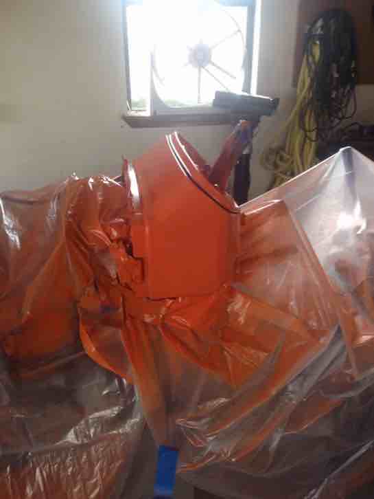

The second time sucks!!!! But at least I got much better results with the paint :D everything that needed to be orange is orange :D Gotta let it set up for twenty four hours. Then I can mask the dash and paint the blue :D:D Not gonna post anymore picks though till its back together :p Keep ya'll in suspense :cool::D:p

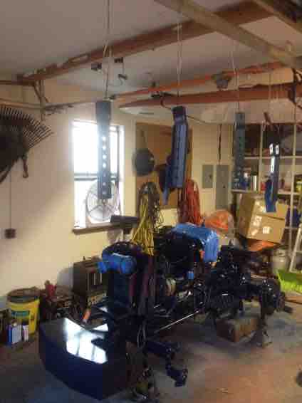

Orange parts are all orange :D And......... The blue is on the rest :D
Hodges stabilizers came in. Requested the primer only so I could paint to match.
Mark did a fantastic job making them. Hated to scuff up the smooth primer job. But they got painted as well :D
He had great timing too, since they were sitting on my door step tonight :D
Here's the booger'd up fender after fixing :D
And hood with the grill installed
And yes, that is actually a blue on the frame ;)

MAN! Look at the shine on that forward weight box!
This is gonna be awesome!!!
10,512
7,589
Thanks guys :D The blue was much easier to use :D If it looked like a smurf with measles, it needed to be gone over again :p:D

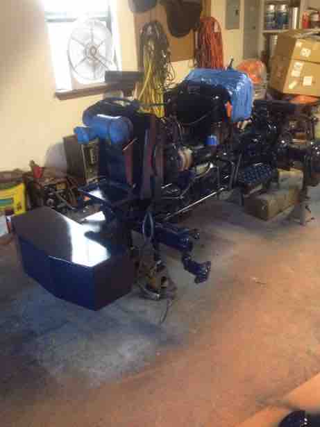

She's orange and blue :D and looking like a tractor again :D:D still got some odds and ends. Paint the handle black. And mount the hazard lights. Make up some wing nut bolts for the side shields. And mount the head lights.
First time a bird uses it for target practice I'll be in the back yard hunting tweety :rolleyes:
