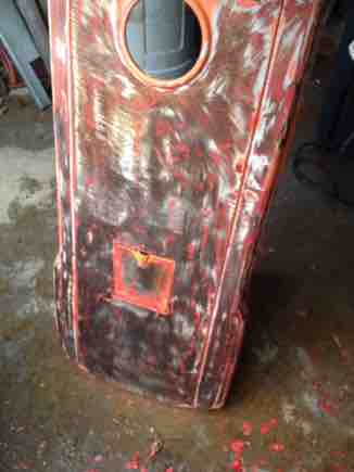

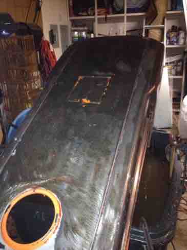

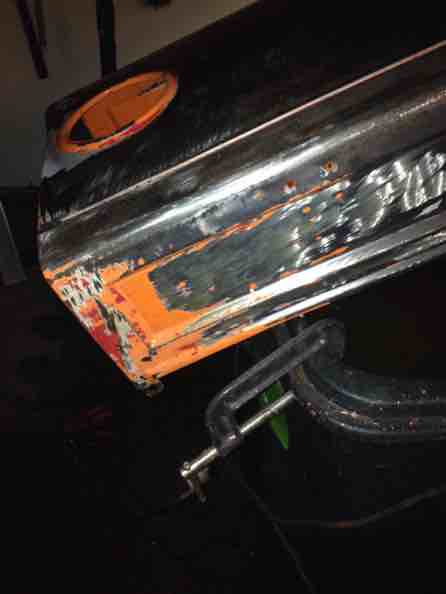

Here's some pics of bare metal :D
Paint just pealed of with a scraper :D

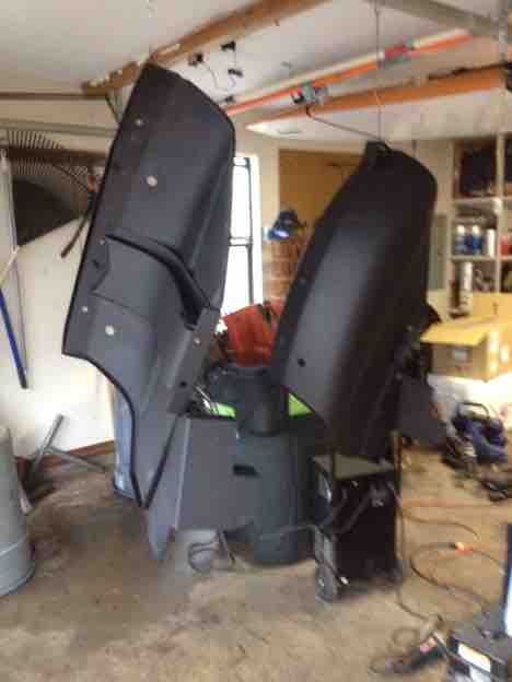

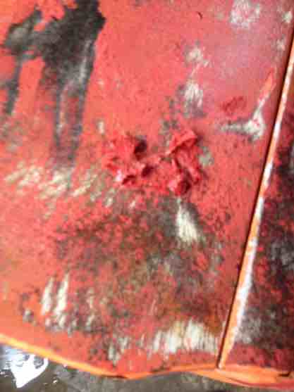

Hit the fenders with rust oleum rust reformer. Stuff has to set for 24 hours. Then I can move on to primer :)
Got some dimples to fill and wet sand where the rust was real bad

Paint just pealed of with a scraper :D ...
Just for clarity since there was some discussion on paint remover....... are you saying it Peeled off after coating with Dippity-do gel paint remover..... or peeled off after electronic tank dunk?
10,513
7,592
The electrolysis started to remove the paint ;)

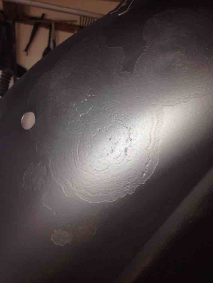

I promised an update after adding a stock tank heater to the mix :D

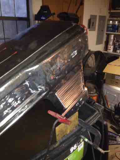

So........, here's some bare metal picks.
I have some spots being stubborn. But I'm gonna let it cook for another 24 hours and check it again.

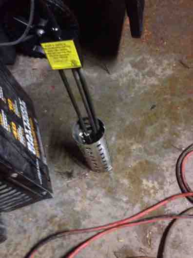

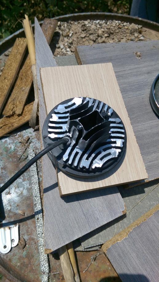

Here's what I used for a heater. It actually heats the water to 180 degrees. So it could be the heat loosening the paint up. I didn't let it heat to 180. Just to bath water, and then unplugged it.
The heater is designed for a five gallon pail and has a shield to protect the plastic.
I used a stainless steel scotch pad, welding brush and scraper for the stubborn spots.

man that is smooth as a babys ass!! LOOOKIN good brother D !!!
Now........is this goonnnna be a rattle can paint job???? OR you got something up your endless sleeve as to how to paint it????
YOU do know that you can electroplate paint too!!!!:eek::D:)

Here's what I used for a heater.....
The heater is designed for a five gallon pail and has a shield to protect the plastic.....
How did you keep the process of electrolysis going on from attacking the bucket heater?
did you measure the rise in temperature? I have one of those and attempted to use it to warm bathtub water while my hot water heater was out. Came to the conclusion it would have taken 24hrs at least to get bath warm water.
7,765
2,958
Before my cabin was plumbed for water supply but plumbed for drains & also wired, I used to use 5 gallon buckets to fill the tub with water from the outside hydrant. (about 40F water temp) I would then drop in two of these quartz tube heaters & in about 4-5 hours, have a nice warm bath to relax in at the end of the day. I'm sure they (or something similar) would work for this purpose, (maybe too well) and no metal to complicate the process. I'm currently experimenting with this process, and it seems to be working well without heat, but if I change my mind, it will take a trip up north to recover them.
