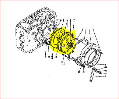

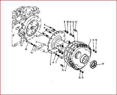

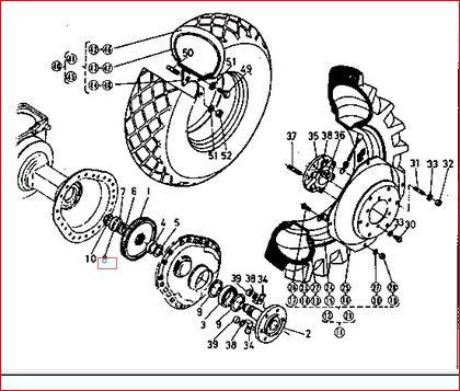

Hi. I've got a couple of issues with my old kubota.
The first thing is I'm getting oil dripping from the rear axle / hubs. I haven't looked to see the problem yet but could anyone tell me do these tractors have oil in the hubs? Or should they be dry when I take them apart? I assume if the hubs should be dry the oil is leaking from a seal that the drive shaft goes through, is this correct? Also are the brakes housed in there? Or are they in the actual axle?

I'll send you a link to download the WSM for the L245, that should help you out.
Yes the hubs and axle housings will have hydraulic fluid in them.
