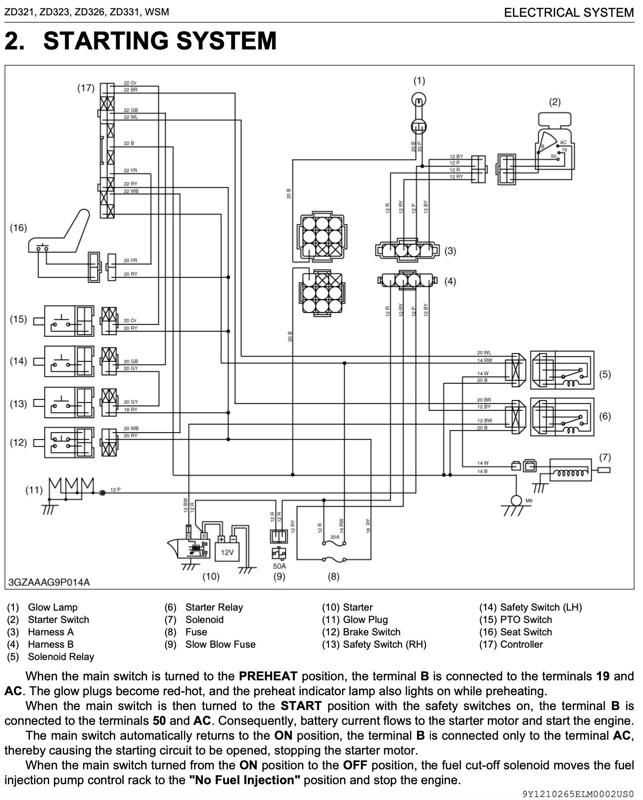

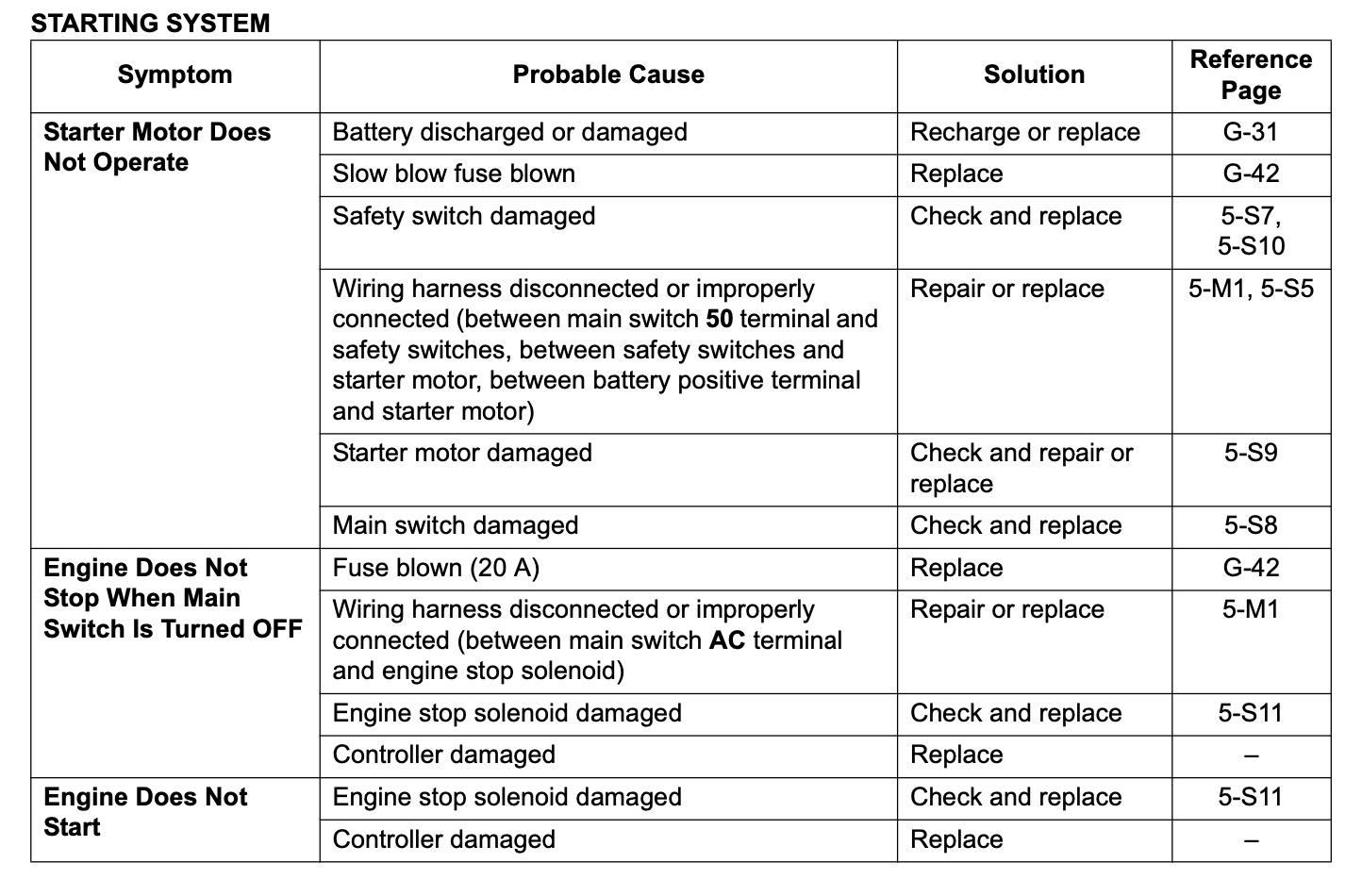

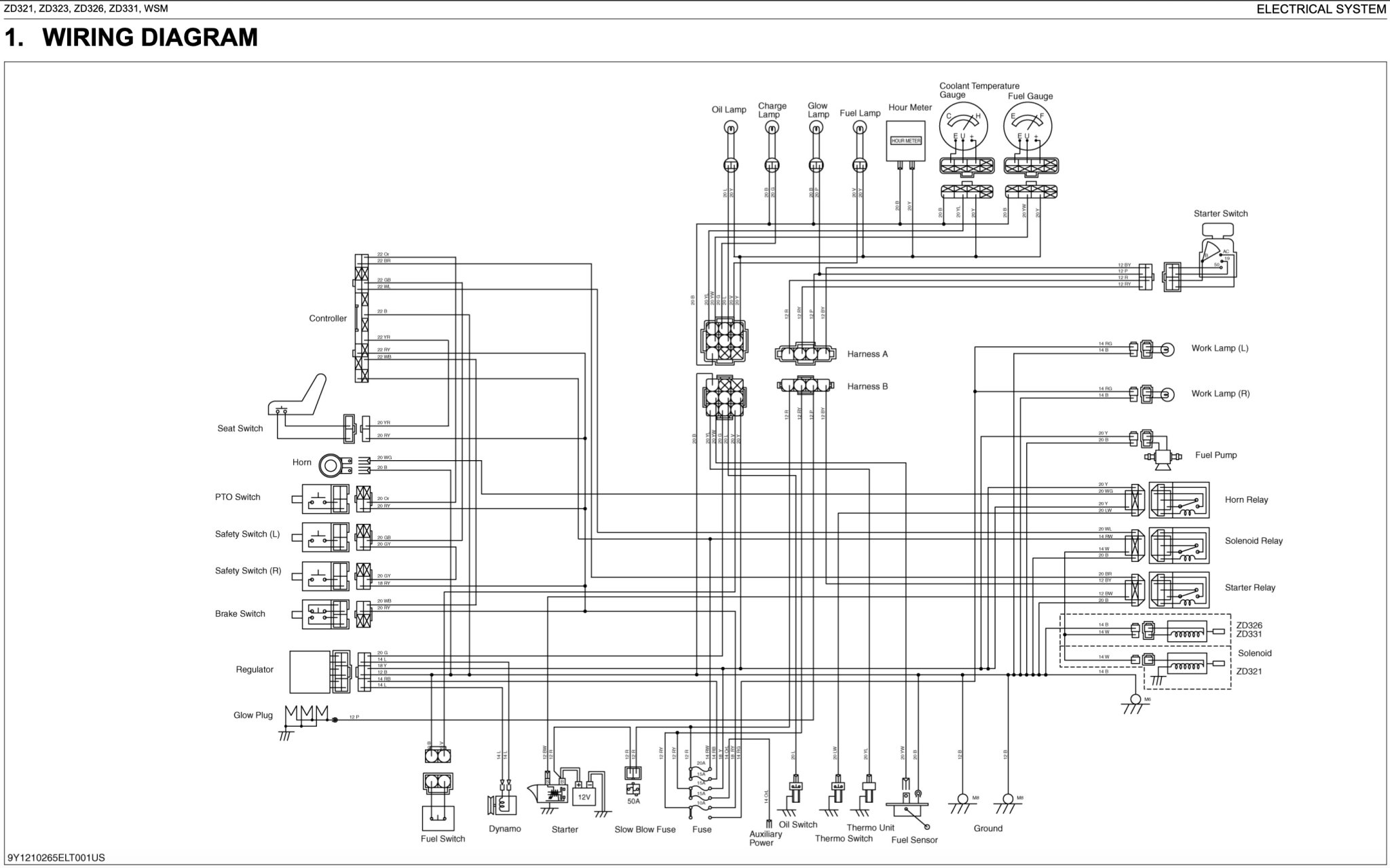

I have attached a couple of Kubota documents which may or may not be related and of help.
I have not studied them for a long time hence my caution.
If, after you have looked them over you have questions, please ask and I will try and get back up to speed.
Dave
Dave
Dave,
Those are for gas-powered units so very little information on them would be pertinent to a ZD300 series diesel unit.
