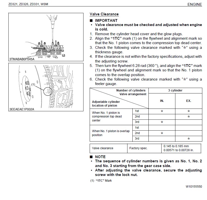

Last question the timing marks are clear on the flywheel the WSM speaks of an "alignment mark" the WSM is clear as mud where is this illusive mark? I set valve gap the old school way would like to know where the alignment mark is for future reference.
The WSM seems to have a very accurate depiction of the timing reference mark. Look at picture B in the pdf.
Thank you. Your drawing was clear however the one I have isn't. Additionally I looked for the 4-bolt pattern hole in the casting the back of the case is smooth, the left side and right side do not have that connection if it does exist it must be on the bottom which is covered up in steel that supports the rear of the mower and is not accesable. Note the lack of the note regarding the alignment mark.
Thanks.
