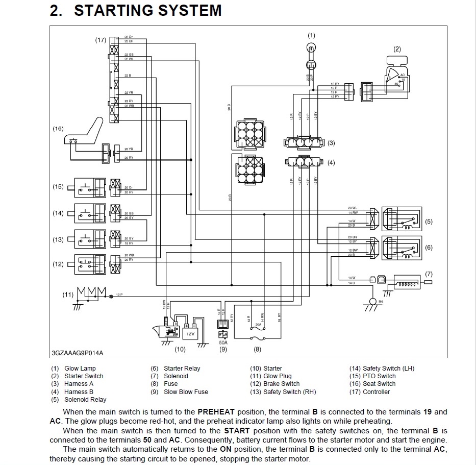

Here is the start circuit wiring diagram and operating logic.
Where did you get the safety switch you bought as Mikester's comment makes a lot of sense

The brake switch ,#12 above, is a Form A and Form B switch, has both NO and NC switches in one package.
If you somehow installed connector 'upside down', you'll get the posted problem.
