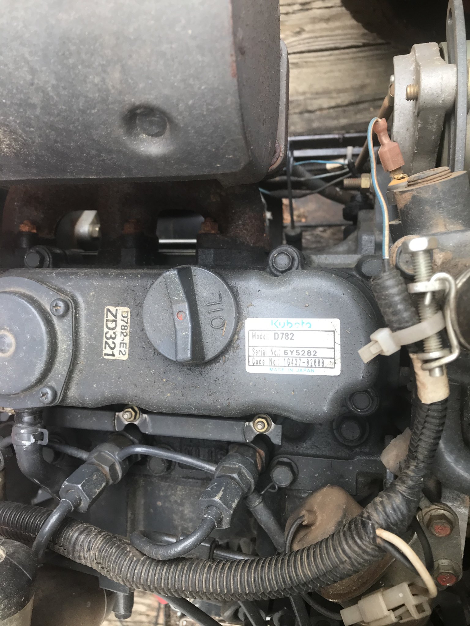

Purchased a zero turn ZD321 with D782 engine. Engine has knocking sound. Afraid to run it as I don’t want to cause more damage. I unsuccessful in posting a video with sound but will try to add somehow. Hoping someone with experience may be able to steer me toward steps to take to diagnose and repair. Thanks C2850398-BDC5-4C9F-837E-FFFFE0EF9E02.jpeg

Nice picture. But no video?
if it's knocking do a compression test. That will tell you the condition of the cylinders. If low (under 400 psi) you will want to pull the head and inspect the cylinders and piston tops. You may find poor cylinder wall finish, maybe some metal transfer-look particularly at the center cylinder. If you do find that, you'll probably want to pull the engine and go through it.
