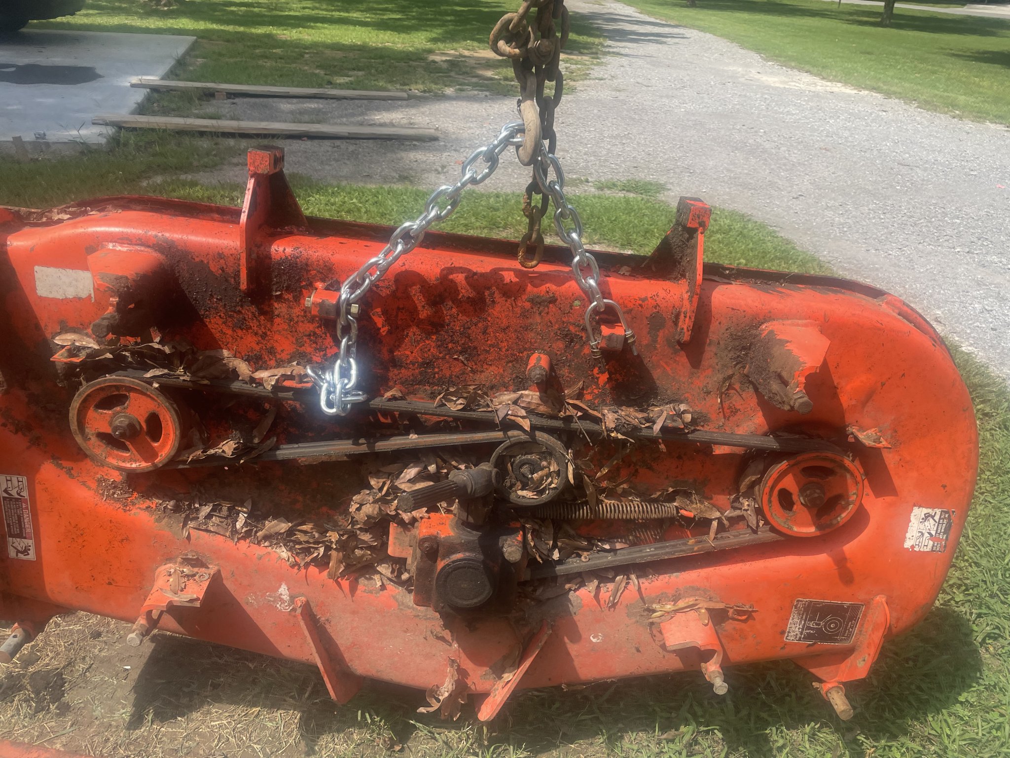

I think it’s broken something in the hst. If it’s running and you push the blade handle forward it acts as if it’s under extreme load. The last pic is of a deck I have that is rusted completely through. It appears that the belt is routed the exact same way. You are correct the blades do not turn like the deck that is shot so I’m wondering if I messed up the pto in the hst or the gearbox on the deck.

I think you should get the deck off and see if the tractor is still fine. I don’t think you would have damaged the tractor by putting on a deck belt.
The deck might just be so messed up that the tractor can’t spin the deck (like trying to start the deck from stand still in really tall thick grass would stall the tractor).
Since you have the spare deck you can just move good parts from that deck to the good sheet metal deck and get back up and running?

I found the problem the gearbox on the deck was the culprit. It was I think the small belt snapped something inside. I haven’t looked at it but the gearbox literally fell apart when I started to take off the deck.
