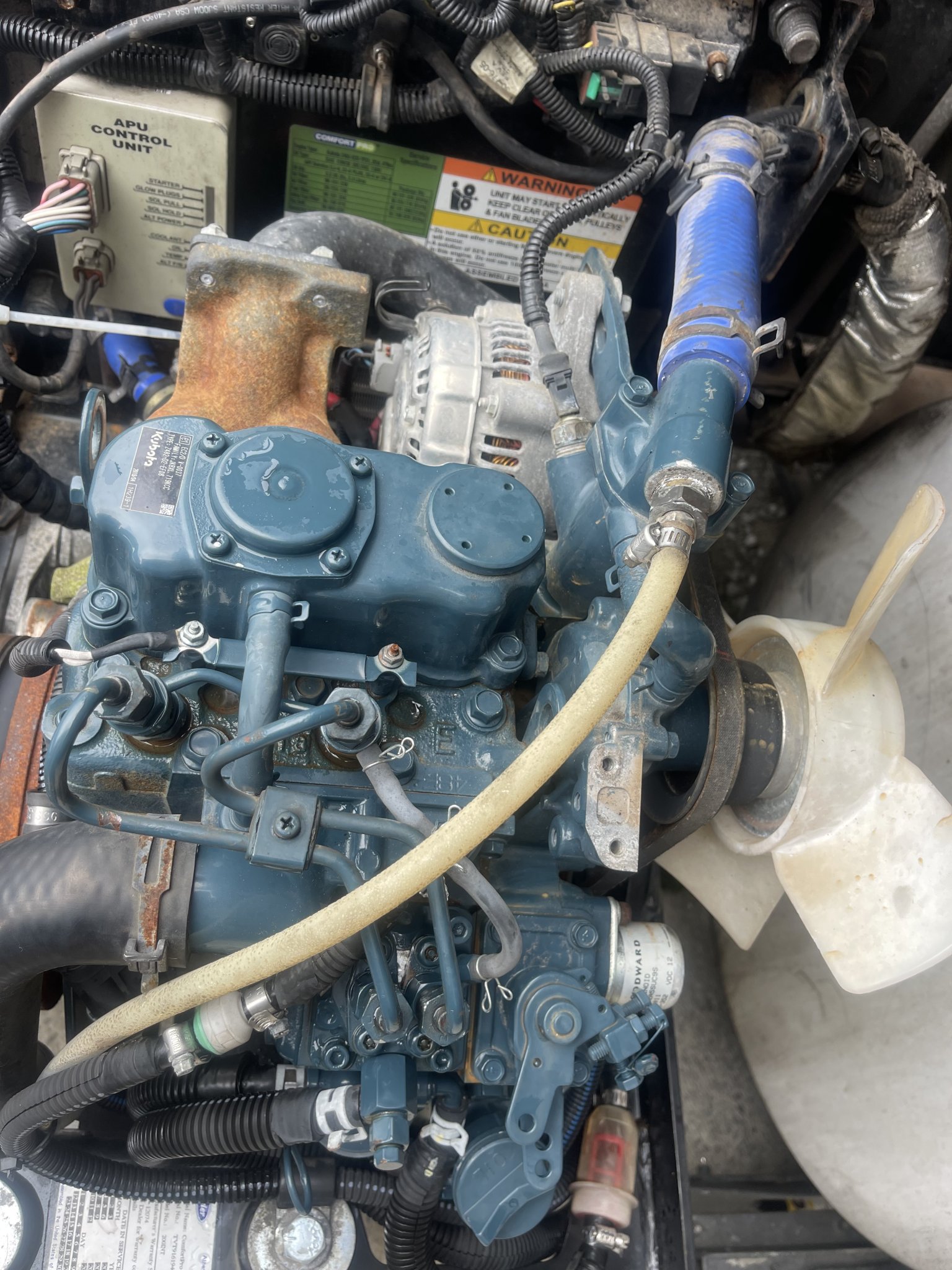

I have a carrier APU powered by a Z482 kubota engine- I have a crack in the thermostat housing- but looking at it there’s a bolt behind the housing the water pump mounts into- looks like that housing is part of the front cover assembly- do I really have to pull all that off to get to 1 bolt to change out the thermostat housing???

Would need a picture of what your dealing with as I don't have a readily available manual for that engine

From what I’ve found so far- looks like either pull the head or drop the oil pan and pull the front cover- as much as I don’t want to if that’s the only two ways I’m thinking pull head- I’m just hoping there’s some truck I’m not finding to get this housing off without doing either

Thanks for the pictures!
Yes you will have to either pull the head or pull the gear case (timing cover).
On most of these it's easier to pull the head, less parts to have to remove to get to it.

that’s what I did- of course my local Kubota couldn’t look up the parts because it’s not in a tractor- had to order the new thermostats housing and a head gasket from Carrier in Nashville 100 miles away-
but I’m getting it figured out- now just need to find the specs to reinstall the head- torque setting and pattern for the bolts- and the valve adjustment setting and torque-
