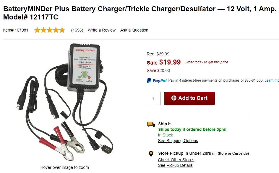

I bet I have at least a dozen of these BatteryMinder units. Motorcycle, quad, tractors, everything I'm not driving daily is hooked up. In my experience these things have doubled the average life of my batteries.
But I don't use the alligator clips the units come with. I install leads on each battery so I can plug in without having to physically access the battery. Much handier - makes it that much more likely I'll plug in when I park the vehicle.

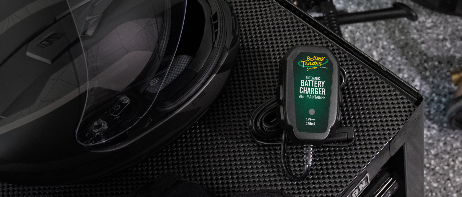

For my Optimas:
(Lil Foot, Rhino)

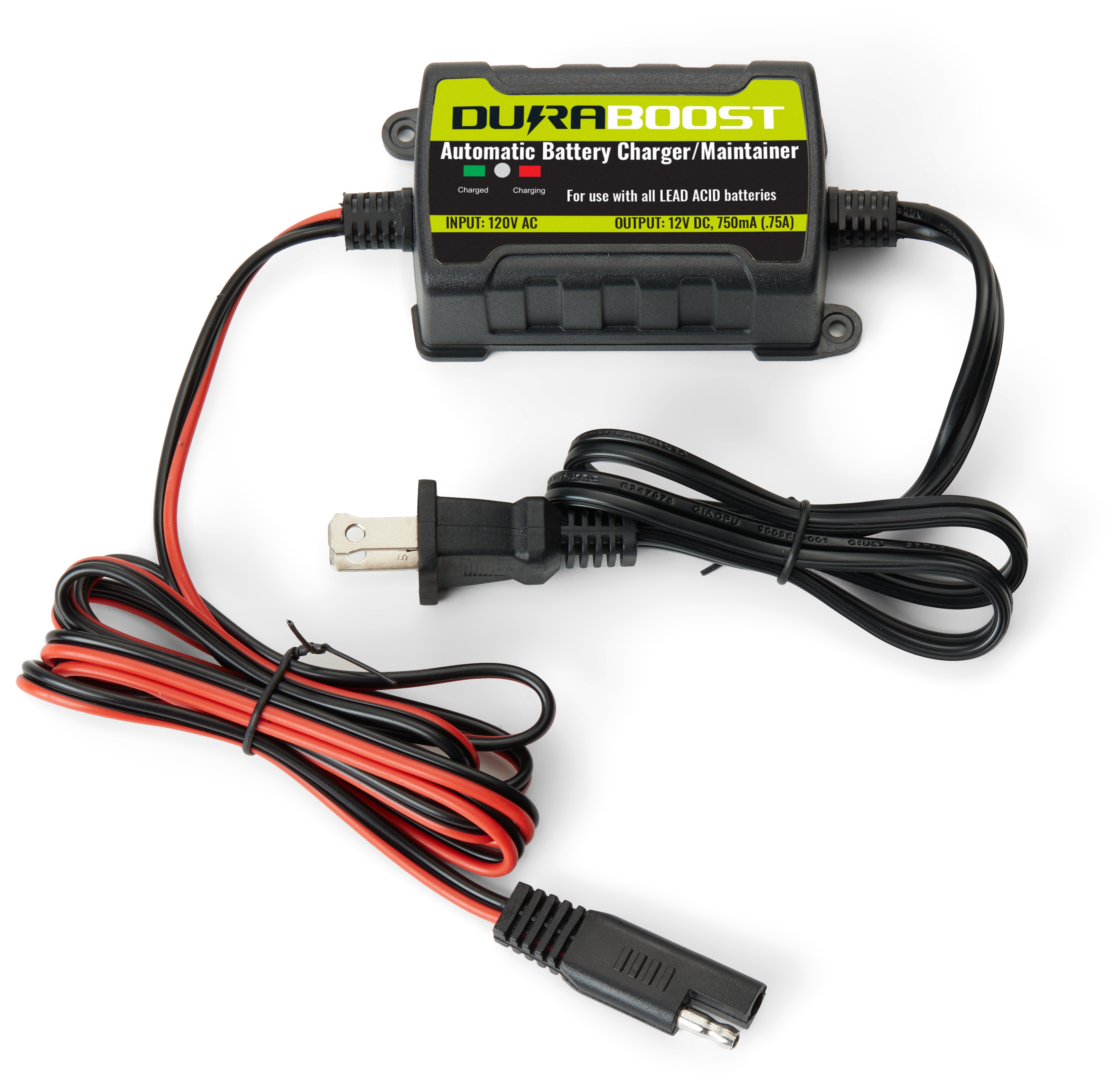

For lead acid:
(B7100, Mini Ex)

some rough math....based on the unit in post #21 ( 12v/1A ) and tender being used full power.
It produces about 12 watts of power, so maybe 20 watts out of the wall...accounts for line losses, efficiency, etc.
My electricity costs me 20c /KwH. Change this for your rate....
1Kw/20 watts = 50 hours, round down to 48hrs = 2 days.
1Kwh costs me 20 c, so that's 10c per day, so $36.50 per year
Reality is the tender won't be fully 'on' every hour of every day , rates vary with temperature and battery condition, etc. so could safely cut the cost in half, which becomes $18.25 per year.
If you get 3 years extra life out by using it , it's cost you $55 +-.
Say new battery costs $210 ( none are cheap' anymore.... and you get 7 years out of a battery
3 years of battery is 3/7X$210 is $90.
So... it cost you $55 to save $90.
As I said rough math and numbers will vary . Mr. Sun still isn't up ,so feel free to tweak the numbers.
