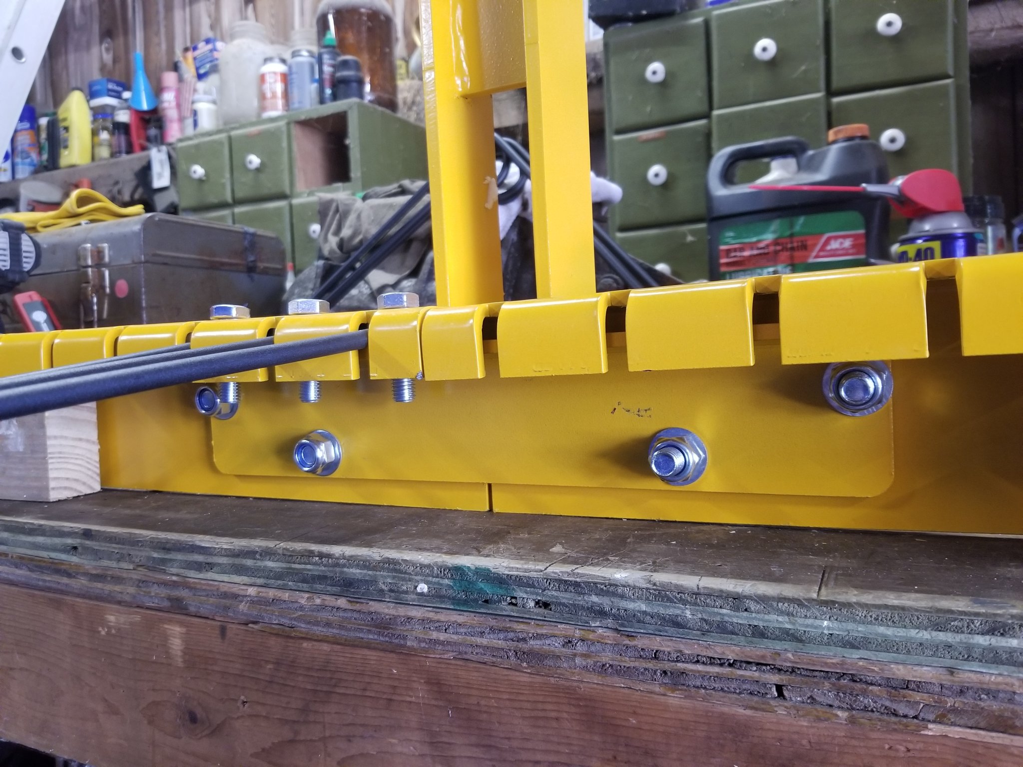

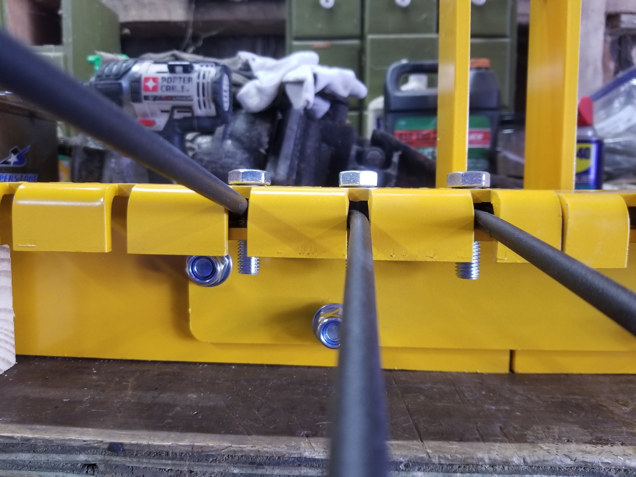

See attached. Thanks Bee-Positive. I did indeed undo step one, but as you may be able to see, there is too much of a gap between the plates and the tines just flop around (see photo 005). That's why I think the holes were not drilled correctly when manufactured.

I think you will have to put the nuts on the vertical bolts and then loosen the horizontal bolts. Tighten all of the vertical bolts up. I would start at the center and work back and forth across towards both ends to pull it tight in steps. Then tighten up the horizontal bolts (if the tines get tight).
You may be able to add a washer (spacer) between the tine and the top side of the tine to take up the space you show, if you need to.

I was being an idiot. I came to the same conclusion Russell and everything tightened up proper. Thanks for putting up with my unfounded rant. Lots of knowledge on this forum and I appreciate the responses.
