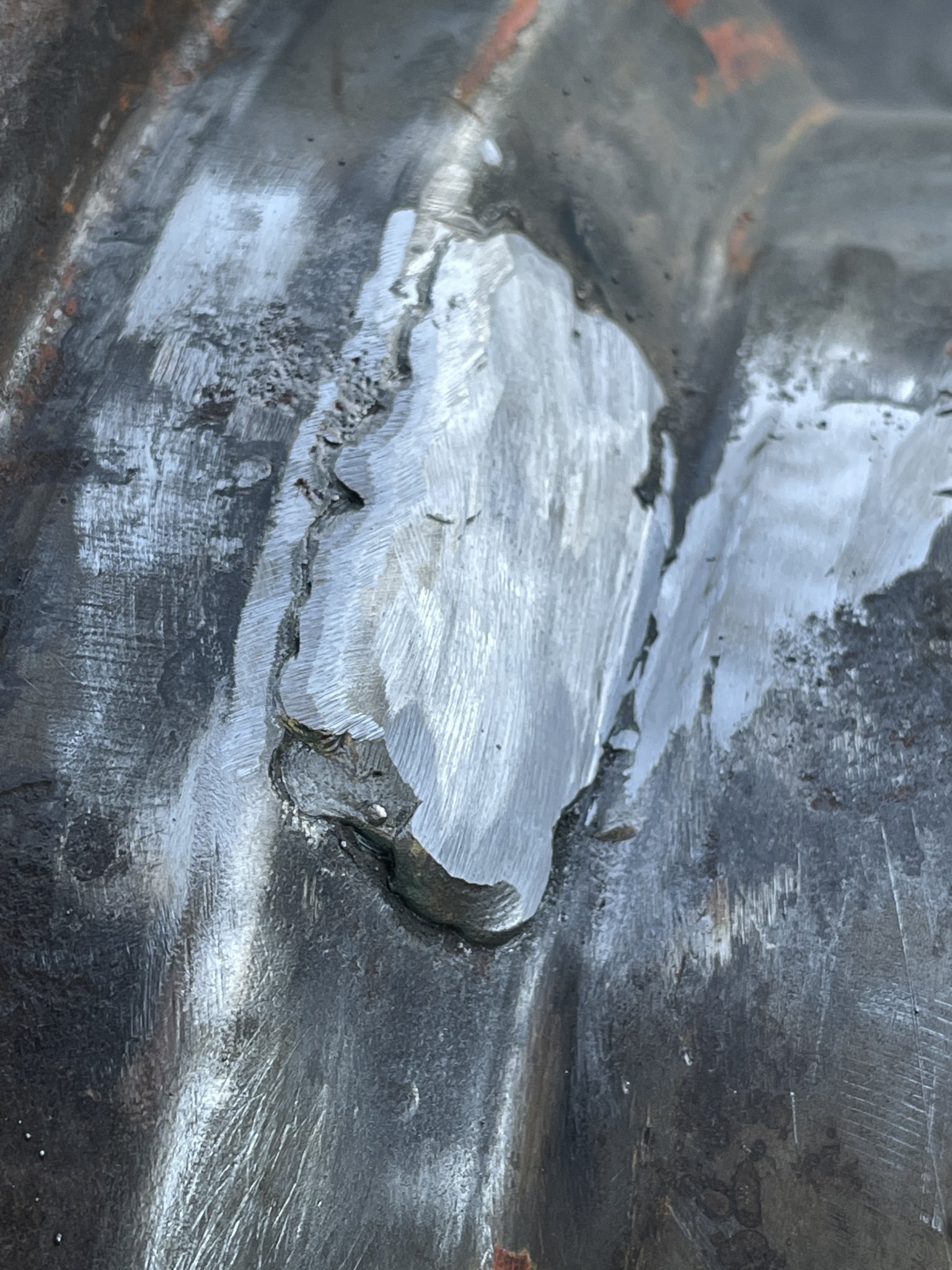

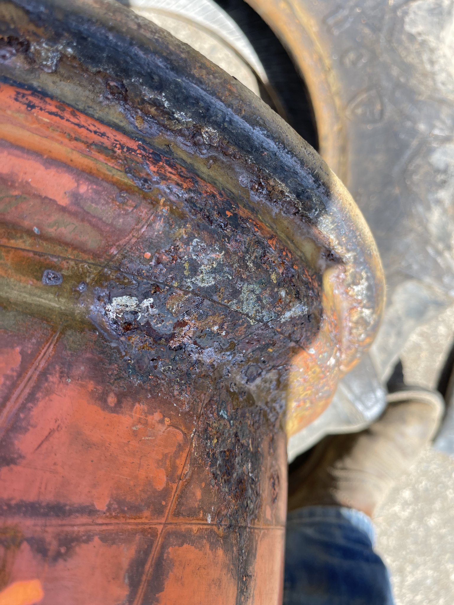

New tires came in today! I sure hope they only look tall/skinny because they’re new and not stretched on the rim yet lol.
wheels were in REALLY rough shape so I hit them with a wire wheel, and patched the valve stem hole to re-drill.Hit them with a rust converter, and tomorrow I will start painting them. Honestly, probably should have done electrolasis.
Im going to do a dry pressure test for a few days before filling the tires with WW fluid.

A bit of info in case you need to do another rim. We used 5/8 flat washers to repair valve stem holes. We also used to bronzed them in. Less heat on thin metal, plus we would put in extra bronze to smooth/fill in the corners and edges. When using the torch we would heat and bent the washer a bit to get it to conform to the shape of the rim a bit better.

Ouch on those wheels!
Me being lazy and a little odd, since I have access to brake lathes at the school i teach at, whenever I have ugly wheels I chuck them on a brake lathe and just hold an angle grinder with wire wheel against them as they're spinning to get the first ~80% of the junk off. I HAVE cut on a smaller front wheel on a brake lathe but i sure wouldn't do it on a 16".. too much rpm, toolholder won't go out that far etc etc. But, if you did something like body filler into that nasty surface (once clean), spinning the wheel while going at the bead area with something like a not-too-coarse flap disc should knock down the filler to the level of the metal without changing the metal itself noticeably. I've used real bead sealer, anaerobic gasket maker, and regular rubber cement as bead sealers before.
I've done a lot of electrolysis.. works great but i suspect you'll be left with a rough surface and more work left to do afterwards anyway. I think the real question is, should you just take the easy way out and put a tube in it?

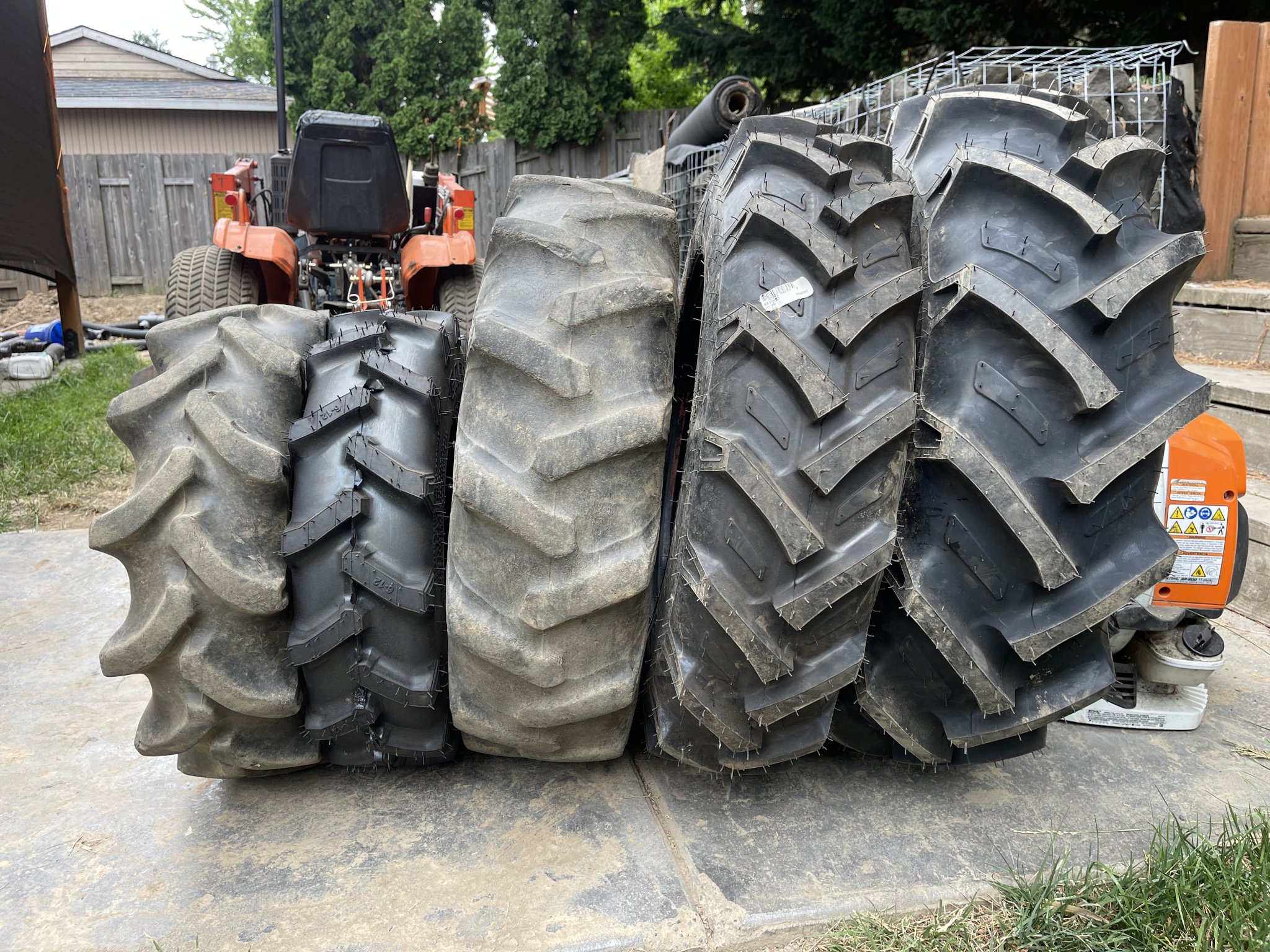

Ok, my Carlisle Farm Specialist 9.5-16's came in!
Part Number 6x17413
Pairing with the original 6-12's I ordered (570030)
In the red "test rear" block is the off-rim MEASURED circumfrerence around the center of the tire,
In the red "test front" block is the listed rolling circumference. (I measured it off rim and it was just over 69")
So using the listed RC for the front and the off-rim measured circumference for the rear should give me the largest distance possible, and it's still got a front lead to it. (albeit, slight).
Going to mount these tires up and get them on the tractor now that I've confirmed this. Will report back.

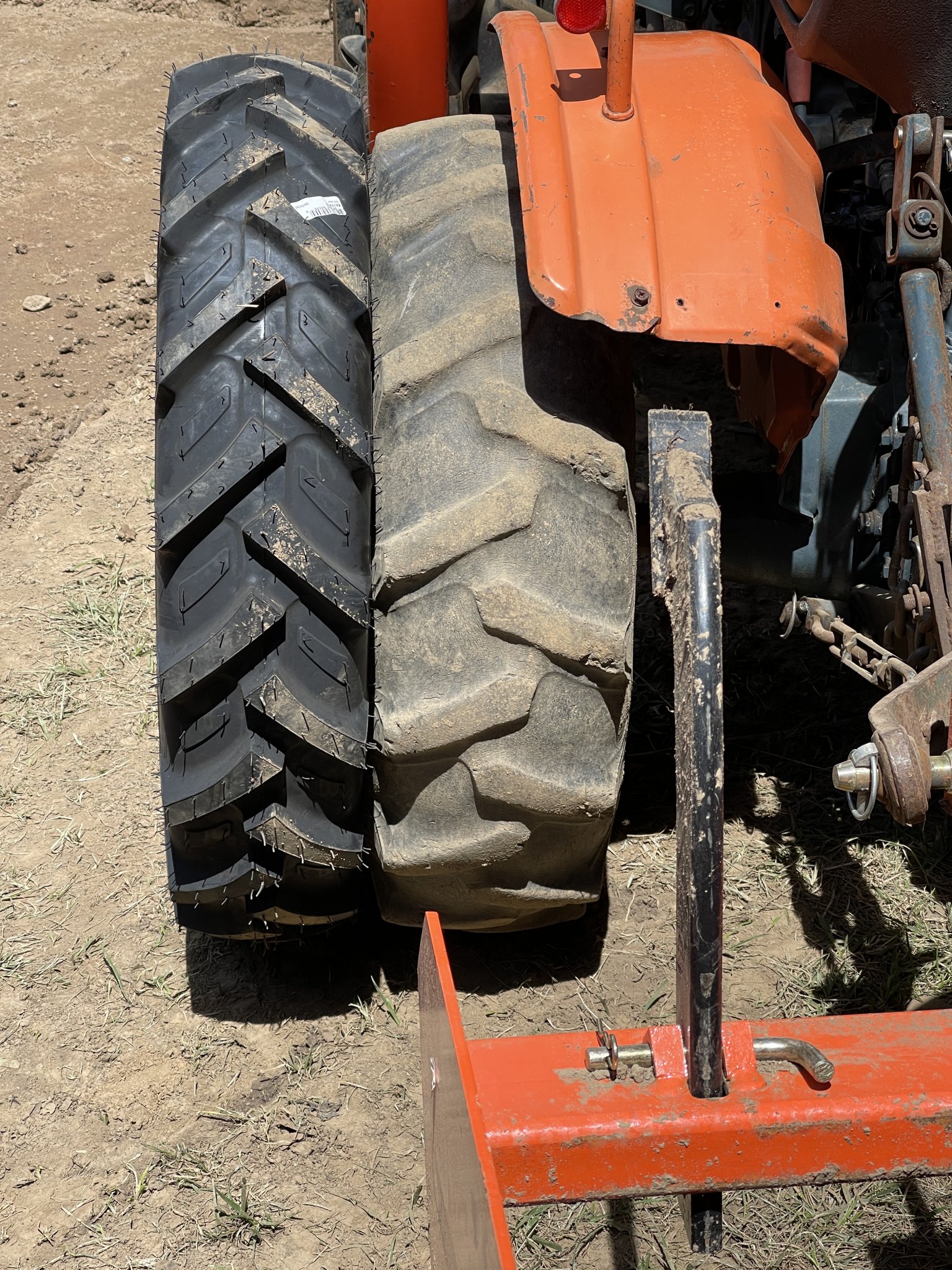

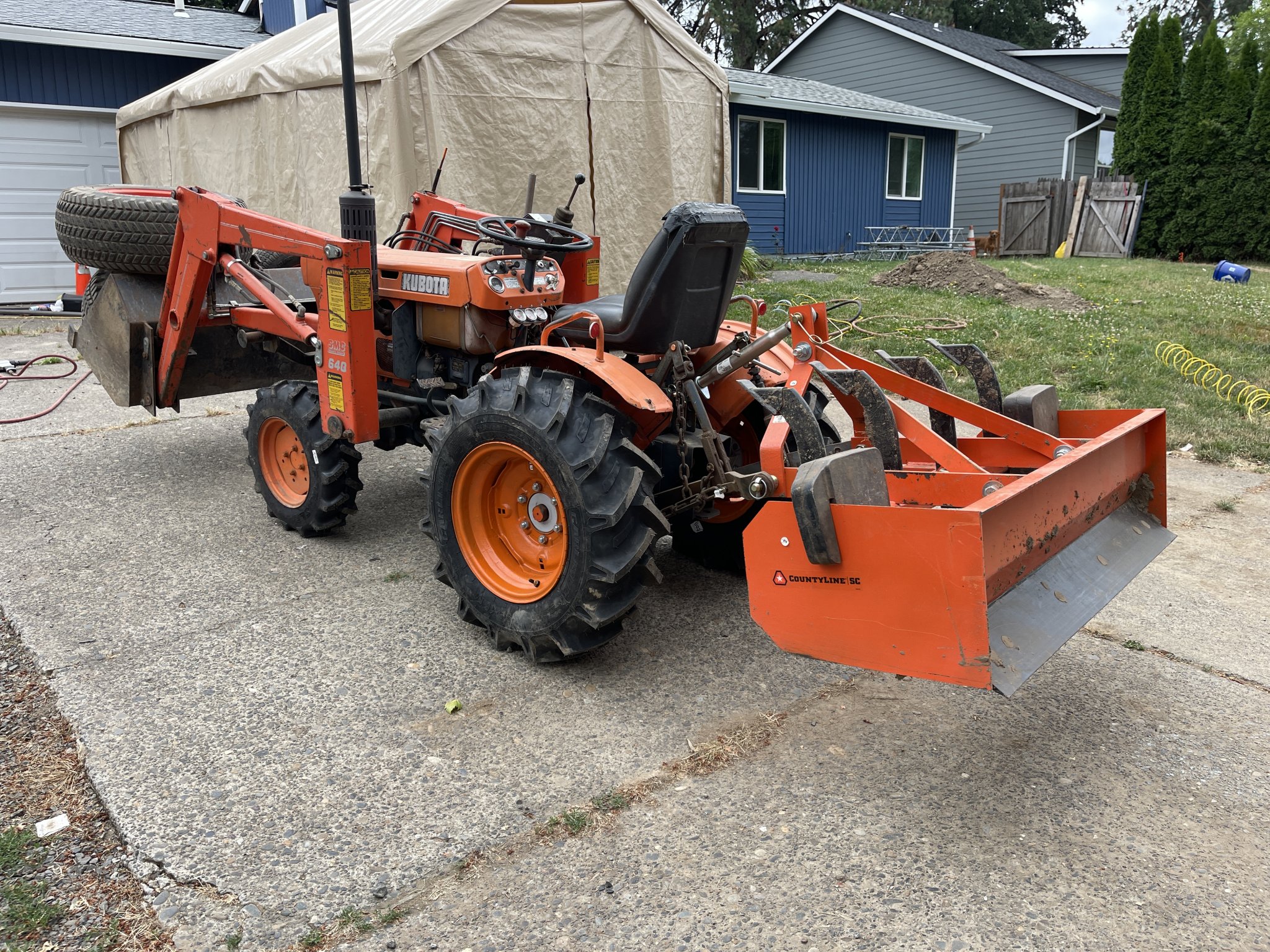

Well the 9.5-16 worked!!!! Just drove it up and down the street in 4x4 and no binding at all. Very easy to put it in and out of 4x4 at all times
LOOK AT THE TIRE DIFFERENCE! And the math worked out too, so I’m happy to see that it really did work.
6-12, 6-12, 8-16, 8-16, 9.5-16 on rim
